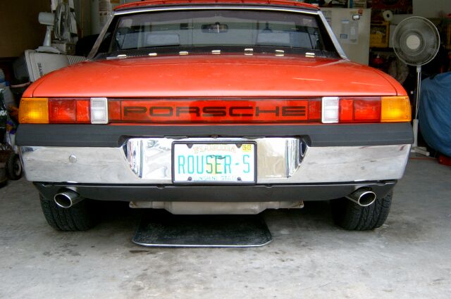

Rouser
post Jun 10 2004, 04:04 PM
Anti-Post Whore
Posts: 597
From: Citrus Park, Florida
Member No.: 54
I've got the Triad system. I like the sound and the looks.
Yep, me too. Swapped out a 4-tip Monza for it, and haven't looked back since.
You can't beat the sound, the look, and the construction. Mine was made by the late David Said; good man, and great workmanship.

QUOTE(Rouser @ Jun 10 2004, 02:04 PM)
I do like the balance look of the Triad system with the two tail pipes. That is one of the reasons I was looking at the Monza setup but I havn't heard anything good about it. What did you have to do to modify the rear valance for the tail pipe on the passanger side. (IMG:style_emoticons/default/cool.gif)
