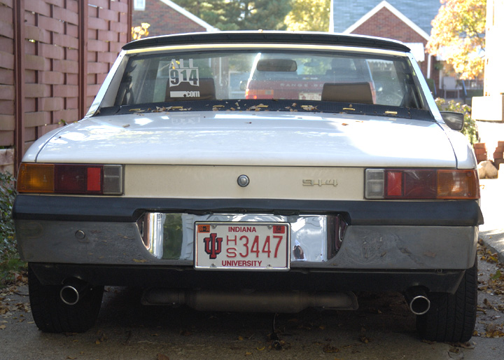

I say go for it, I love mine...what I'd really like is to JetHot coat it in a bright silver color. I gave up on my exahust tips, they were bolted on and just about came off on the track a couple months back, haha.
Rouser: What kind of tips are you using? Mine were/are 2.5"/3" in/out and were bolt on. Maybe I should just get a friend to weld them on.
BTW here's mine w/ the old tips and no valence:
seanery
Jun 11 2004, 11:04 AM
Nathan,
I trimmed my tips about 2 inches, then put the tips on, screwed a sheetmetal screw through them (2 on each) there's no way mine are coming off, even without the screws they are on very tight.

What did you have to do to modify the rear valance for the tail pipe on the passanger side.
Just make a cardboard pattern of the current notch, than copy it on the opposite side of the valence panel. Using a saber saw, carefully cut out anything that doesn't look like an exhaust notch and Presto!, dual notches.
I gutted the mounting hardware from a pair of APC muffler tips (similar to
157820; I don't have the actual part # with me). I slipped the ovals onto the ends (like a glove), drilled a hole from underneath, and tightly mounted them; they ain't comin' off.
Look fine ... lasts long time.
