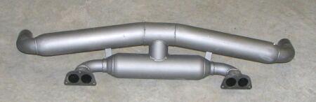

an other view of the Triad Exhaust.
Nice sound, nice construction, more HP due to large tubes increasing exhaust flow ....

If you've got a '76 and you're in California, last time I checked Antioch was still in Ca, you're screwed as far as any mods and being smog legal. You need to have a cat and an egr pipe attached and functioning. None of the aftermarket exhausts I have seen work right for 75-76 smogged 914.
That picture of the triad exhaust scares me. How can they tell you you'll get more flow when all the gasses have to pass through that one small pipe in the middle? Anyone seen any actual dyno sheets on any of these exhausts you're recommending? With the exception of a header system, ie no heat exchangers, the best set up is the stock 2.0 muffler. A few years ago we did a bunch of dyno runs with the big aftermarket mufflers and they all fell short of the stock ones. Then we cut a 2.0 one open and gutted it like the 911 sport mufflers and got I think 1-2 more hp. That's it.
However none of this even applied to the 75-75 generation cars because the heat exchangers are completely different and they make the exhaust do an unnecessary 180 degree turn right after the head.

The Triad looks very nice. I like the dual outlets.
My personal preference is all factory. From everything I've seen it's pretty hard to beat. The 2.0 "hotdog" or "banana" muffler is basically the same as the venerable 911 muffler, which is pretty darn good from a performance aspect.
The Monza shin cutters are pretty loud and heavy.
From my experience, louder feels more powerful and usually isn't.
I would like to see a dyno comparison of:
Stock H/E's and stock muffler
SSI's with stock muffler
And then each of the aftermarkets with both stock H/E's and SSI's, Bursch, Triad, Monza, and then Kerry Hunter and Racer Chris' set up (which looks very nice).
