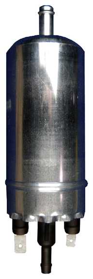

> Anyone worked with this Fuel Pump?, Bosch in-line electric, $31 at NAPA.
Prospectfarms
post Jun 15 2011, 10:33 PM
Posts: 495
Joined: 7-March 11
From: Louisville, KY
Member No.: 12,801
This thing is so cheap its probably is supposed to sit inside a gas tank, but I can't see how. It's rated for almost 90 liters an hour at 45 PSI. No amperage rating but its about the same size as the OEM. Threaded +/- terminals. Intake nipple = 12 mm, pressure side = 7mm.
Helped me determine that my original three nipple Bosch pump was bad. I routed the cars fuel pump return line into the tank return line and hooked her up. Works fine right now, had to turn down the pressure regulator and it pumps up fast. No check valve that I know of but it holds more residual pressure than my old pump.

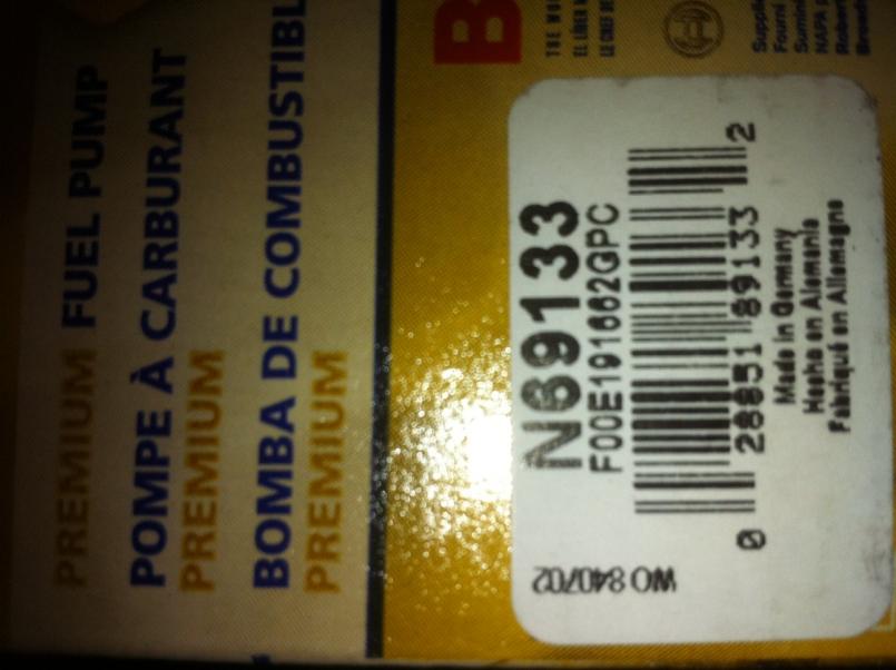

Fuel Pump - (Electric In-Line Type) - Actual MFG OEM
Part Number: BSH N69133
Product Line: Bosch
Fuel Pump Fitting Size[s] : Electric Fuel Pump
Fuel Pump Gallons Per Hour : 22.45
Fuel Pump Pressure Rating : 45 PSI
Features and Benefits:
This Pump is the Original Equipment Fuel Pump. This Pump Will Provide You and Your Customer Confidence that it Will Perform Exactly Like the Original Equipment Fuel Pump because That is What it is.
