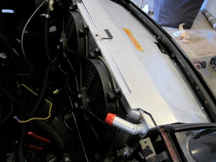

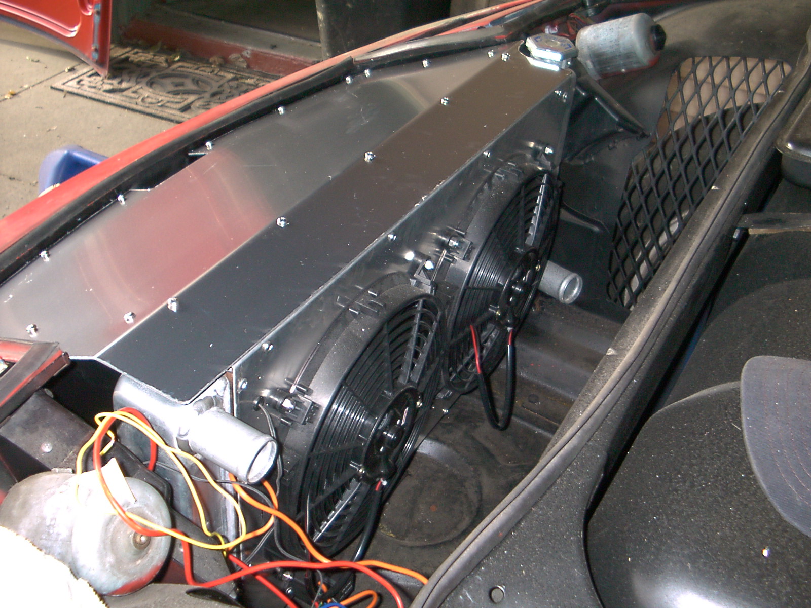

I purchased a radiator ($150)and fans ($40) similar to these on Ebay.
I have more pictures of how I mounted everything if you'd like.
http://cgi.ebay.com/ebaymotors/NEW-ALUMINU...1#ht_4173wt_951
http://cgi.ebay.com/ebaymotors/2-x-Univers...#ht_6353wt_1139

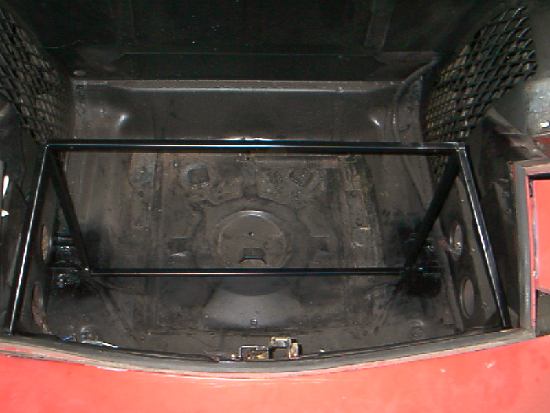

This set up is more in line with my budget. More pics would be great. Does your set up keep things cool? It looks like you mounted it pretty much vertical.
joefri187
post Jun 21 2011, 02:55 PM
Posts: 29
Joined: 1-November 05
From: Concord, CA
Member No.: 5,047

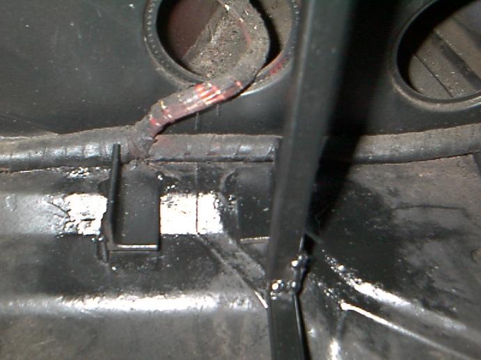

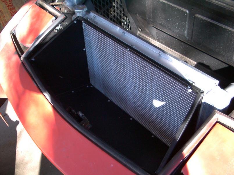

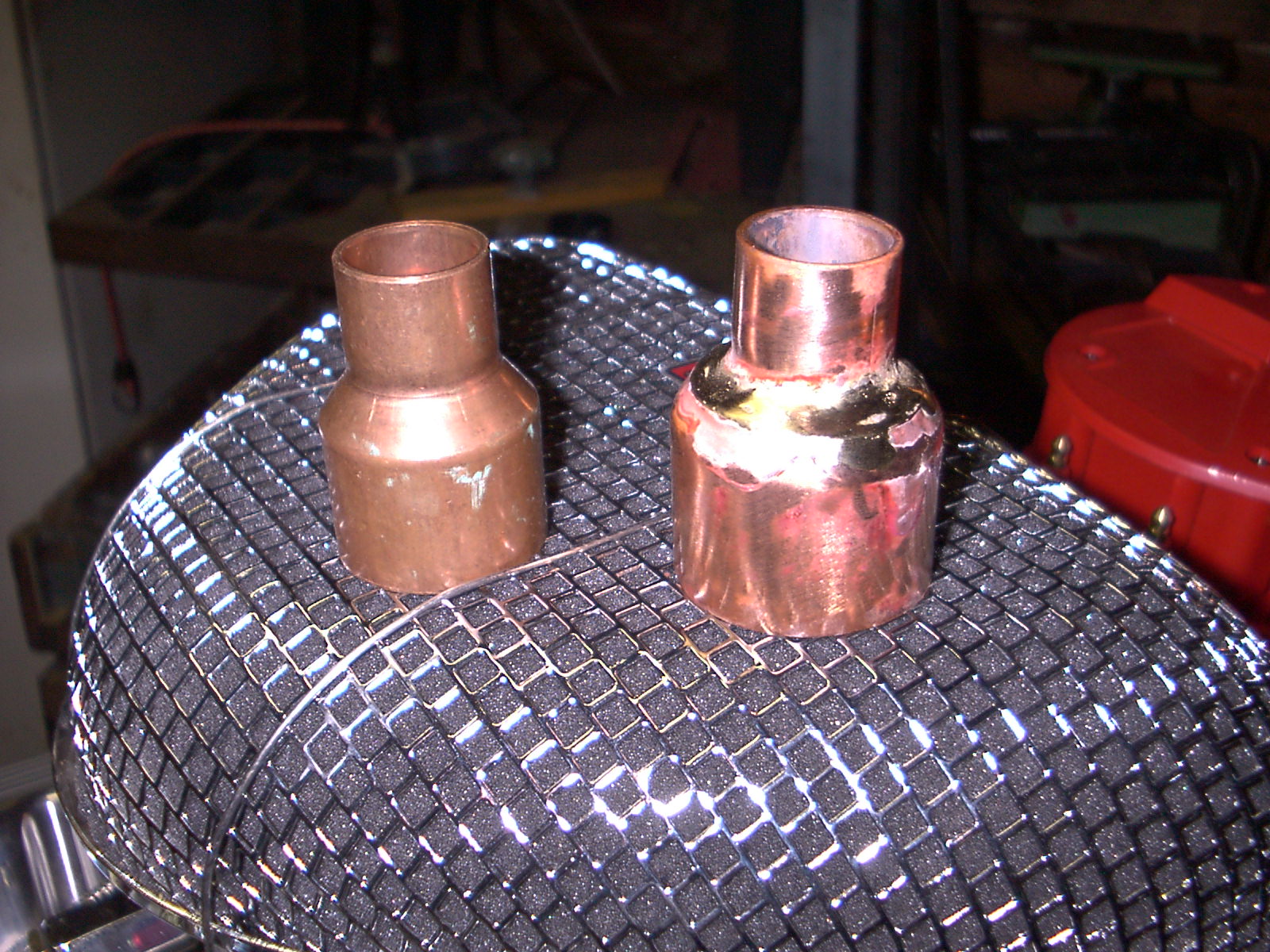

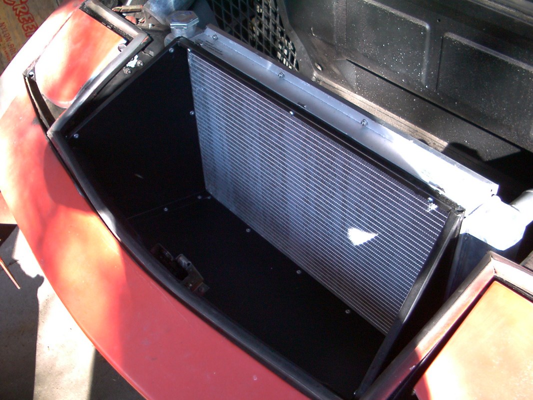

Here are a couple more pics...
The radiator is floating, not bolted directly to the frame as I've heard that bolting directly to the frame can cause the radiator to crack as there is a lot of expansion when hot...
It sits on rubber mounts on the bottom and bolted on through rubber grommets along the top edge.
And yes, it works great and everything stays cool!!!

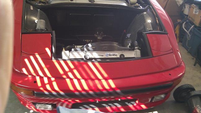

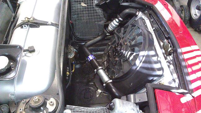

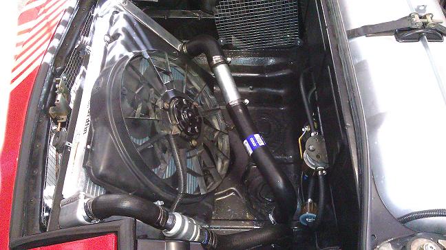

In my setup I went with a Giffin radiator, model 125241-H... no radiator cap. The dimensions are 16"x 27.5" x 3". It's installed to float in its mounts versus mounted rigidly.
I also used one of the most powerful fans ever put in a production vehicle (Google it)... an early to mid-ninties Ford Taurus/Sable fan. I think the only one more powerful (and larger) is out of a Mark VIII. Local junk yard for $20.00. Note that fan shroud covers about 90% of radiator surface... perfect! Then of course, you need to get the controller, mine is an adjustable unit.
So far so good!! (IMG:style_emoticons/default/biggrin.gif)

This is a nice clean set up and I would be inclined to go with 1 fan rather then two as long as it keeps things cool. So you have a remote filler for the radiator? Also, those look like 2-3" hoses going through the floor. Are you running hoses that large of a diameter under the car?

Thanks for the pics. Nice frame. I might go this route and make one out of aluminum square tube. Great idea to have it floating on rubber mounts. And I like this radiator. Is there plenty of room for the filler? When you purchase fans as you suggested do they come with some sort of controller? How is it wired? Thanks

You wire them yourself, Typically on a switch or on a controller that is connected with the water temp sender (aka it activates at a certain temp). For getting around town you could just put it on a toggle switch and turn it on when it reaches temp (thats what I do).
Also he is probably running the standard size hoses under the car, the big hoses at the radiator are because they are preformed to be able to make the angles required in the confined space, then you would run a reducer.
The fill for the radiator will be in the engine compartment, This is because the radiator is lower than the engine and the fill needs to be the highest point to allow the air not to get trapped in the system. Best to run something inline that has a long neck or something so that you have room for air. See the modern radiator fills, they have a big box that has a level on it, water flows through that box in line and because there is a bunch of extra water in it it never gets air in the lines and it constantly is purging air.
