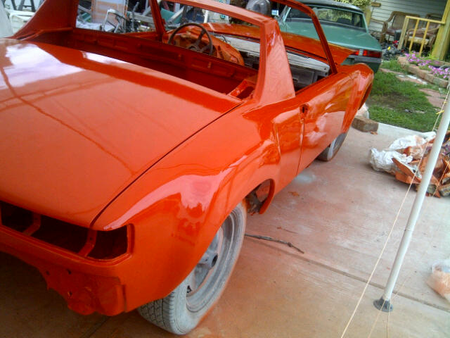

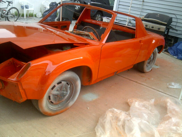

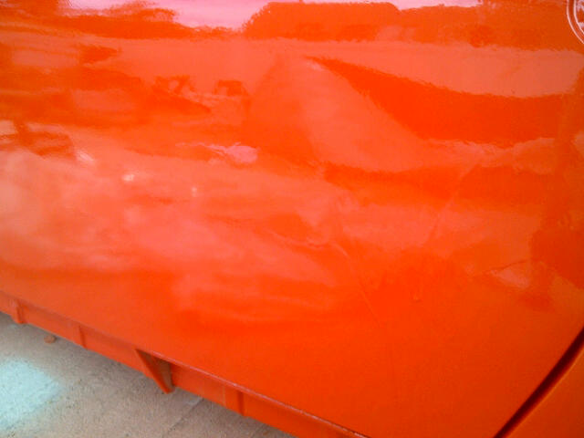

The driver's side door is the one that had most of the drips, I mean bad. I hope wet sand and buffing will do it. The first picture shows the bad door. The bugs also did a number on me, but mustly on the last coat. I gave a total of 5 coats.

Scotty, Andy, What kind of buffer solution do you advise.
Scotty, you mean I can buff it right after the wet sand,( 24-48 hrs) or do I wait a few days.

post Aug 13 2011, 09:22 AM
Post #108
Spooling.... Please wait
Posts: 13,381
Joined: 20-January 03
From: Riverbank, Ca
Member No.: 172
Scotty/ Paul,
The paint takes longer to harden than other paint. Mine was still very soft after a week. The drips I mean.
Those drips are very thick, you have a couple of options, but using 1500 grit IMHO will take forever to take it out. I used 600 grit very carefully on the drip only. Only because I had more runs than you did. Start with 1k grit, then 1500, then 2k.
Buy this from harbor freight.
http://www.harborfreight.com/7-inch-variab...nder-92623.html
They typically have this on sale for 30. Keep your receipt. Return it when your done and buy another one on sale when it goes on sale because this really is a good buffer.
http://www.harborfreight.com/5-piece-7-inc...-set-94323.html
Buy this for the backing pad.
http://www.harborfreight.com/9-inch-foam-b...-pad-91235.html
This is for buffing.
http://www.harborfreight.com/9-inch-black-...-pad-91236.html

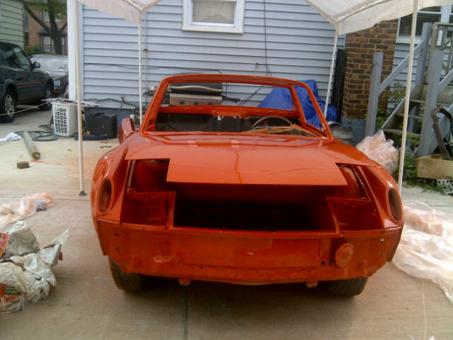

Thanks. Couldn't do it that easy without you. Boot is a $99 car port from pepboy then I used platic to cover the sides.

I west sand and buff single stage within 24 hours. The longer it sits, the harder it gets, thus the harder it is to sand and buff. Yes you need to be careful, but 24 hours is plenty of time for the paint to setup. This one was done within 24 hours, and was cheap single stage, ( PPG shopline ) the equivalent of Nason.

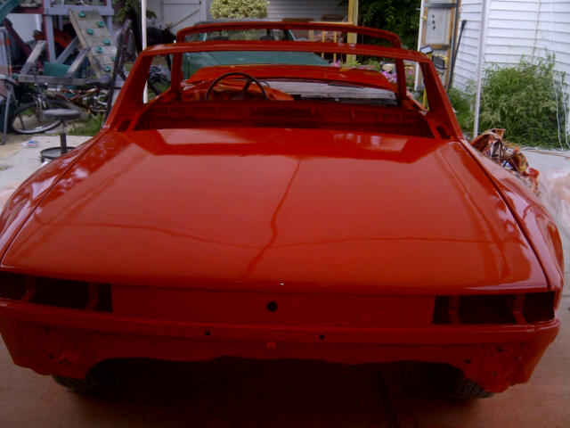

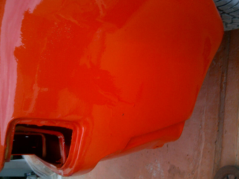

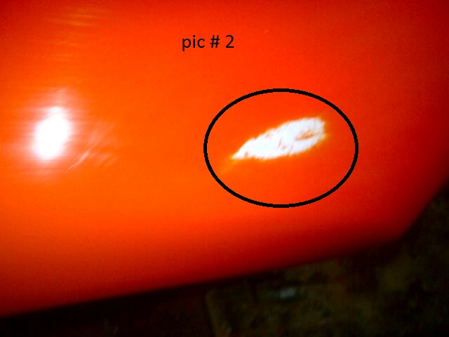

I think I f$%*cked up, (IMG:style_emoticons/default/sheeplove.gif) the paint is completely dry. I decided to wet sand, and noticed that I have more drips than I assumed, and they are bad. picture # 2 shows what happened as i try to sand one down with 1500 grit. You are looking at the primer.

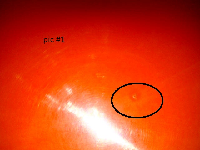

I also have a lot of those small spots all over the hood due to bugs shown on pic #1.
What is my option?
1, do I sand all the drips and repaint?
2, do I need to prime again when sanded
3, is it safe now to sand over the fresh paint? any reactions wait time etc..
4, as far as the dots on pic #1, will the compound take them out?
experts weight in please..

Try putting the sandpaper on a mixing stick and being careful to only touch the run. This is what I did, then I went over it with the block after I got it to the level of the rest of the paint and just hit it rally light.
Also realize that the paint above a run will be much thinner than paint on the run.
Also to answer questions
1. Sand all the drips, repaint if your through. You can spot repaint the area, or repaint the whole pannel. You probably used 1/2 a gallon? You have plenty to respray those area's or even the whole car.
2. No you dont have to re-primer.
3. You should be fine as long as the paint is 100% hard. I would wait till friday or so, leaving the paint in the sun the whole week then wet sanding it down to say 320 (you can wet sand now that you have the metalwork sealed with a sealing primer).

Oh and the bugs, you probably wont get all the bug out of the paint but you can get most of it. Thats just a downside of a DIY paint job. I have probably 3 bugs/legs/dots in my paint that are obvious to me, but to everyone else it just looks like a piece of dirt thats on the paint.
