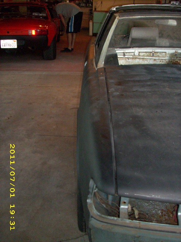

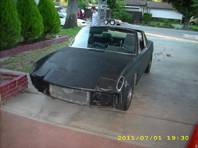

Peter's (malaga_red75) awesome subaru conversion is now in for paint! This thread will be very similar to my thread in layout and I will go into detail about how and when everything takes place (IMG:style_emoticons/default/smile.gif). Peter will be helping me as much as he can as we are trying to work towards a 2 month deadline.
Here is his really nice conversion! I must say the radiator setup looks awesome!
http://www.914world.com/bbs2/index.php?showtopic=85845

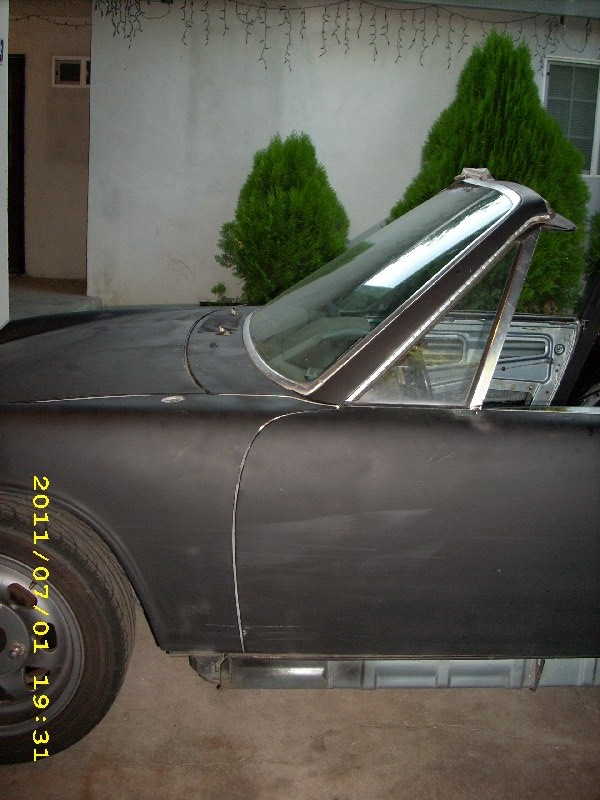

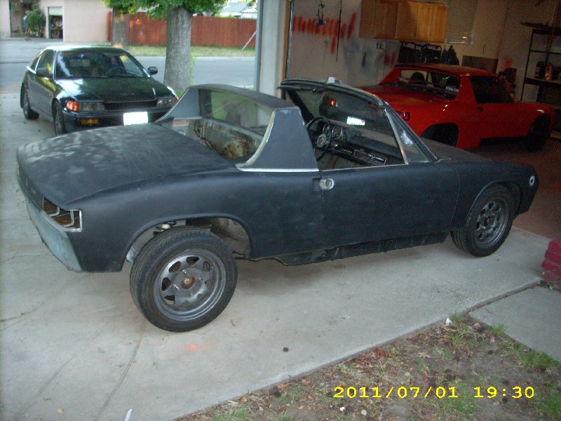

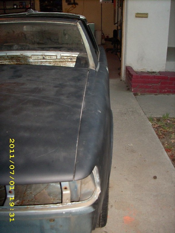

Here it is as delivered.

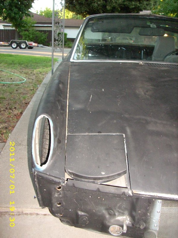

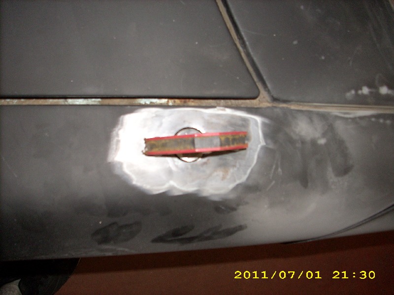

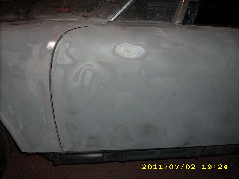

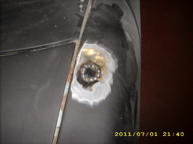

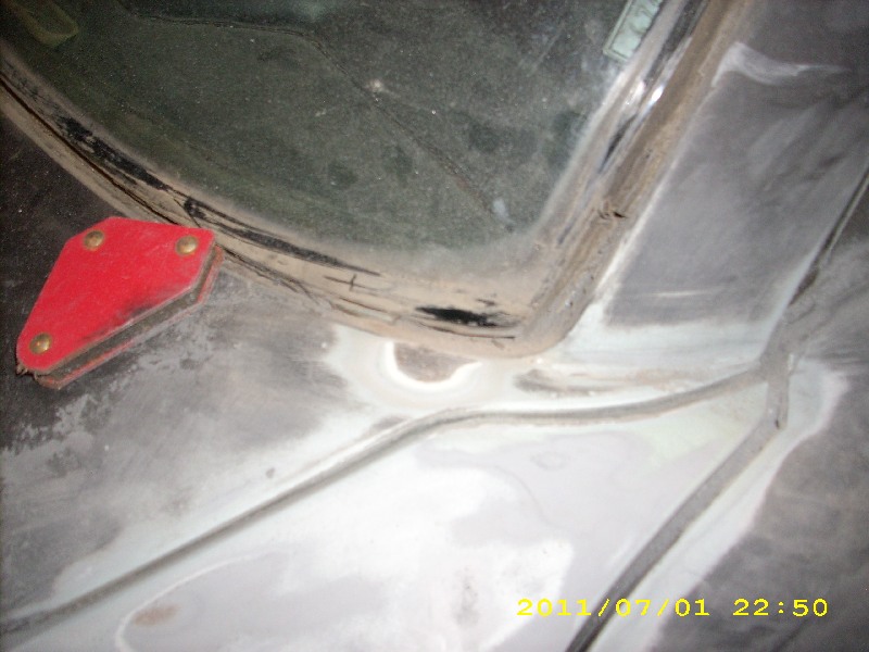

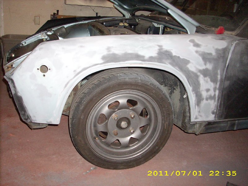

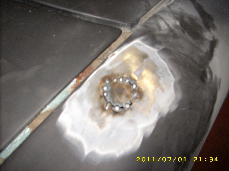

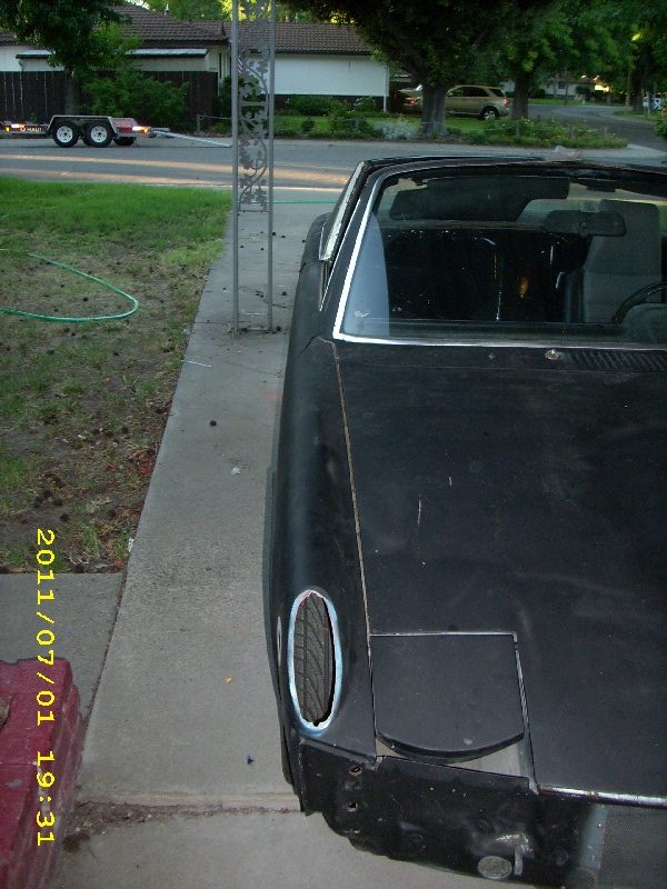

When Peter left I decided to get working on it to see what I had to work with. Started @ 8:30pm, finished @ 11:30am. 3 total hours

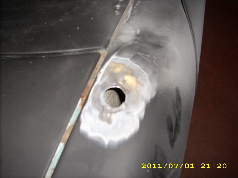

Not pictured, but I removed the trim along the front window. Then I filled the antenna hole

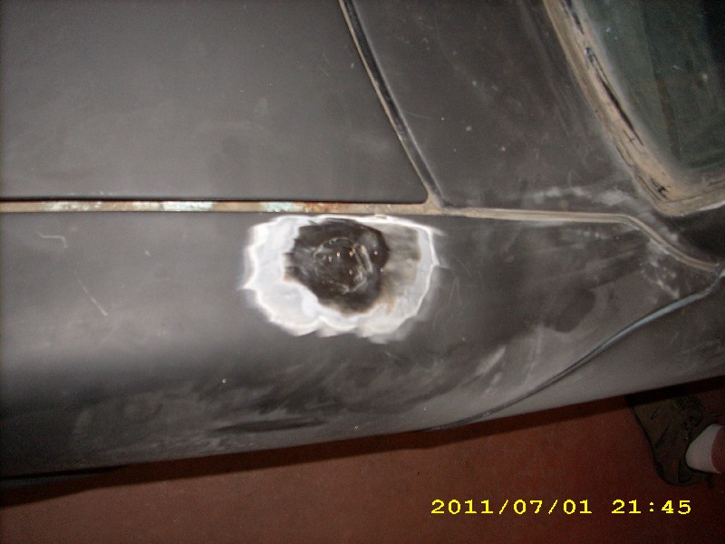

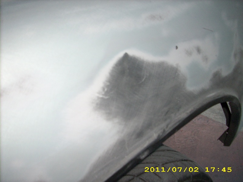

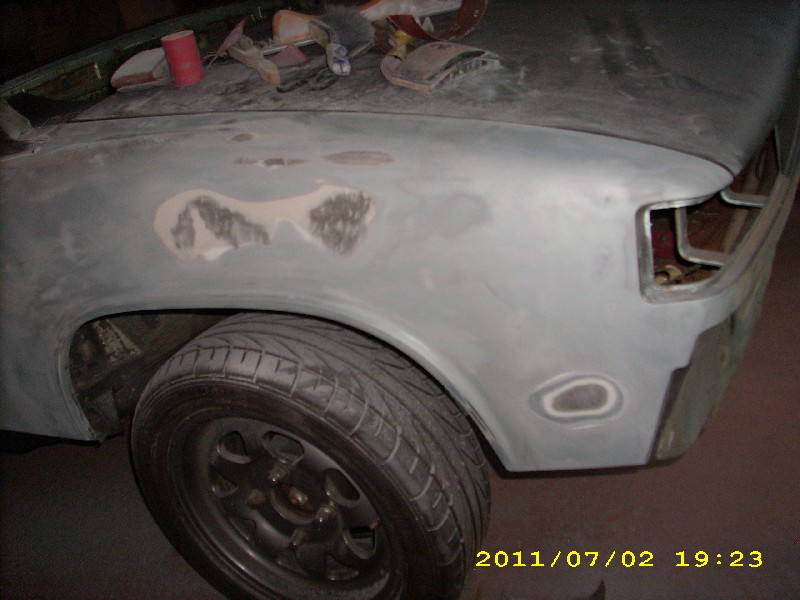

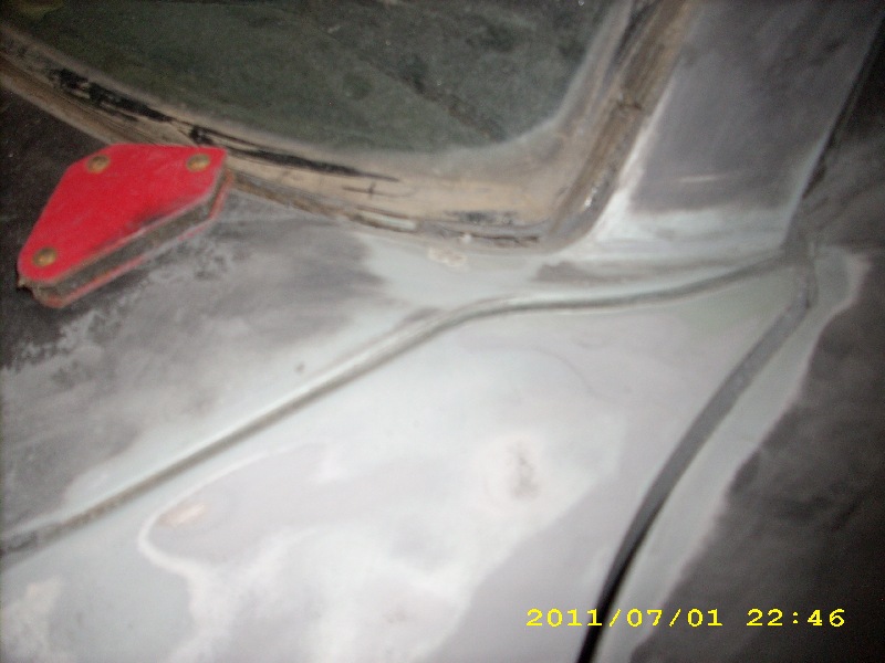

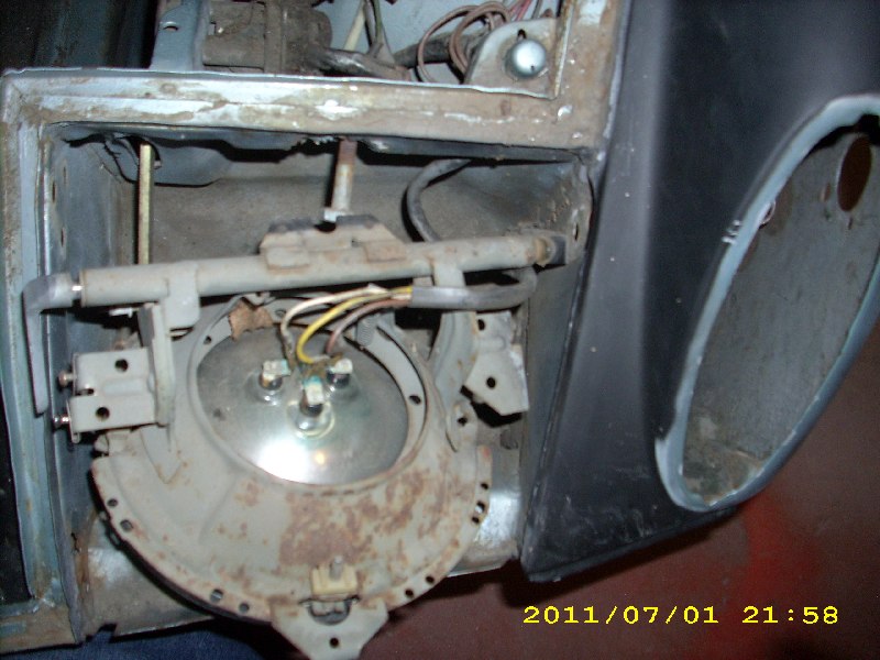

As I was grinding the hole down, I could see that there had been some repair to this area before where someone had gone to metal with the car and used a skim layer of filler over the car. It looks like good work, and in fact there is only that layer of filler, then a basecoat/clearcoat, then in some area's primer over that (probably from dents as I can see in Peters subaru swap thread), and then obviously the rattle can primer.

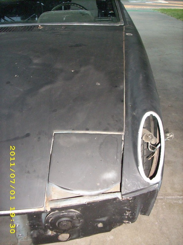

Removed the headlight as well, Picture is for refference on wiring.
There is a little bump on the edge of the door, I cant get behind it with a dolly, so this will probably have to be fixed with the door off the car.

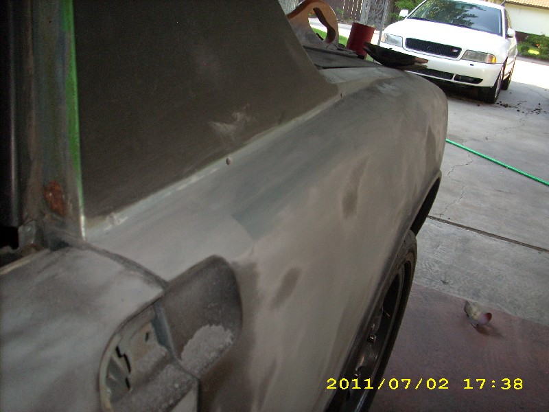

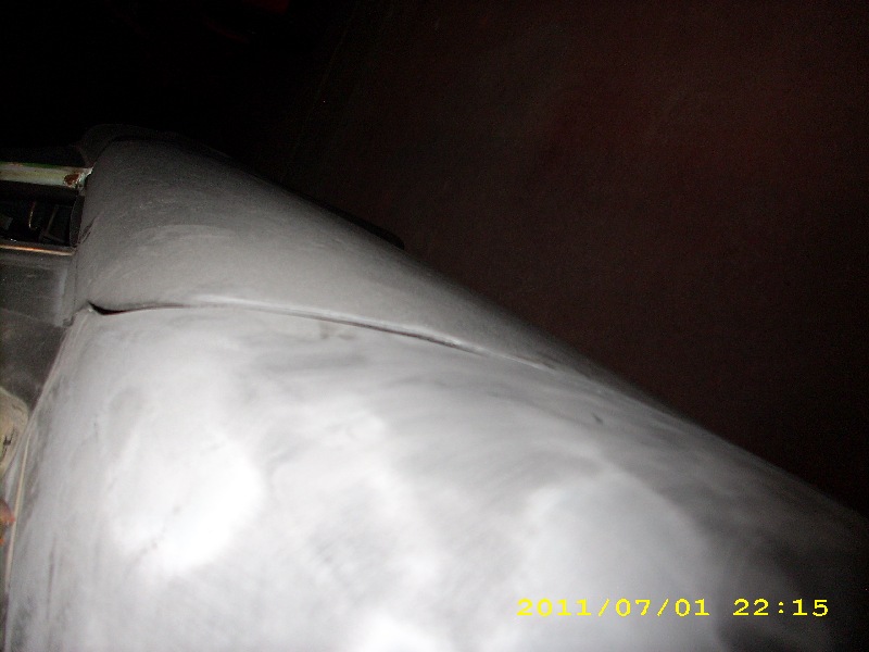

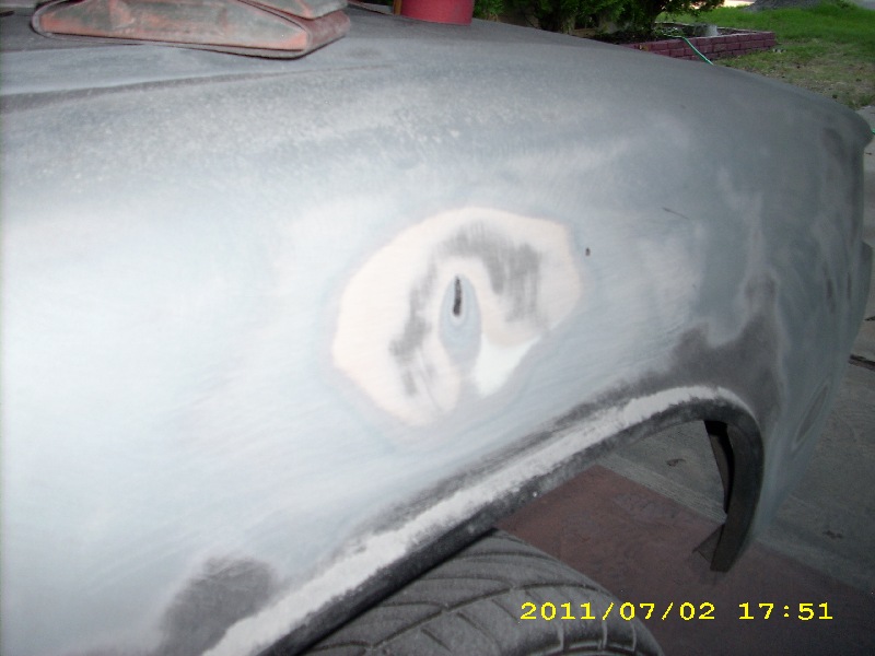

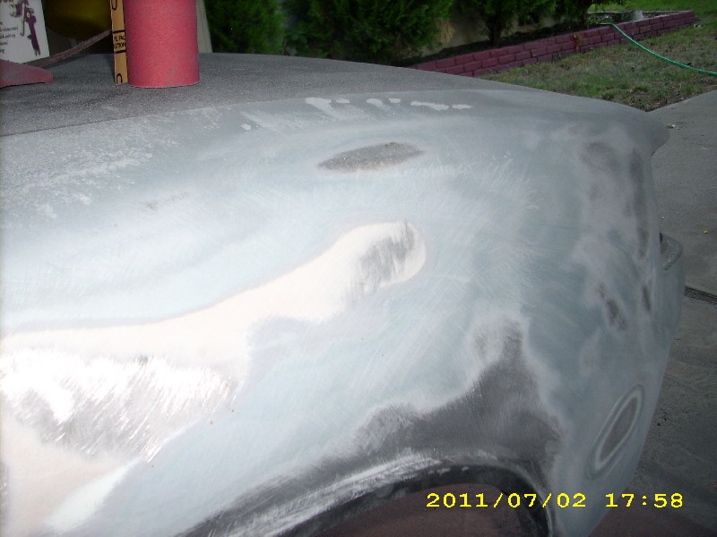

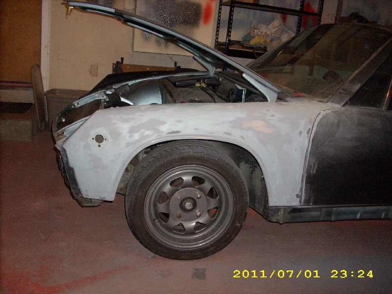

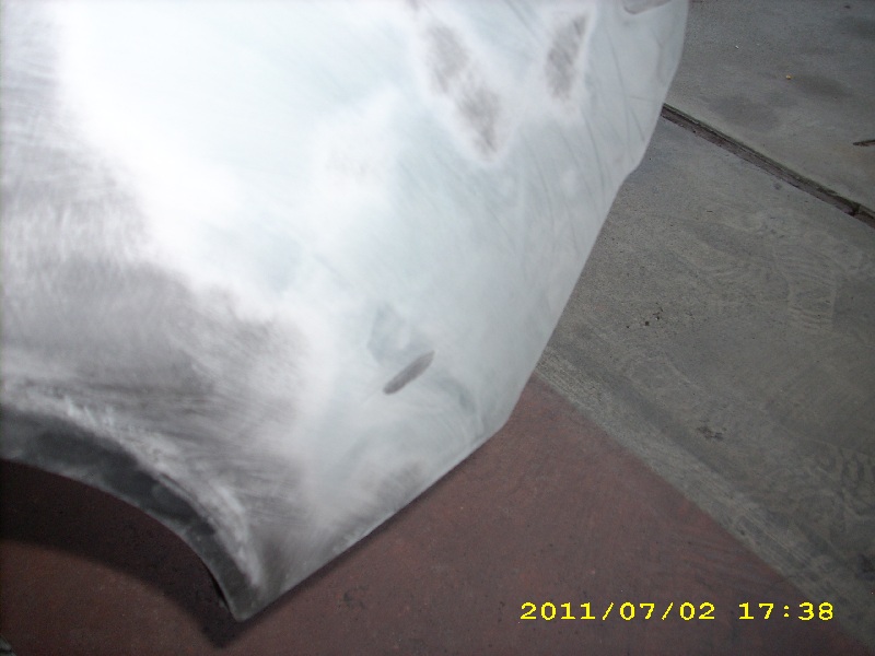

And then it had only been just over an hour so I spent some time getting the fender down. I used 180 grit, and on some area's where there was either chips or rust bubbles I went down to 80 grit. These will either get glazing filler or primer filler.
This fender is now ready for primer epoxy, It doesnt look like it needs any filler or even primer filler, So it'll be a thick layer of primer epoxy then we'll shoot primer sealer near bodycolor right before spraying color.
The whole car seems pretty straight except for the pass rear, which has an oilcanning issue in the front large section of it. I'll probably have to get the torch out for it and read up on the tricks to get rid of it. I'll detail this problem area later.

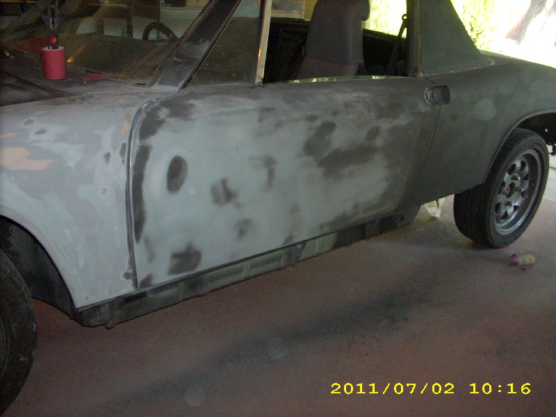

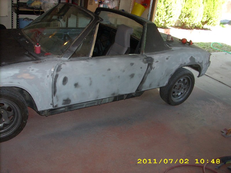

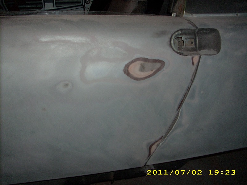

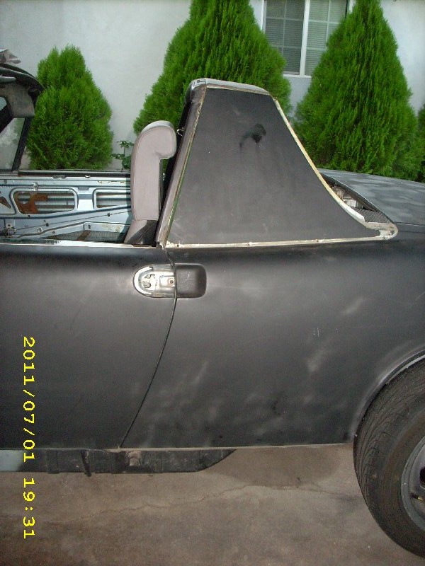

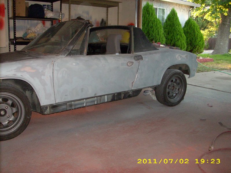

Not as good of a day as I had hoped in terms of time frame, but I did get enough done for me to be happy with the day. I had a 4 hour detour in the middle of the day delivering some wheels. That and I had expeced my fiance to return home sooner than she is (and she didnt keep me informed), so I stopped earlier than I really wanted.
Lets start with the morning push.
Worked on the door and rear fender for about an hour then had to leave.
Started up again and worked for about 2 hours then I got hungry (IMG:style_emoticons/default/smile.gif)

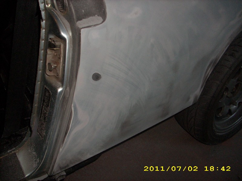

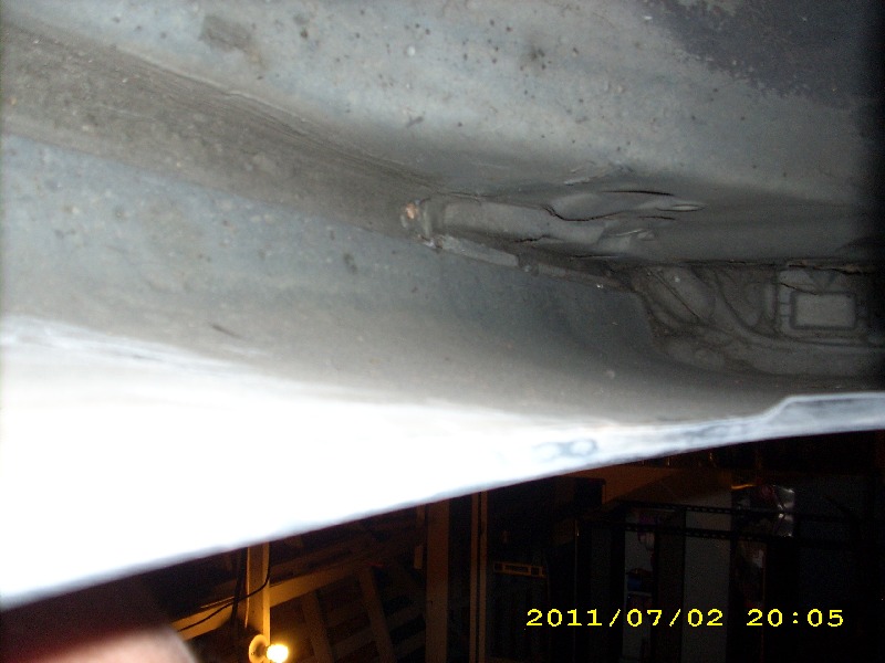

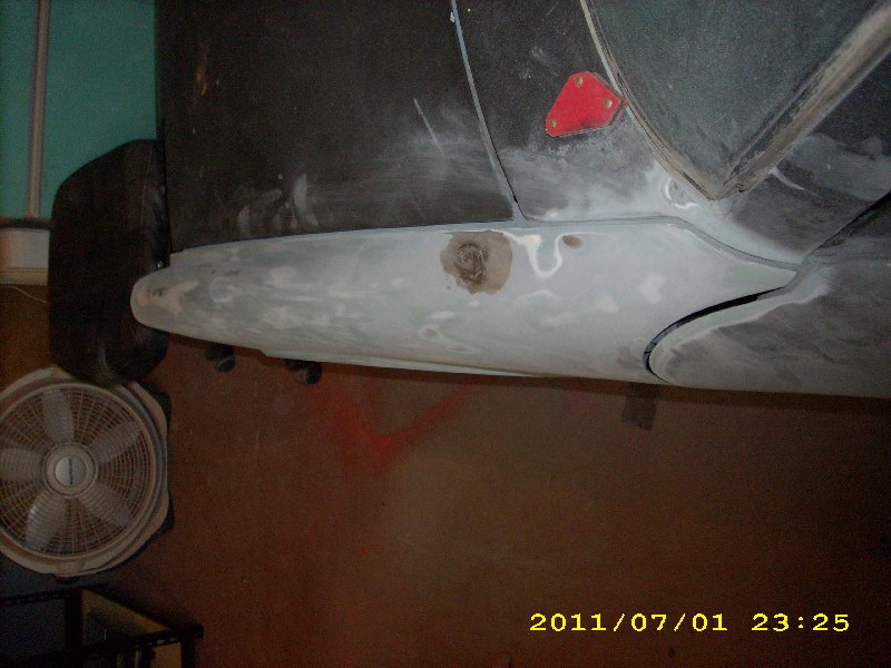

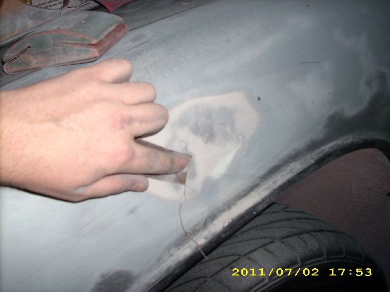

A LOT more nicks than I thought there would be, a couple of scratches, ect. Scratches, dings, and chips were brought down to metal or to the end of the chip/scratch with 80 grit, then the area's around were feathered.
Next step is epoxy primer, and then i'll fill the low spots.
Here is a pic of the rear fender lip that was trimmed.

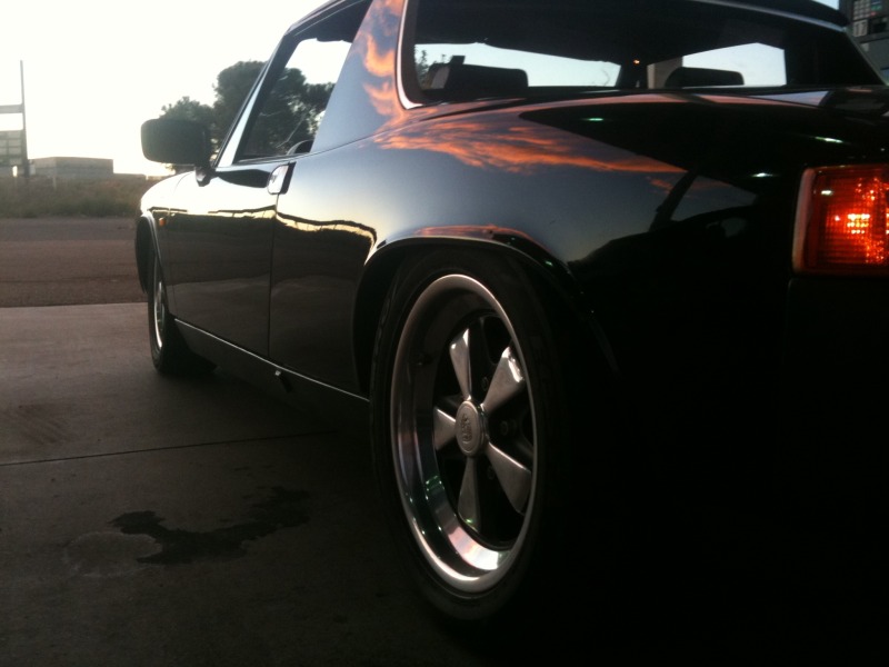

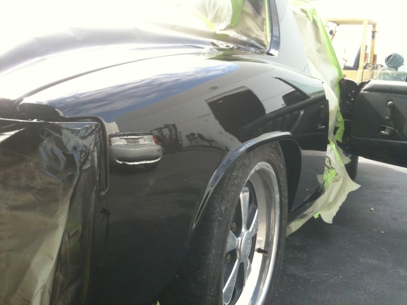

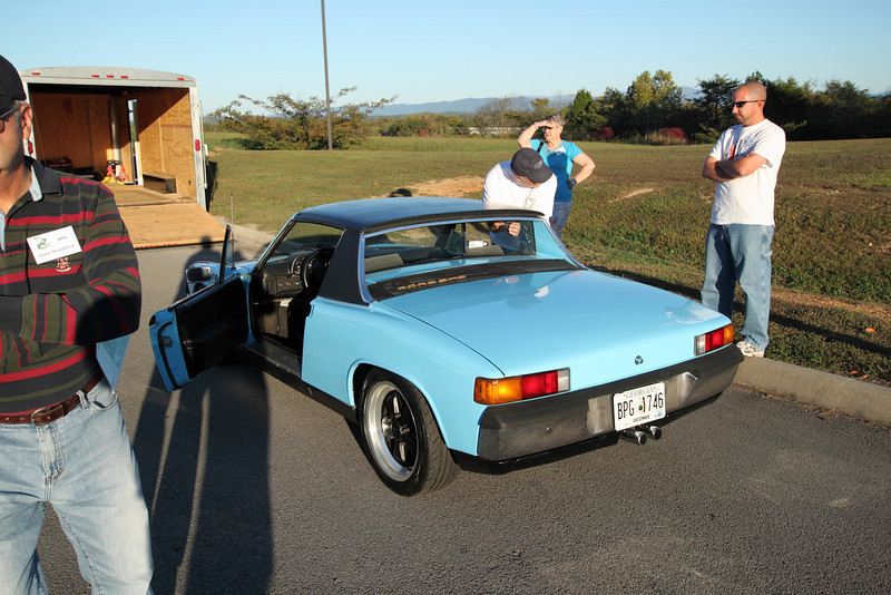

Peter,
Attached are some pictures of the 3.6 with rolled fenders. It's slightly widened and you can definitely fit more tire in there, while still maintaining a very stock look. you can only tell it's been widened if your pretty familiar with the car and look closely. This specific car was done using the 'baseball bat' method.
Thanks! I didn't notice it in the first two pictures, but in the third one, it looks like there is a crease or flat spot on the upper part of the fender? Is this just the sun/picture playing tricks on my eyes? Because this is something that Andrew talked about.
Thanks again! That car looks great!

I think that's just a 'bad reflection' because it's the same side pictured in picture #2, but I see what you are talking about, it certainly does look like it in that picture.
I would really recommend the whole process! (IMG:style_emoticons/default/first.gif)
