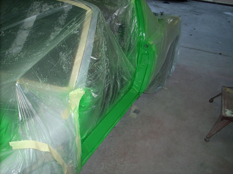

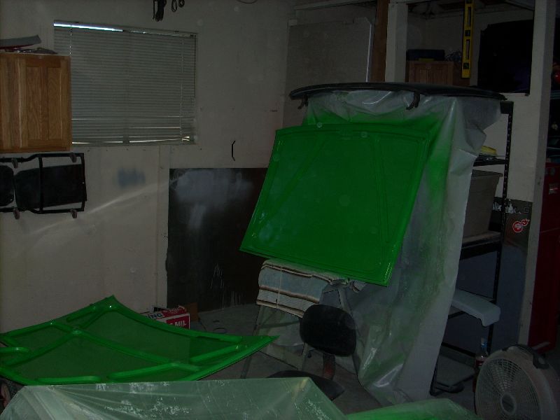

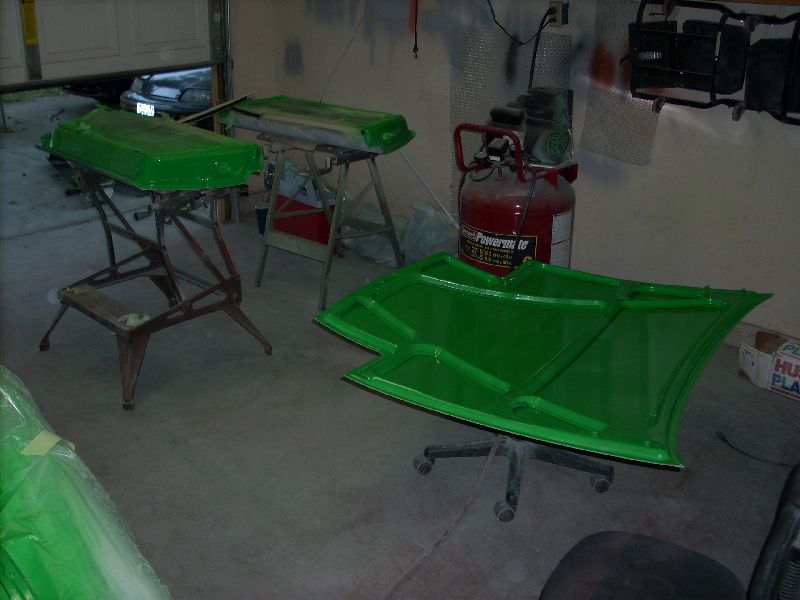

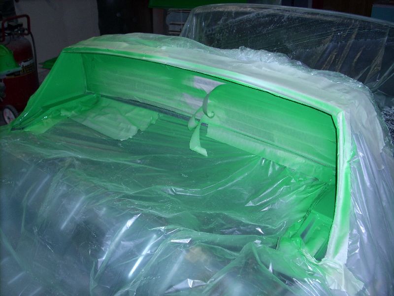

8 hours in today.
Car is block sanded and 99% ready for paint. We have to clean the gutters out to make sure no crap flied up while spraying like what happened in my car . (IMG:style_emoticons/default/dry.gif)
Sprayed under the trunks and engine lid, the jams, and under the targa bar.
The targa bar was a PITA and some of it came out dry. I'll be respraying this this week with my touch up gun.
Rest of it came out clean. Really wish I did the jambs for my car (IMG:style_emoticons/default/smile.gif)
The color is amazing and is the correct color no doubt.
However getting the 914's both in the garage was a little bit of a task... But I managed.
