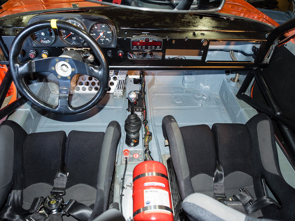

Also got the bulk of the install done for the Racepak G2X GPS data acq system/dash. Just have to zip-tie and tidy things up tomorrow.

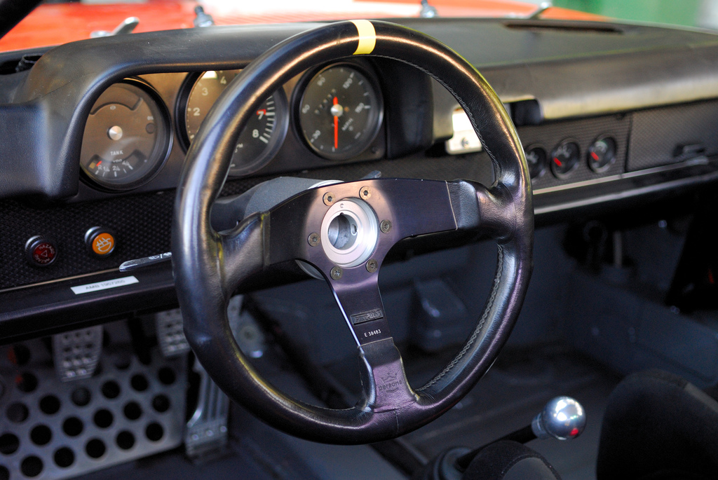

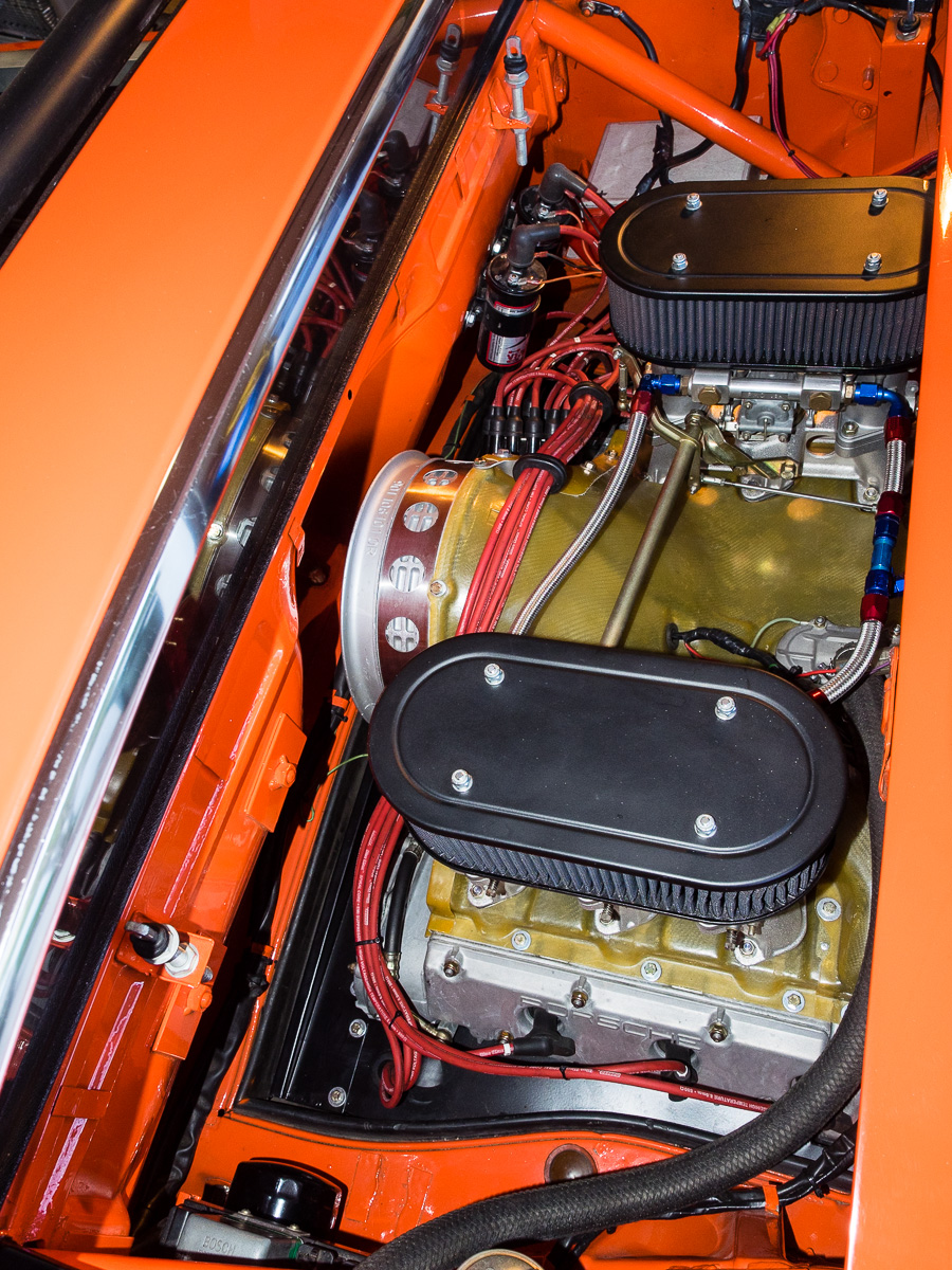

Here are some fresh pics. I'm still working on the dash - the black paint is still a little wet in the shot. It's satin not glossy. At least some of it will be covered-up later.
I got the G2X GPS data acq box, antenna and display mostly done this weekend.

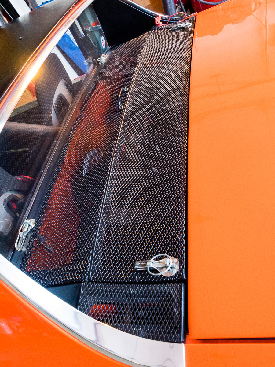

Gutted, removable GT-style lid.

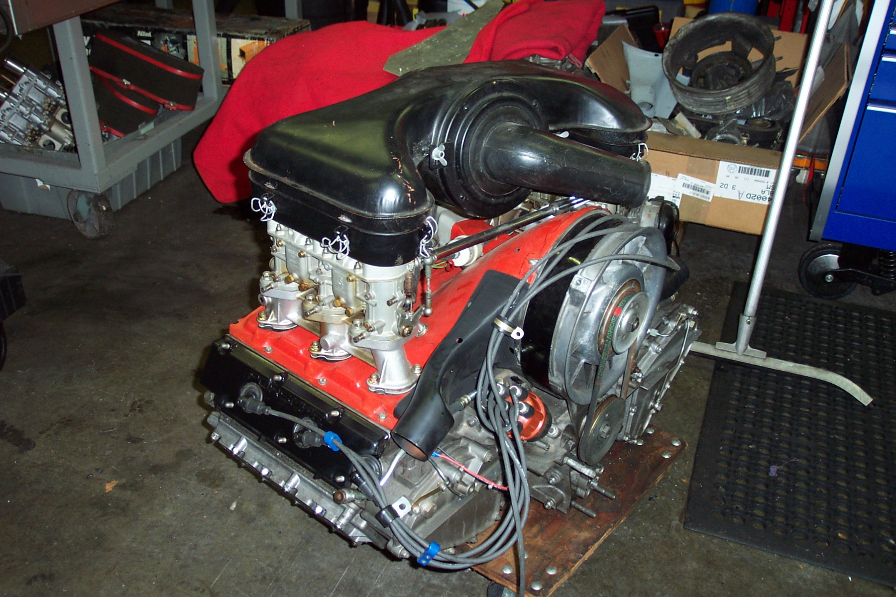

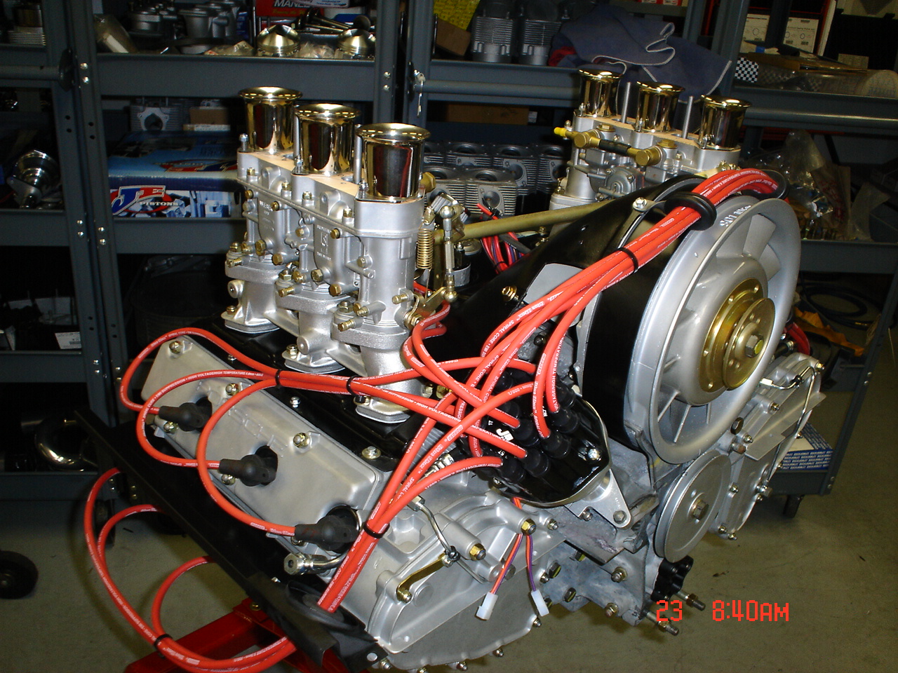

Engine.

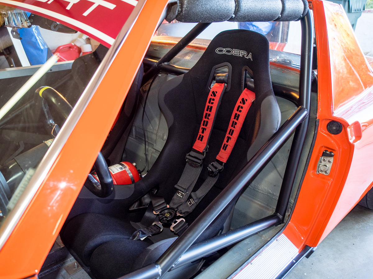

Cobra Suzuka kevlar seats with Schroth harnesses
Cockpit

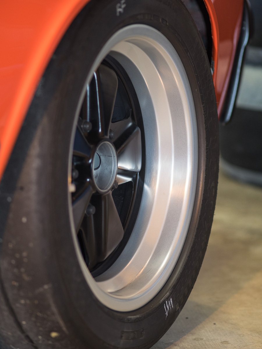

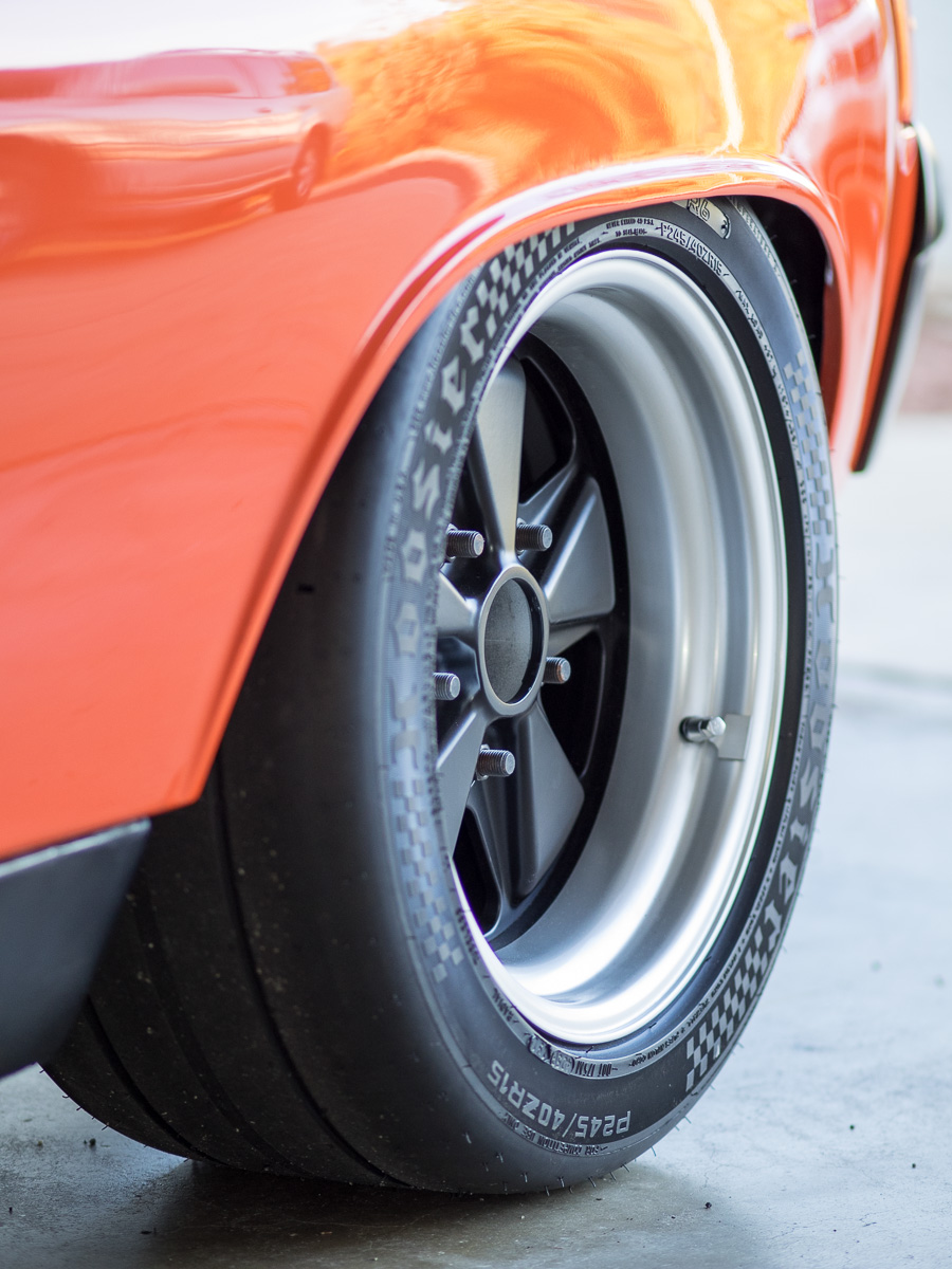

New Braid 15x9 wheel with Hoosier R6
NOS Fuchs 15x8 wheel with Hoosier R6

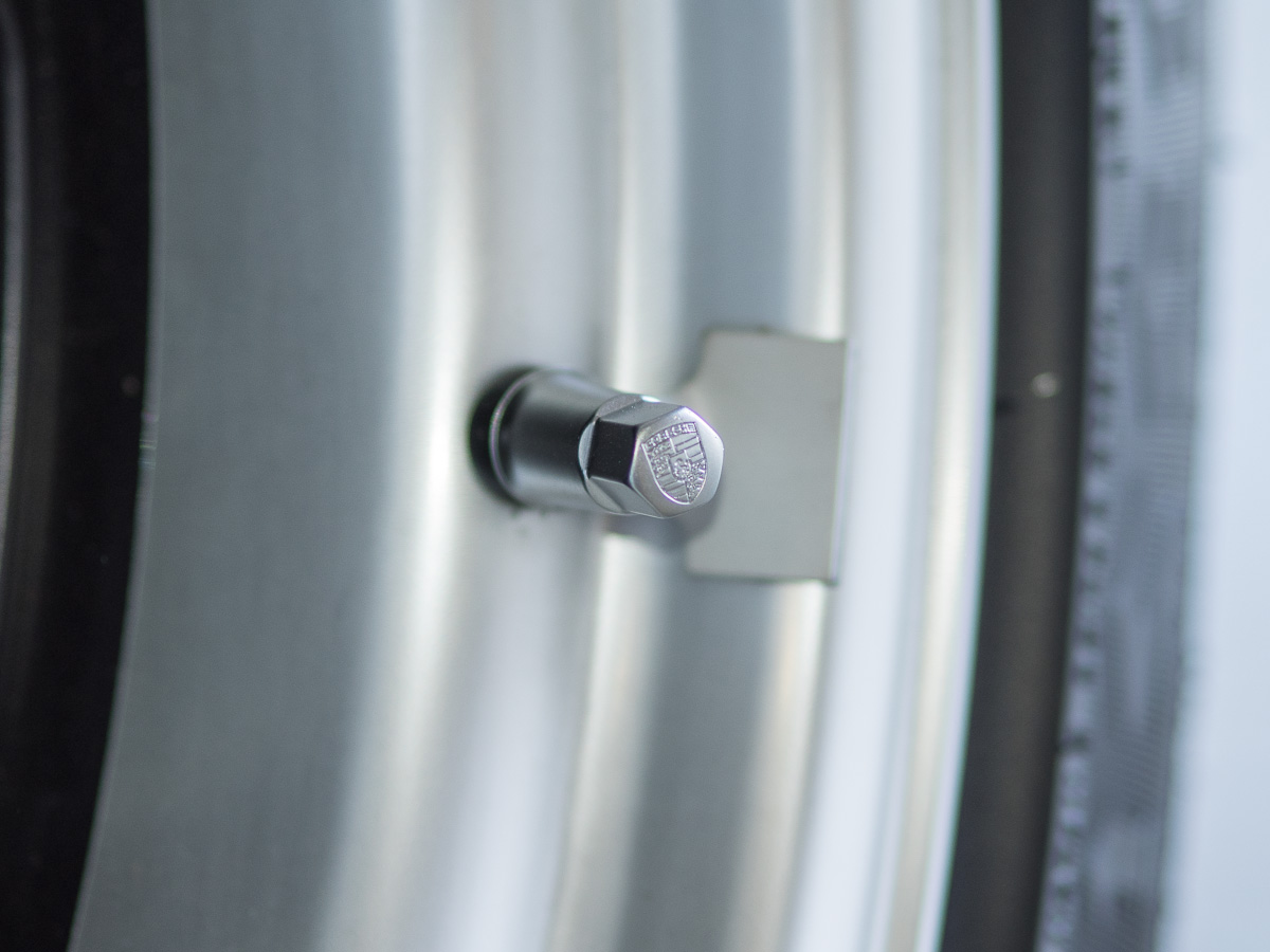

Factory stem, cap and brace thingie

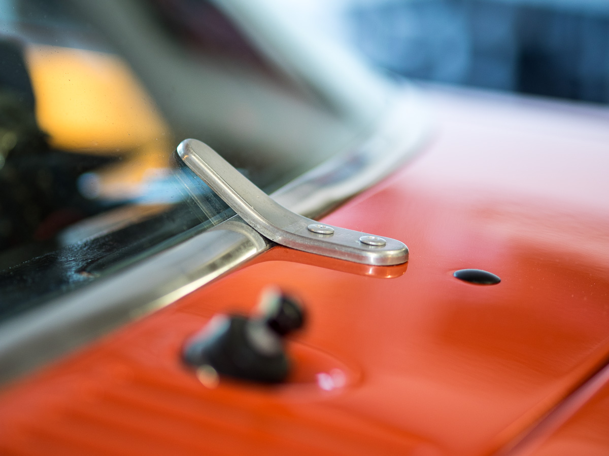

Smart Racing Products windshield hold-down detail

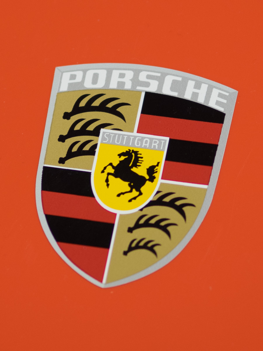

Factory-style hood crest decal

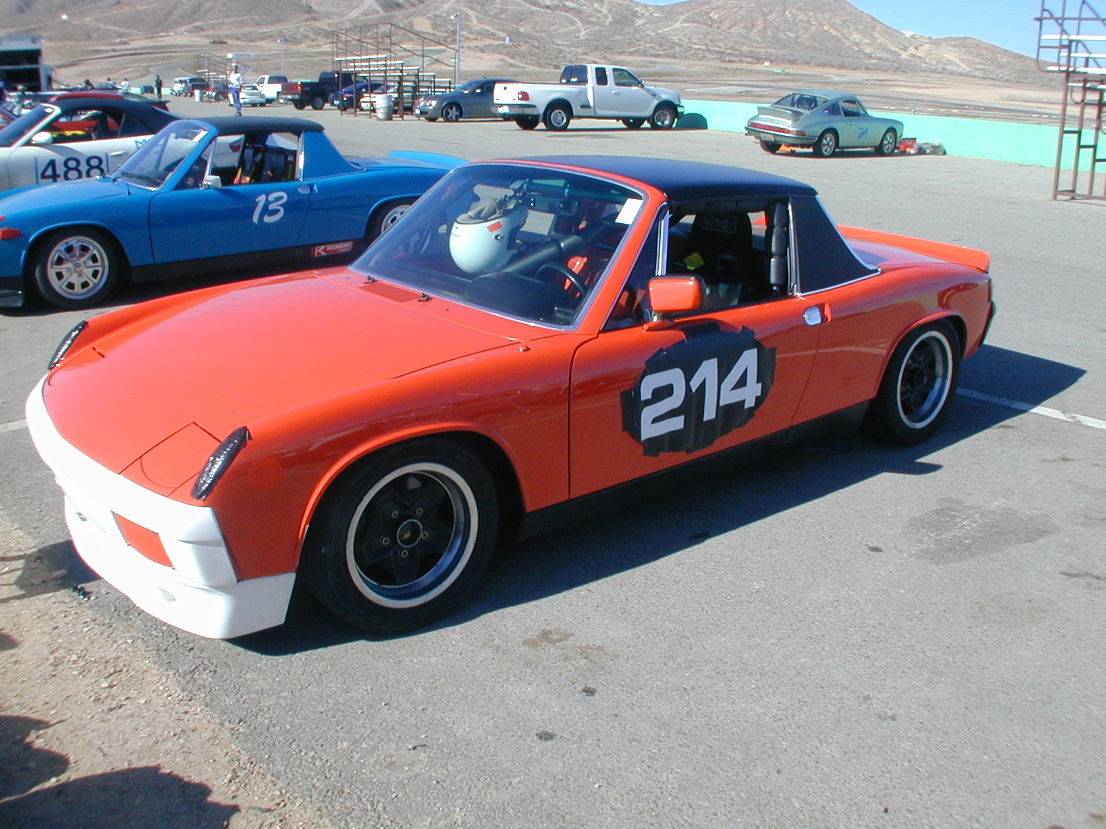

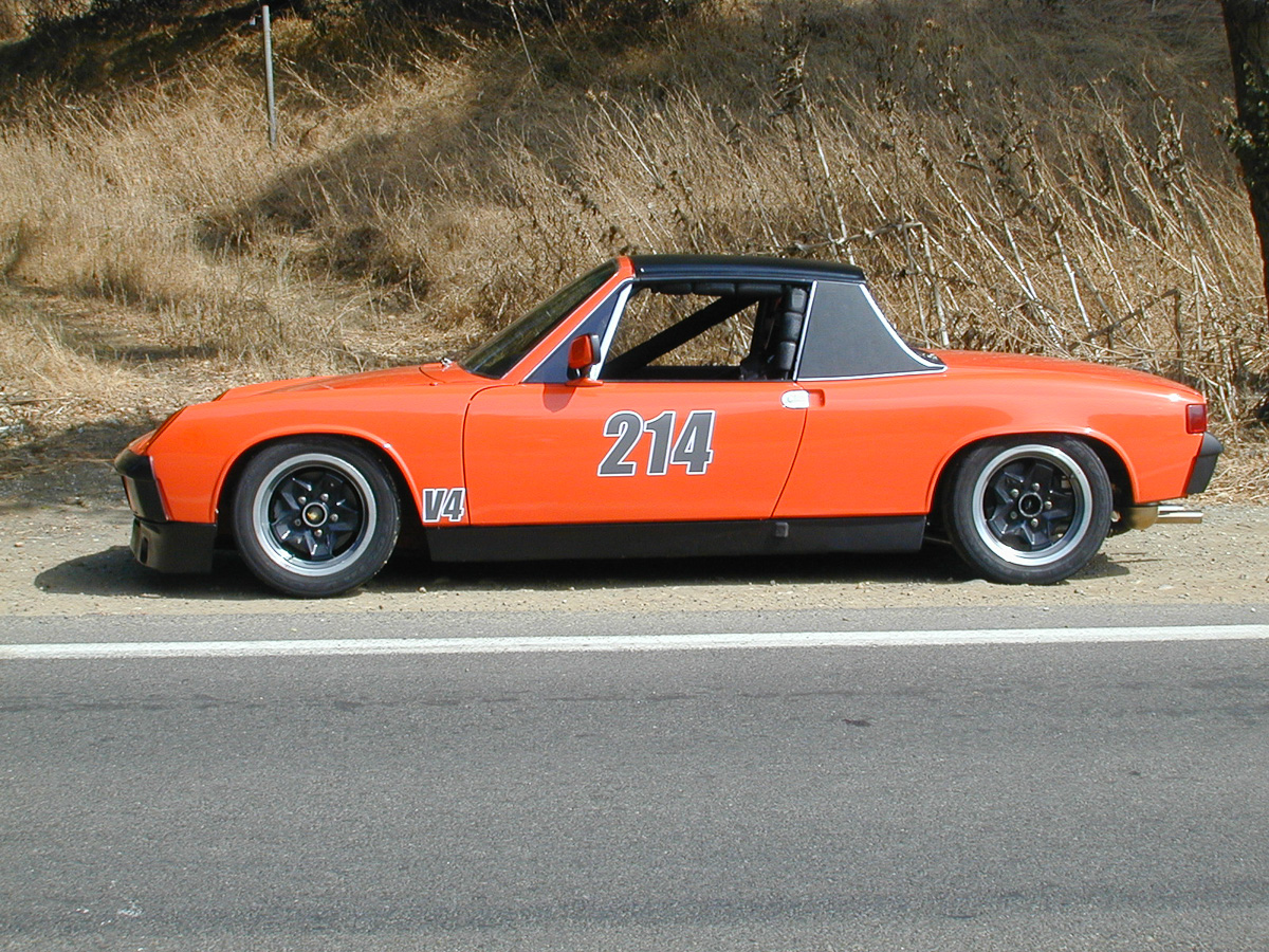

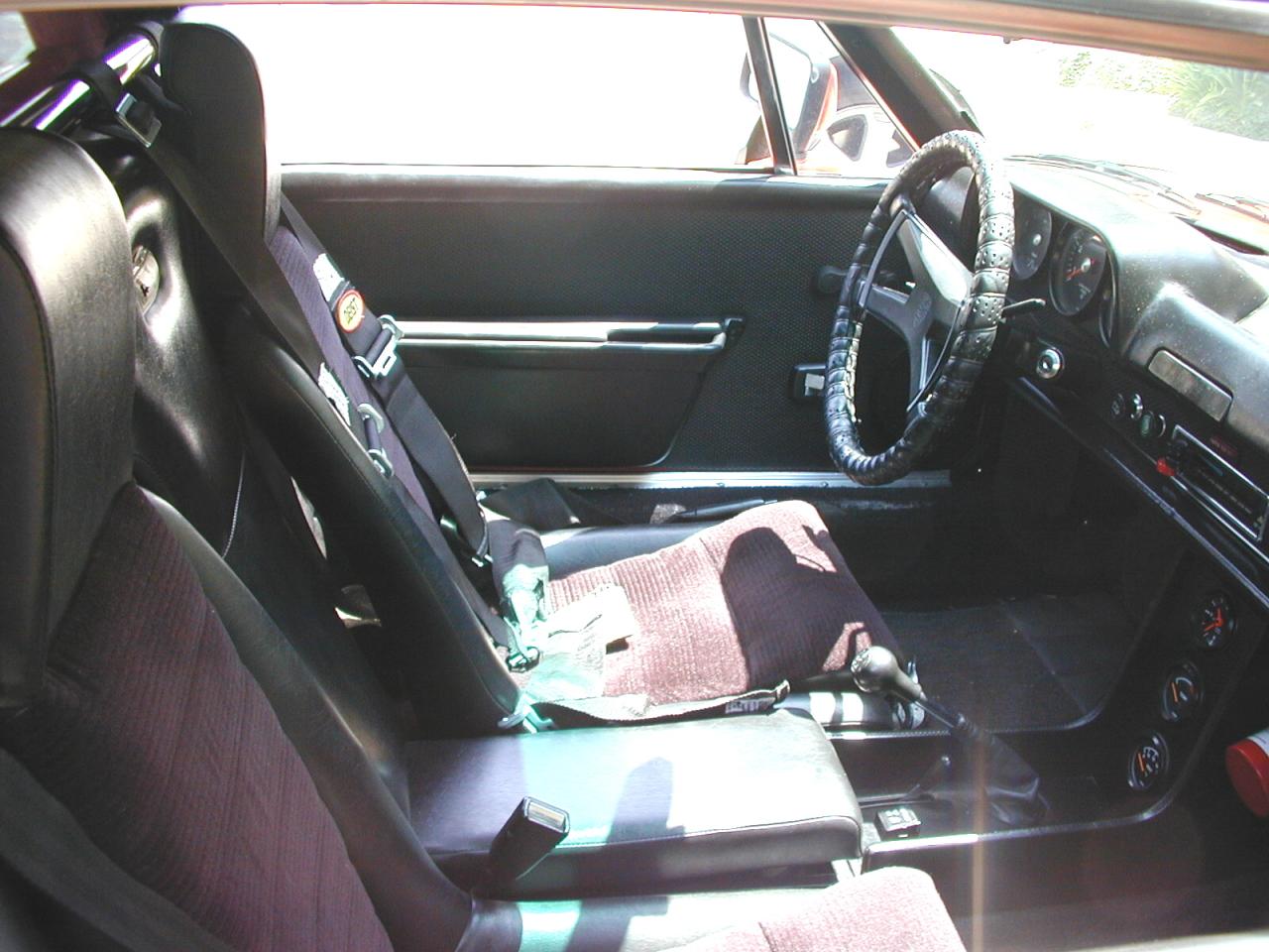

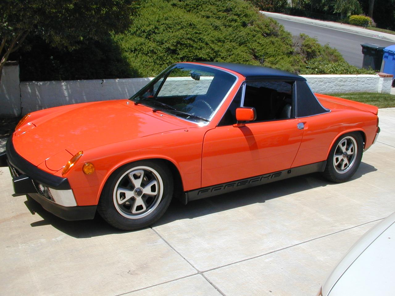

This build thread does not go nearly all the way back to when I started this saga in 2002, so I'll sum-up the history July 2002-Feb 2014 by copying this from the COTM thread.
I apologize for repeating some pics I posted before, but it's the only way for the story to flow right and catch-up to present day.
Before

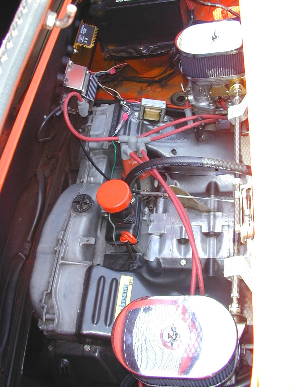

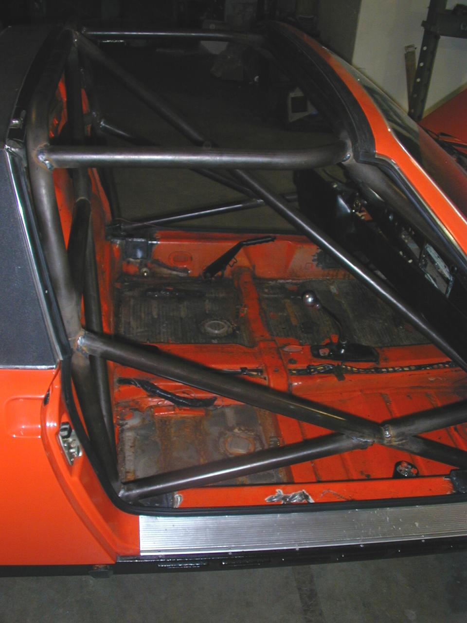

It started as a very clean, "no rust" SoCal 73 2.0 street car that had been hot-rodded a bit by the PO. He had put a big-bore 2.4L/4 with Webers in the engine bay, Eurorace headers, redone the seats in a nice corduroy fabric, short-shifter, and put on the rear reflector and spoiler.
Version 1

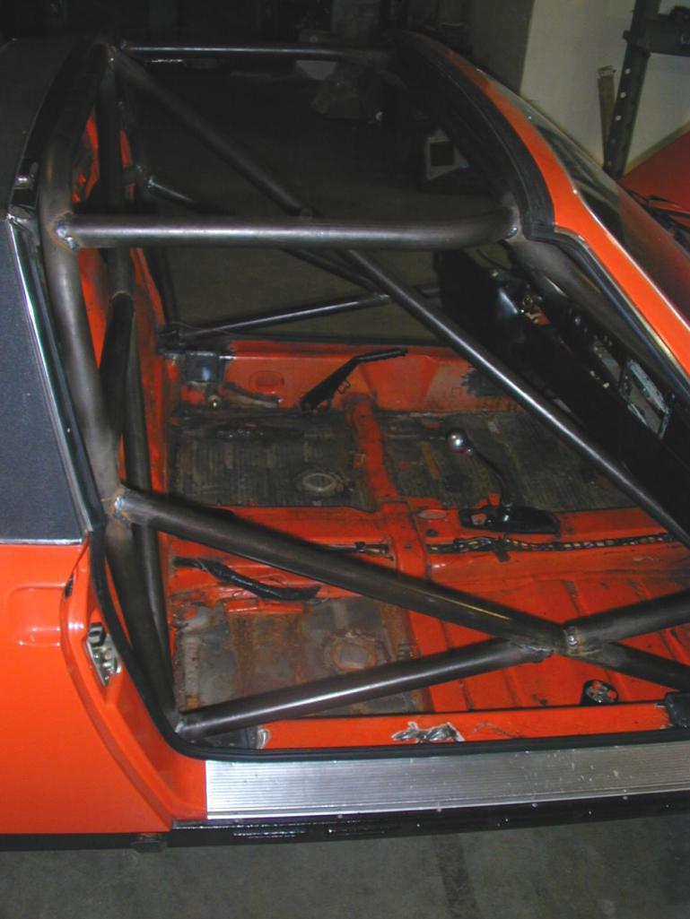

But, I had just sold a really nice stock 73 2.0 and that wasn't what I was after this time around. So, I almost immediately started gutting the car. In went a welded rollcage by TC Design. I also swapped to fiberglass bumpers, and put on a freeflow Dynomax muffler, removable steering wheel, new gauges, alloy pedals, race seats and harnesses, etc. Then I had Ottos do a 5-lug conversion with SC front-end and brakes, bigger t-bars and springs. I ran a few track events this way.
Version 2

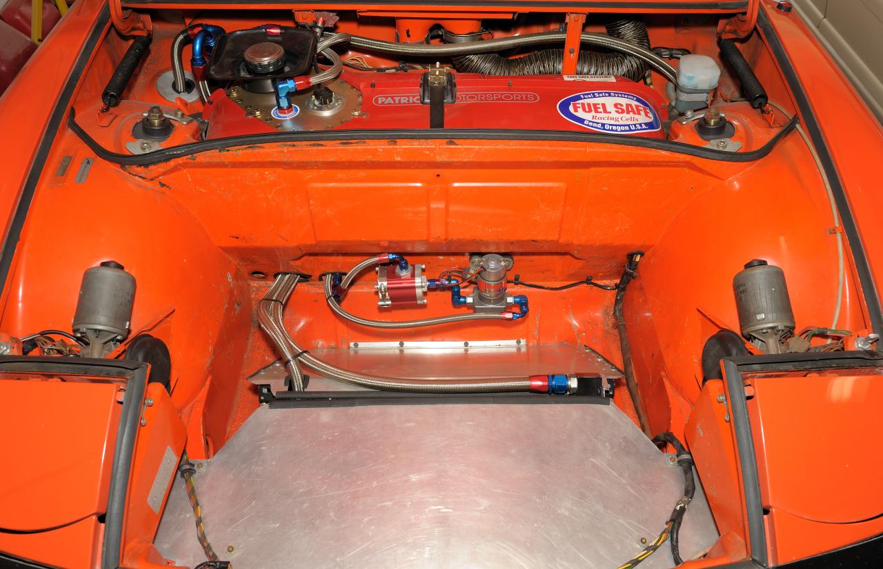

I know the Type4 has its fans and merits, such as nice torque. But I was very worried about the longevity of this 2.4 in track use, and had the lust for a /6. So I bought a hot-rodded factory /6 engine that had purportedly been rebuilt with 2.2S parts. It was a mystery motor but turned out to be a great deal and gave me no trouble in about 6 years of use.

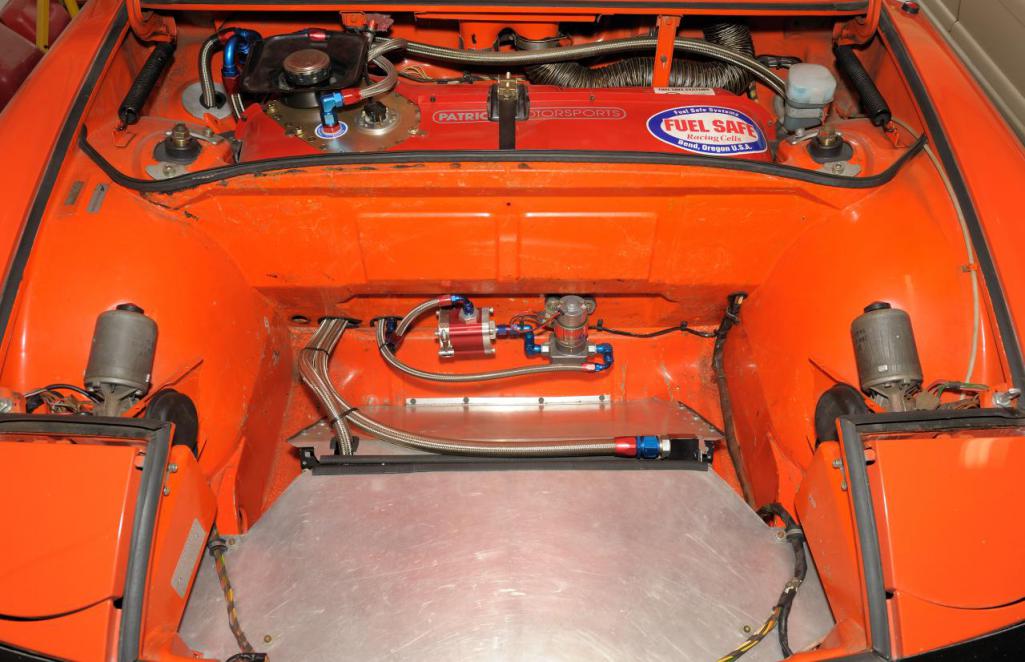

Ottos also installed the PMS fuel cell, giant oil cooler, metal fuel lines and other mods during the /6 conversion.
Somewhere along the way, Ottos (John W.) also built me a killer transmission for the car, with 904 mainshaft, short gears, Quaife TBD, billet intermediate plate. I also installed a Rennshifter and redid all the linkage bits, and added the Spa fire system. I added a fiberglass skin top at some point too.
I really loved the car at this point, and ran it this way from 2003-2009 or so without major changes.

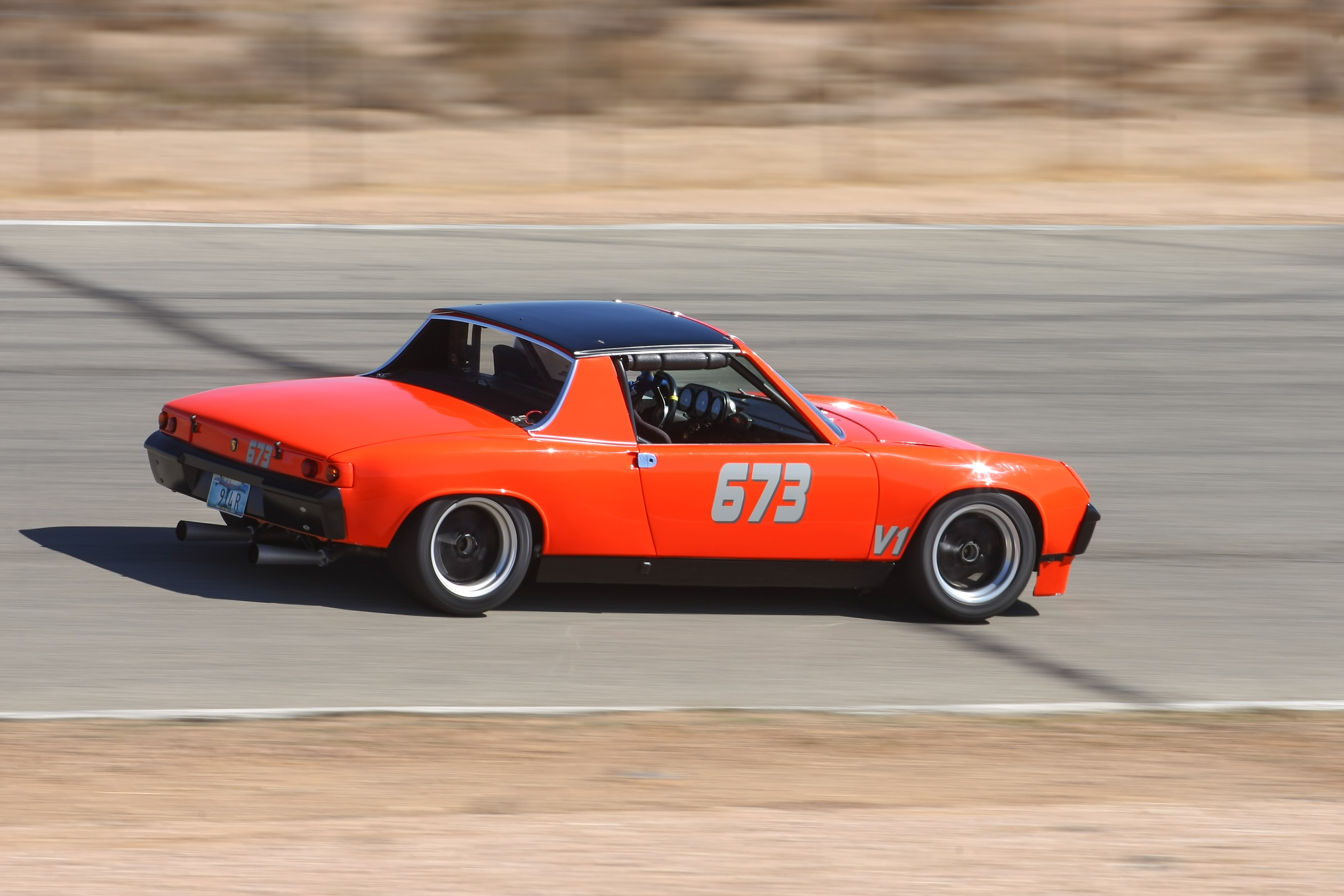

Version 4
The bigger engine was really a blast - powerful, and looked and sounded fantastic. Now the car really needed more rubber as the 205's just could not keep the power to the ground. So, I ordered some custom flares from Tangerine Racing (Chris Foley) and set the wheels in motion so to speak for some more major rework. The car went to Kundensport (Ed Palmer) in Camarillo for bodywork, paint and rollcage extensions.
After a couple seasons of pretty heavy track use, the engine was noticeably down on power and showed fairly bad leakdown in one cylinder. So the engine went to Galen Bieker at WerksII in Burbank for what turned-out to be a complete rebuild and upgrading process with extensive new parts and machine work. This was a good choice as among other sketchy things found inside, the 964 oil pump housing had cracked. (It now has a 930 pump.) Galen also rejetted the Webers for top-end, and spent a lot of time optimizing the heads.
Somewhere along the line the car also got Carrera calipers with vented, cross-drilled rotors and both ends, raised spindles, custom-valved Bilsteins, a Smart Racing front swaybar and additional tub bracing.

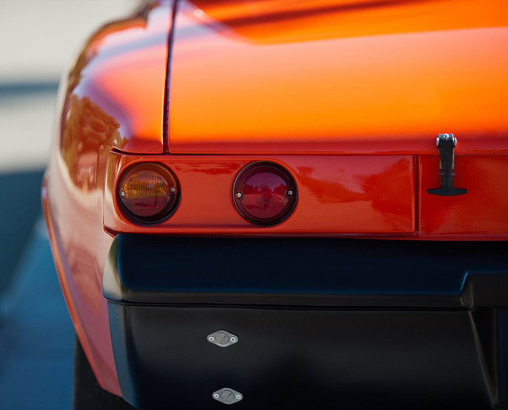

I added the 911R-style tail lamps to carry the "914R" theme farther along.
So, there you have it. The car has many, many more mods not listed here and countless hours and dollars poured into it, and of course that's still ongoing. I am working on the dash now and just installed the Racepak G2X data acq system last weekend. I'll probably cover the dash in perlon felt and aluminum, with a factory-looking pod over the gauge cluster.

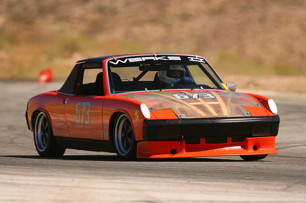

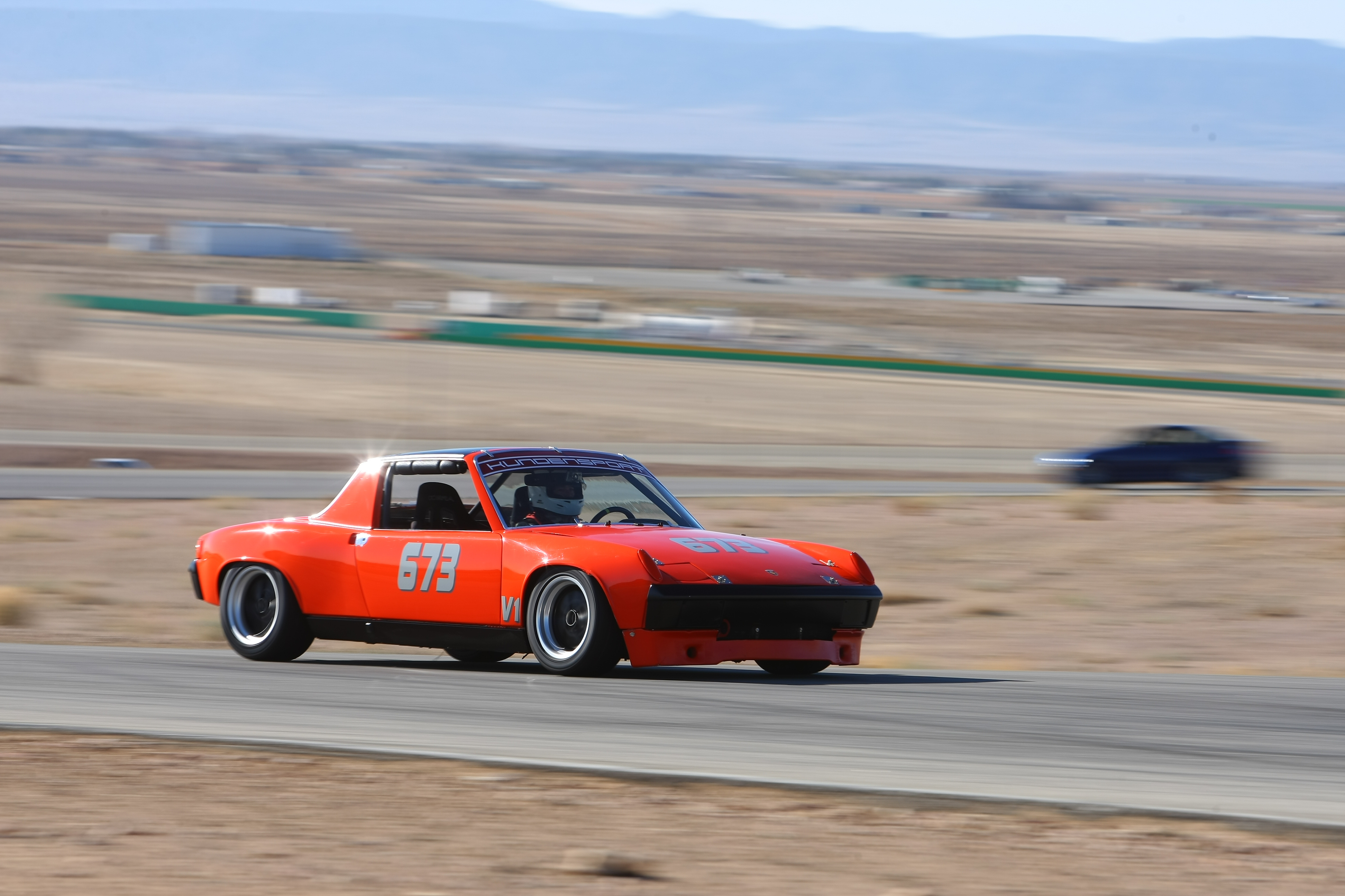

914R and I had a most excellent day at Streets of Willow with Open Track Racing yesterday. Great people, great weather, and awesome cars. 2 1/2 hours of on-track time - holy moly was I tired! Here are are couple of pics (via Cali Photography).
The car is extremely fast on this sort of track and all day long I passed if not lapped everyone in my run group including a Boss 302 Mustang, Cobra replica, Cayman R, WRX STi, Cayenne Turbo, a couple of M3s, a Lotus Exige or tricked-out Elise maybe, and of course some 911s. Granted I have a ton of experience on this track, but also the car just sticks and fricken rockets off the corners with the rebuilt engine and wider rubber. In the afternoon when the track surface heated-up and junked-up a bit, I was getting wheelspin in 2nd and 3rd gear and getting very sideways. That’s with an LSD and fresh 245 Hoosiers…very fun, but not fast at that point. Going drift-style cost 2-4 secs/lap.
In the first morning session I put the right wheel off into a horrible rut then back on track which bottomed it HARD. It sounded like a bomb going off, and cracked the damn windshield as well as ripped-out the dzus fasteners holding the front spoiler on that corner. (Luckily the spoiler is fine and I zip-tied it in place.) So, I’ll be adding a windshield to the list of stuff to do soon. (IMG:style_emoticons/default/sad.gif)
At the end of the day, coming down the hill (clockwise) very hot in 4th gear I had a spectactular spin but by then the @#%^ camera battery had died. I stayed on the track and it was a minor pucker moment. (IMG:style_emoticons/default/icon8.gif) Fortunately nobody was close behind me.
I beat my personal best laptime here by around 2 seconds — got down into the 1:24.5 range! (IMG:style_emoticons/default/biggrin.gif) Unfortunately due to what was most likely an operator error, I did not get any data off the new-to-me G2X box. (IMG:style_emoticons/default/confused24.gif) Not sure what happened and hopefully the box is not broken. It was a last-minute install and I should have tested it thoroughly first. Sigh.
I have some in-car video I will try to edit and post here later. I really wish the GoPro had better audio. People always compliment how cool the car sounds at full rip, but in the video it sounds like crap and I want to hear it myself! I will work on that too.

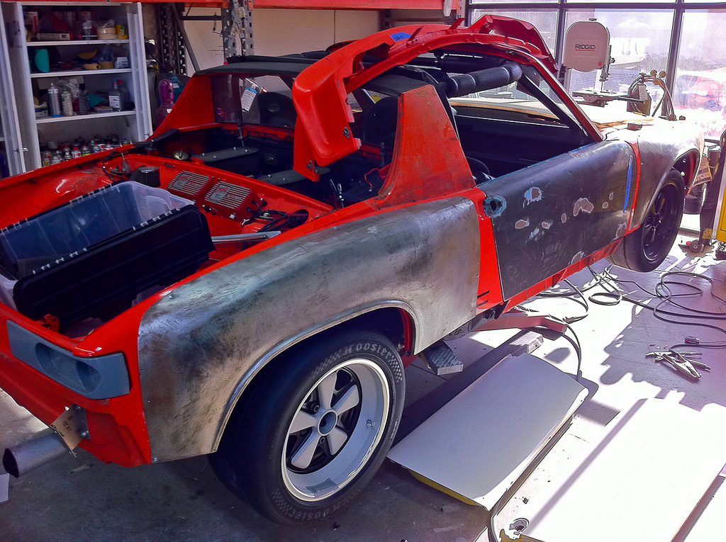

Marco at TLG has finished dialing-in my Webers, and did the valve adjustment and oil change. So I got to test-drive it a few blocks today and the off-idle and idle-to-main transitions are MUCH better now.
He also discovered that my little 'ditch incident' tore-off the front right swaybar mount tabs from the A-arm, which is easy to fix but I'm damn glad he found that because somehow I had not and probably would not have until it was too late.
Next week it'll get the windshield replaced and front fenders and swaybar mount fixed and then she'll be track-ready again!!!
