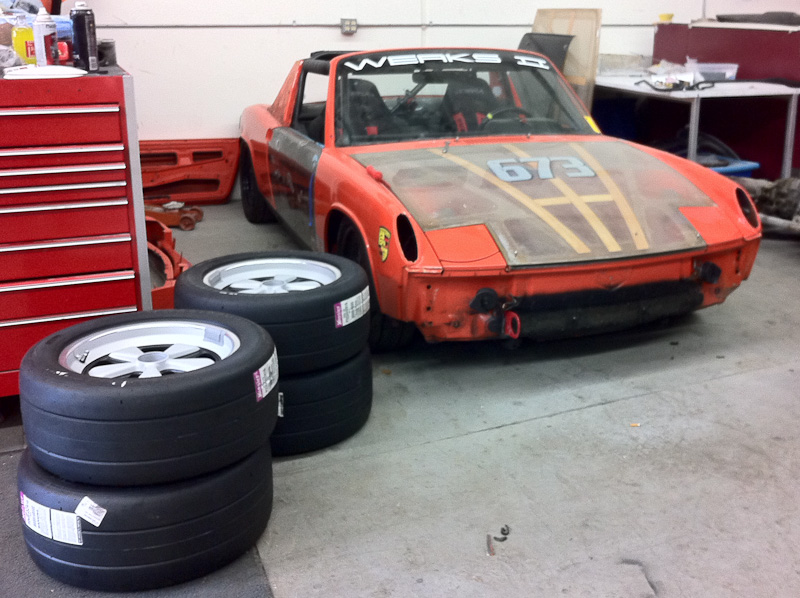

The bodywork is officially underway! I dropped-off the larger Fuchs with fresh Hoosiers today, for test-fitting purposes, as well as spoilers etc.. The front Getty lid has been aligned and filled a tad, replacement door fitted, windshield and sail trim removed, and other stuff is also starting to come off. Next week the actual cutting/welding/sanding should commence.

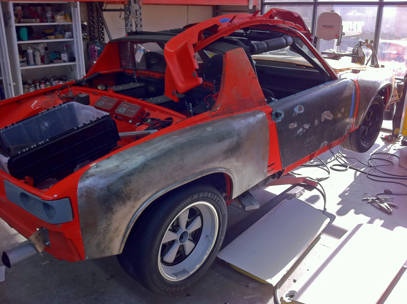

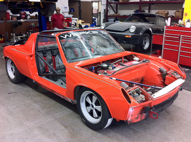

tavoman27, to clarify, Galen has done a bunch of suspension and brake work on this car lately but now it is at a different shop -- Kundensport -- for the body & paint work.
Here is the latest update as of this morning. The dis-assembly and fitting work is well underway (engine, seats, etc. still need to come out.).
Ed is concerned about the fit & finish of the rear flares but he is going to work on them some more before we consider "Plan B". The fronts are great. Nothing has been cut or welded yet, this is just test-fitting so far.
JP, here is some "hammered shit" for ya. It will get a lot worse before it gets better...

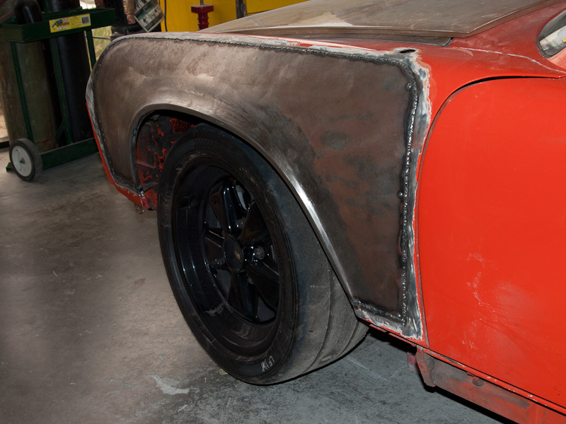

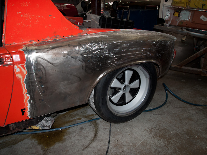

The flares are on! The right side is nearly paint-ready, the left side (shown) still rough. Clearance is just fine with the 245's on 9's and with the optimum offset wheels, 275's on 9's or even 10's should be doable.
The below pic of the front is still with the old 205 tire on a 7x16 wheel. I think I can fit 245's up front as well, but for starters I bought 225's to be safe.

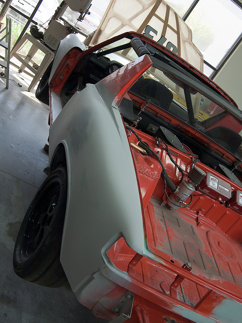

The car is pretty close to paint now. The flares are installed, smooth as a baby's skin. Also the lids are fine-tuned for nice gaps, rear trunk floor rust repaired, doors prepped. Next week the engine will come out, and some new cage tubes welded-in. Then I suppose paint is next.
The rear flares look cool IMO. It's hard to really get a shot that shows the lines with the car in primer and shop lighting. The lips on the fronts seem a little larger than needed, but I'm sure I will get used to it. (The old 205's are back on the car in this pic.)
