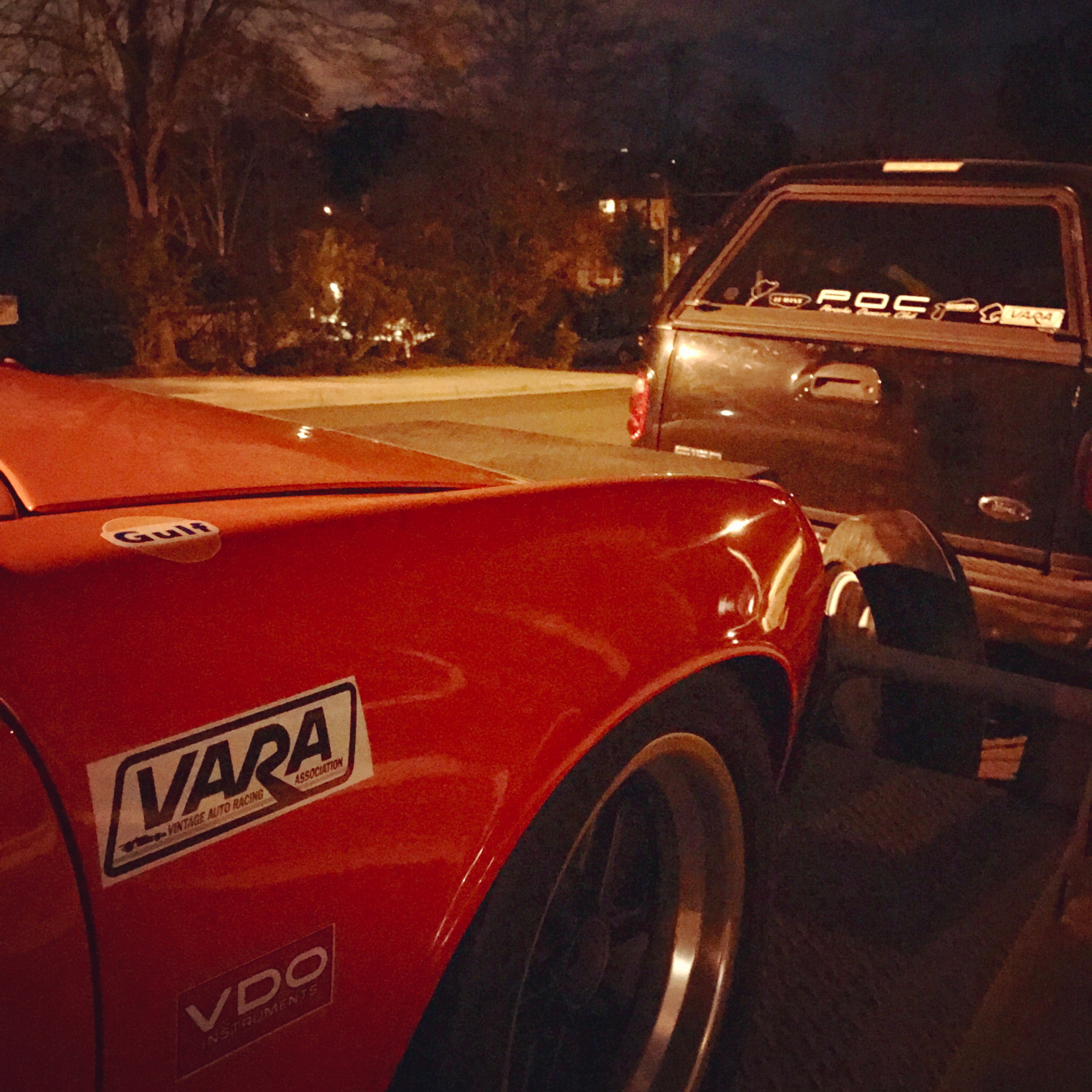

Well, the VARA University weekend was mostly a bust. Not a total loss, but frustrating and really not fun at all. I did meet a few nice folks though.

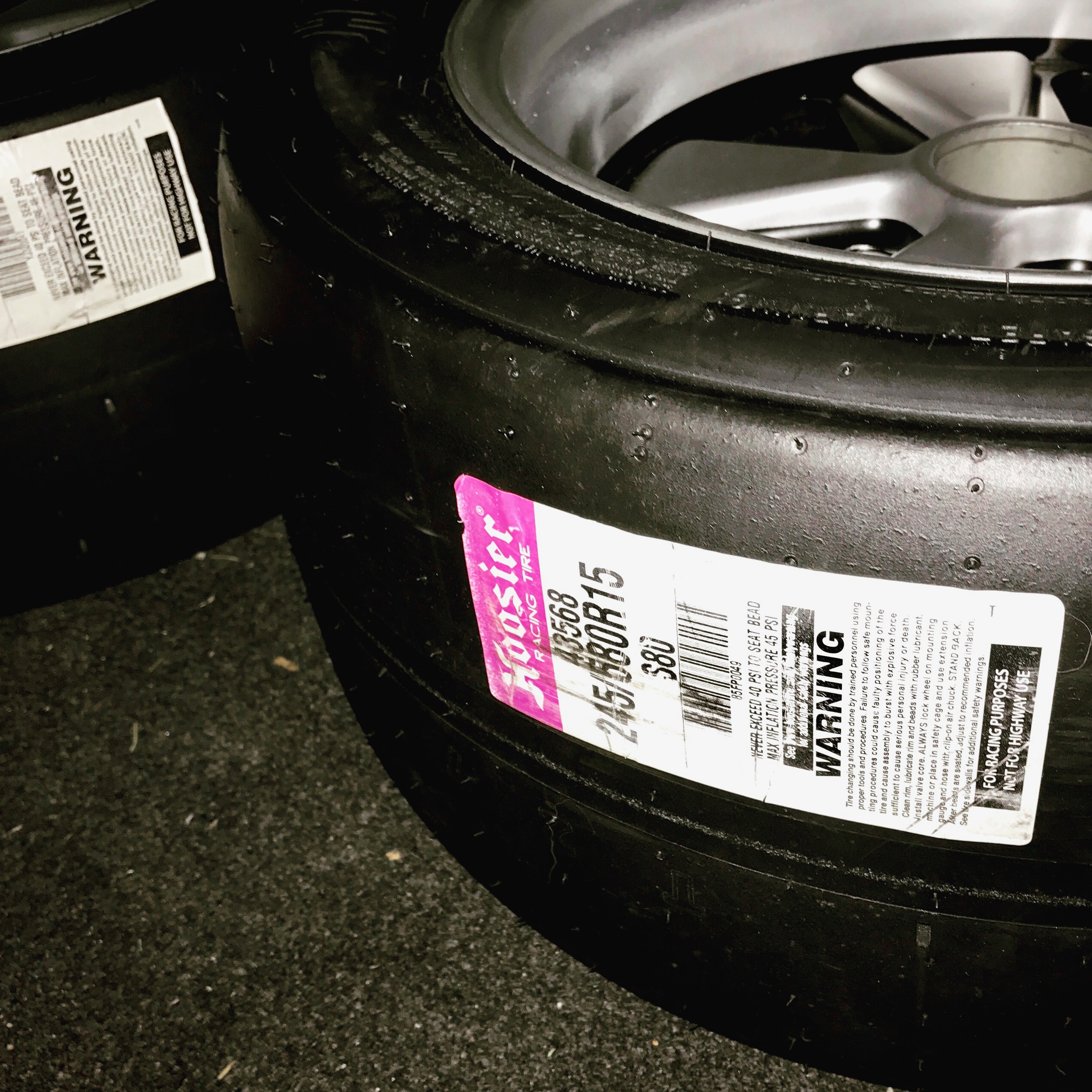

I got a new set of slicks to have as spares. (IMG:style_emoticons/default/cheer.gif) I figured I would probably heat-cycle them Sunday afternoon and use my old DOT Hoosiers for all the sessions.
The first signs of a bumpy weekend were that Buttonwillow is a 2.5 hour tow for me. It's normally a pretty easy boring drive, but for the Grapevine which this time was completely blanketed in fog. I couldn't see a thing for over an hour. Made it before 7 though.
It was cold. Yes, only California cold, but super damp air and Buttonwillow was just mud and water everywhere. My car then would not start. This has never happened to me that I remember. Of course I have jumpers and it fired right up but I may need a battery again.
I can say the VARA approach is very different compared to POC. The racer's group I was in was far more laid-back, less structured and informative in class and track exercises, and way slower on track. I never got up to speed or really had any fun.

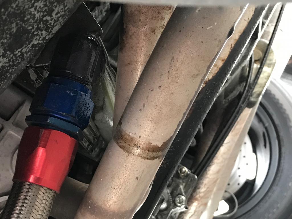

Then, a big AN16 fitting on the engine oil cooler started leaking. I'm 98% sure the seal has failed, and it got worse and worse. No way could I fix this track-side, as even though I had the wrench it was impossible to get enough clearance/leverage. Not to mention I did not have that spare fitting. (I do actually carry some AN parts and tools.) Or an oil drain pan or much oil etc...
Got called into black flag twice and by the time of the after lunch session, I deemed the car undrivable as it was smoking too badly off the header and I cannot risk a total oil loss.
VARA signed me off for 1 day of the license school and I'll take care of the rest on some regular race weekend Friday afternoon.

The car started accumulating a nasty slime of oil and smells horrendous... will be all mended up shortly though. (IMG:style_emoticons/default/aktion035.gif)

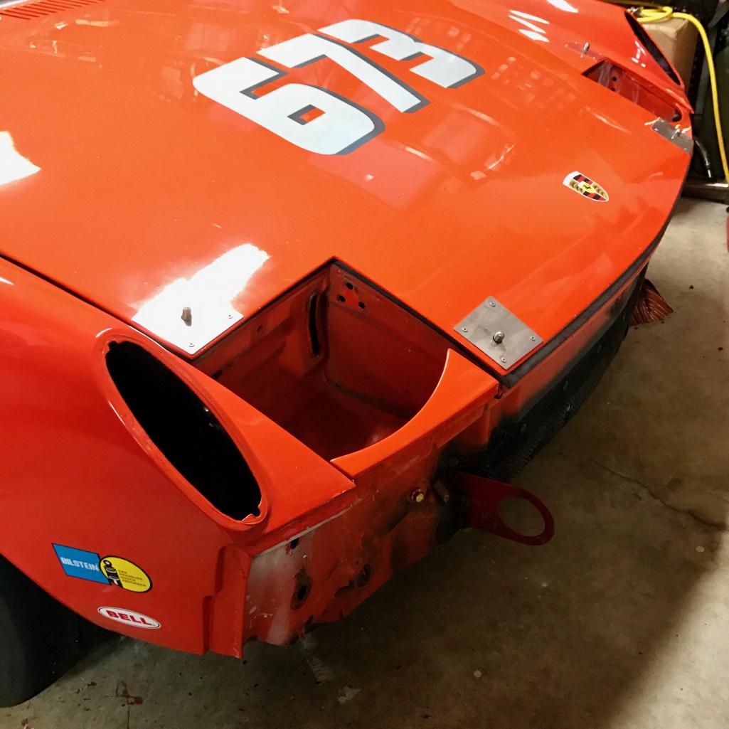

So, the latest chapter which started last Sunday when I unexpectedly came come from VARA early, is I am going to give-up any pretenses of keeping the thing streetable. For now, at least. I will keep all the parts to put it back to some sort of "road rallly spec" later if desired.
I have already removed the front lights/brackets/motors, turn signals, horns, and re-routed the wiring harness out of the way after pulling the fuses and terminating all the ends as applicable. That's a lot of weight already. I do want to basically re-wire the whole car at some point but have events to get thru, so I have to phase things.
I'm looking at brake cooling inlet options now. Hooking the ducts to the front spoiler totally sucks for me as the spoiler has to come off for trailering. I want to permanently get the ducts mounted on the car somehow; or, maybe a quick-release duct connector.

Make ducs that use the indicator holes as intakes, in that duct you install a small forward facing orange led to use as indicator on the track.
Then might be able to have the hoses permanently installed in the wheel housings and for street use you just swap out the ducts for the stock indicators.

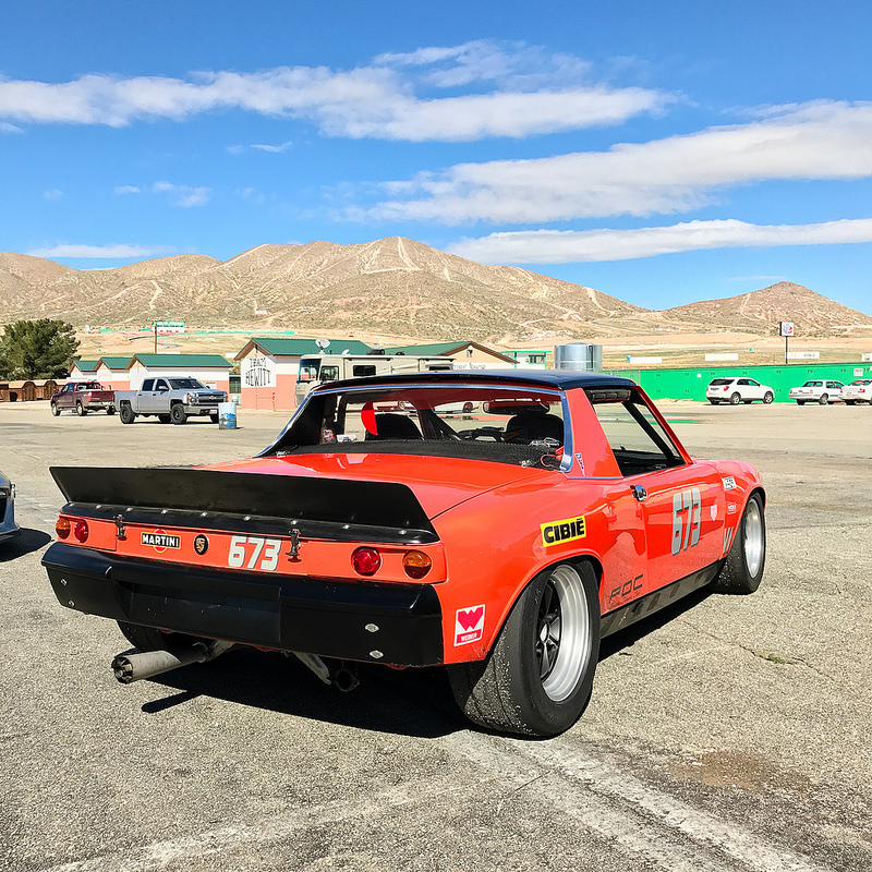

I have also continued to lighten the car, which is now down to 1994lbs wet w/o driver, still with a full passenger seat+harness. I have now removed all remaining front lights, motors, and the windshield wipers as well. Other than the right seat, there's nothing more significant to remove at this point, other than actual sheet metal.

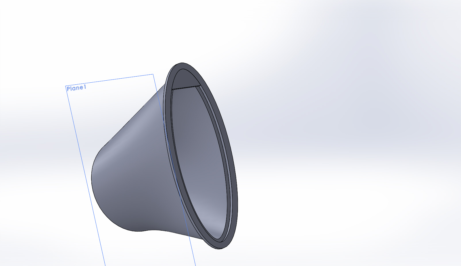

Unfortunately in that POC WSIR event the car ran GREAT but (a) I lost an exhaust megaphone at-speed - luckily did not hit anyone - and retrieved it later but it's thrashed; (b) my transponder power wiring had failed and in a double murphy's law, the POC loaner did not work right either. So I had no timing/scoring. © On top of all this, my truck broke just before as well with an unexpected >$1K bill.

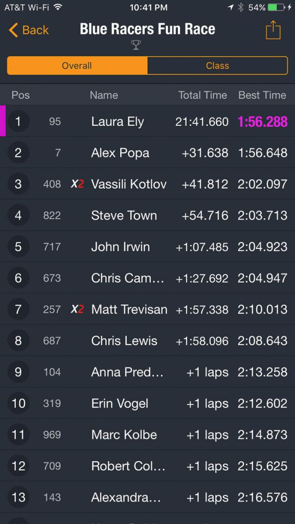

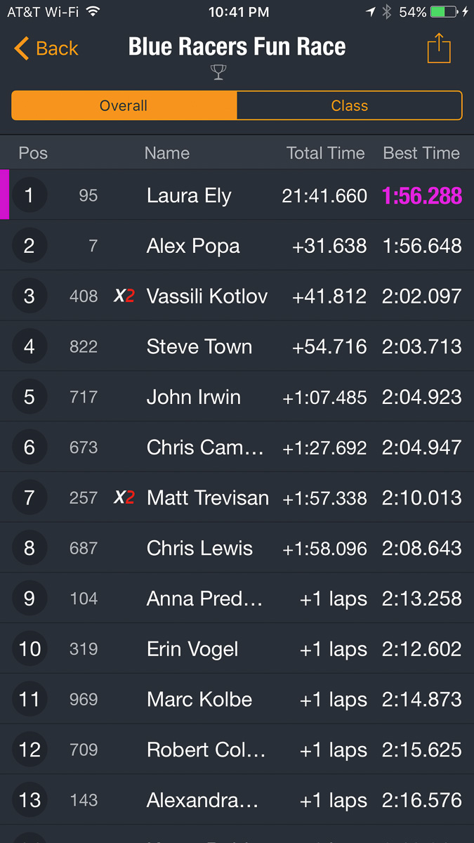

I need to keep this update fairly short but suffice to say, my 2nd POC Racers Clinic which was at Buttonwillow last weekend was AWESOME (IMG:style_emoticons/default/aktion035.gif) and I "graduated" as a new rookie Cup Racer. (IMG:style_emoticons/default/smilie_pokal.gif)
What everyone says about W2W racing is true. There are very few times in your life you will ever feel more alive, alert, and challenged. Also I am finding the racer social/teamwork bonds and camaraderie very different than in the TT/TA/HPDE world where it seems so many folks stay to themselves and have no clue who's on track with them.
I will have some photos soon from CaliPhotography. Here's in-car video of our final 10-lap sprint race, which was super fun and there was no carnage AFAIK. But in the heat of the moment, I f*ed up (flat-spotted) my tires badly which caused a hellish vibration and loss of traction. Then in the final lap I went off in Star Mazda, one of the last turns! But amazingly the guy behind me who had been up my ass the whole time, had run out of gas! So I started and finished P6. P1 was a Cayman GT4 Clubsport and P2 was a Ferrari F430 Challenge Stradale; factory race cars with flappy paddles and aero... P3-P5 were winged 996/997 racecars with ABS. I am very pleased how well 914R did.
I plan to get a better camera system soon, promise, hopefully with data overlay and good sound...
https://www.youtube.com/watch?v=Buw0HxHuyVE

18 total entrants - by the way, P1 (Cayman GT4 Clubsport) was a female. Smokin fast!!!
