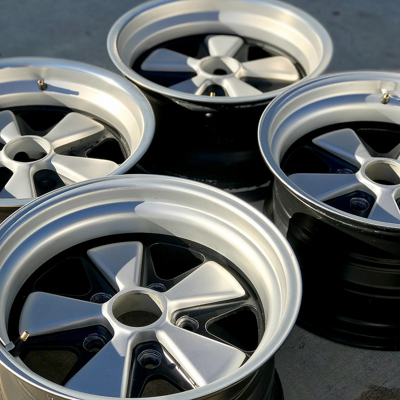

Some fresh Al Reed 15x8 Fuchs to go with my existing Braid 15x9's.
(IMG:http://www.914world.com/bbs2/uploads_offsite/farm5.staticflickr.com-21-1527045543.1.jpg)

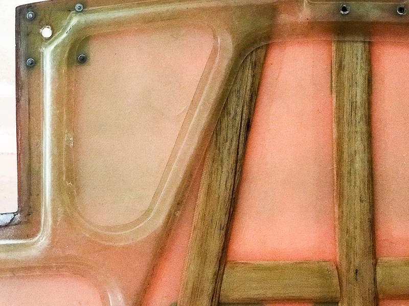

Getty GT repro lid w/ balsa wood.
(IMG:http://www.914world.com/bbs2/uploads_offsite/farm5.staticflickr.com-21-1527045544.2.jpg)

QUOTE(campbellcj @ May 22 2018, 08:19 PM) *
Would like to know what you think about the Getty lids....
Do they fit, are they light, really flimsy, etc.
Anything you can add is helpful.
I bought a set of the front/rear lids that I think are the same ones that Aase Sales carries.
They look great, but don't fit so great and really don't have the correct curves to match up with the body.
But I guess that's the way the Porsche Motorsport lids fit back in the day.
Underneath mine look killer like yours/the Getty lids.

The Getty f/g pieces I got (~2009) are extremely nice quality. TRE Motorsports installed them originally while doing a 2.2-2.7 engine swap for me. They said the lids just bolted right up, and gaps are pretty good. A while later Kundensport painted the car.
The main point is they are very thin and light - They do warp and flex at speed - but I have had zero issues from this. The main worry would be somebody sitting on it or putting something on top that would crack the paint or f/g or balsa.

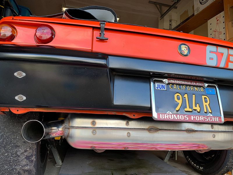

I'm making progress (slowly) on reconfiguring 914R to be more street-friendly / less cop-magnet.

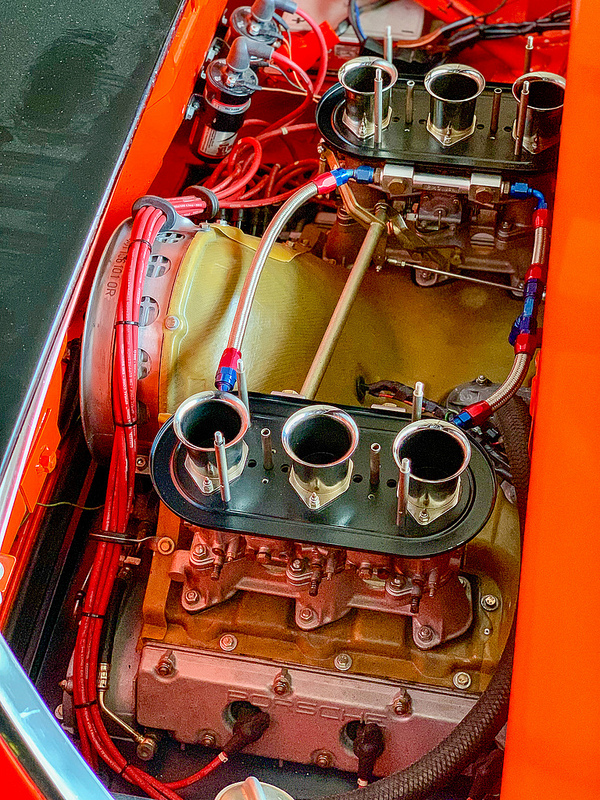

When I started this a few weekends ago it was a PITA to get the car started, as I let it sit too long and it's been colder than usual out. #becausewebers
I had to pull the air filters off so snapped this.
(IMG:http://www.914world.com/bbs2/uploads_offsite/farm8.staticflickr.com-21-1552010683.1.jpg)
Once running I installed a NOS Dansk 2-in/1-out sport muffler I got for around 1/2 price from a private party who'd changed his build plans (ever heard that before?)
(IMG:http://www.914world.com/bbs2/uploads_offsite/farm8.staticflickr.com-21-1550064958.2.jpg)
So far I love the Dansk muffler -- it's tamer and more "Porsche-like" than the M&K 911R muffler, I think perfectly aggressive for sporty street use. It's heavy though.

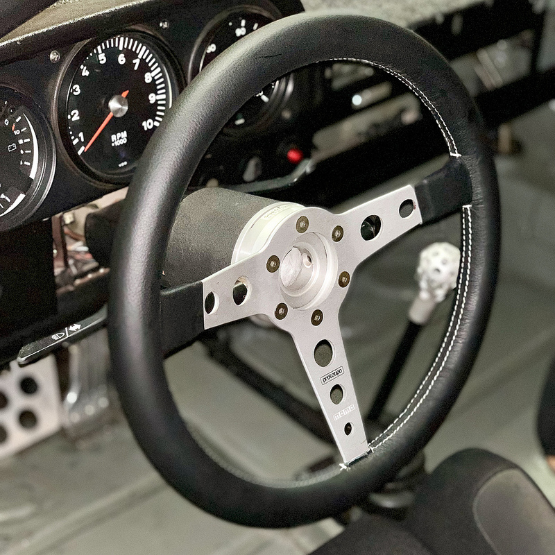

I also installed a silver Momo Prototipo, also new, that I had in storage for years. I really like it - previously I'd used a 90's-era Personal/Nardi Fittipaldi wheel since buying the car.
(IMG:http://www.914world.com/bbs2/uploads_offsite/farm8.staticflickr.com-21-1550064957.1.jpg)

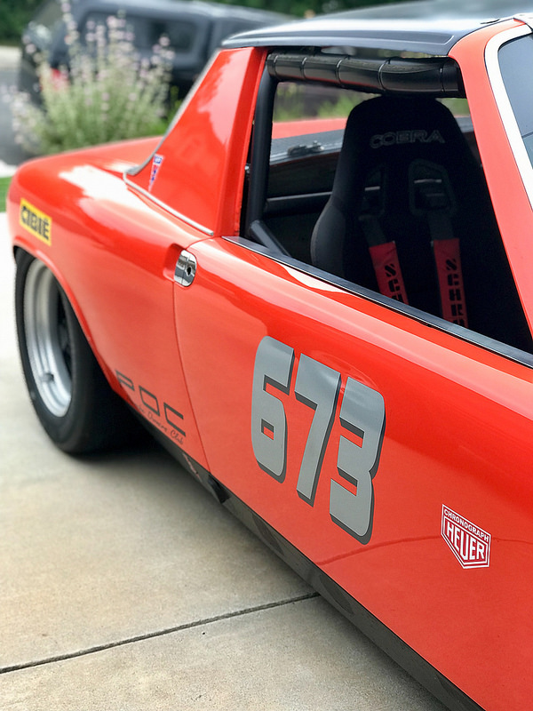

QUOTE(campbellcj @ Mar 7 2019, 05:55 PM) *
Last weekend I finished stripping the race graphics and worked on the pedalboard area (painful). Have some new streetable tires on order now and thinking about seats, possibly GTS Classics.
Do you mind sharing how you mounted your race seats? I don’t recall seeing that in your build thread. I’m having trouble with headroom with the floor crossbar still installed and Recaro spgs...
Thanks!

QUOTE(infraredcalvin @ Mar 7 2019, 08:26 PM) *
Thanks!
I'll plan to take some pics of that soon. I'm using side-mounts (Cobra) bolted to the floor thru some steel reinforcement pieces; fixed-position, no sliders in my setup. The cross-bar is cut. That's kinda controversial but it really gets you down lower and this car has a 10-point cage so the structural integrity loss is not a big worry. (That said the floors and rest of the car were extremely clean and solid rust-wise).
