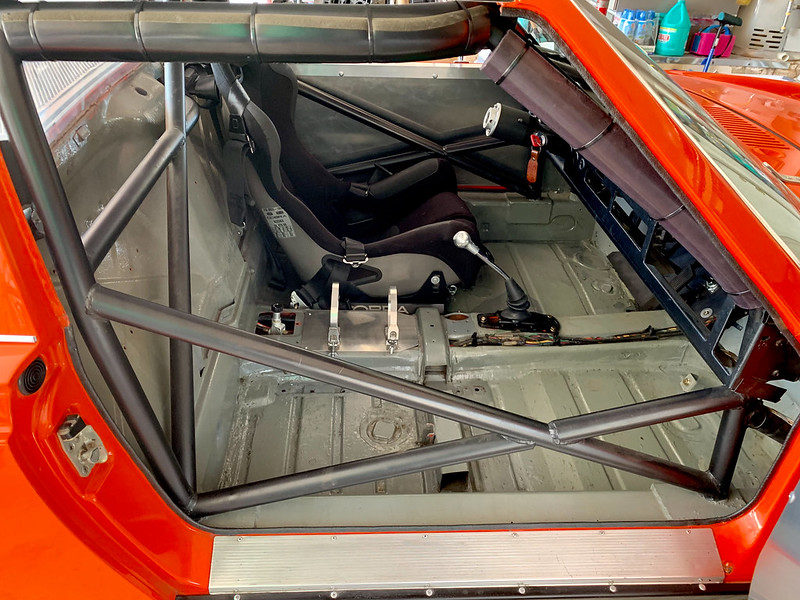

Hey Chris, What are you running for chassis stiffening on this monster?
It's got a 10-point welded-in cage plus the GT-style kit and boxed arms in the back, repairs/reinforcements around the "ears" and probably some other stuff I'm forgetting. It's pretty darn solid but I do worry about all the stress from running slicks and very stiff suspension.

Just a quick status update. Having a muffler on the car obviously makes interior and road noise way more noticeable/annoying.
The other day I first noticed the left side rocker cover was rattling like crazy at the rear attachment point - tightened down, easy fix. Then I finally found the source of the most obnoxious noise which is not what I thought and actually was an additional culprit. The metal dash frame is/was touching against the rollcage slightly, causing a horrible buzzy rattle. I think fixed now but need another test drive.
The remaining NVH challenges are the aluminum skin door panels and the QRS fiberglass skin top (dzus fasteners), which I'll tackle soon. I may put a little sound deadening in the doors and floors but TBD and probably not. (IMG:style_emoticons/default/wink.gif)
Also I just got a NOS turn signal switch to hopefully fix my weird blinker issue... not sure when I want to tear back into that nightmare though.

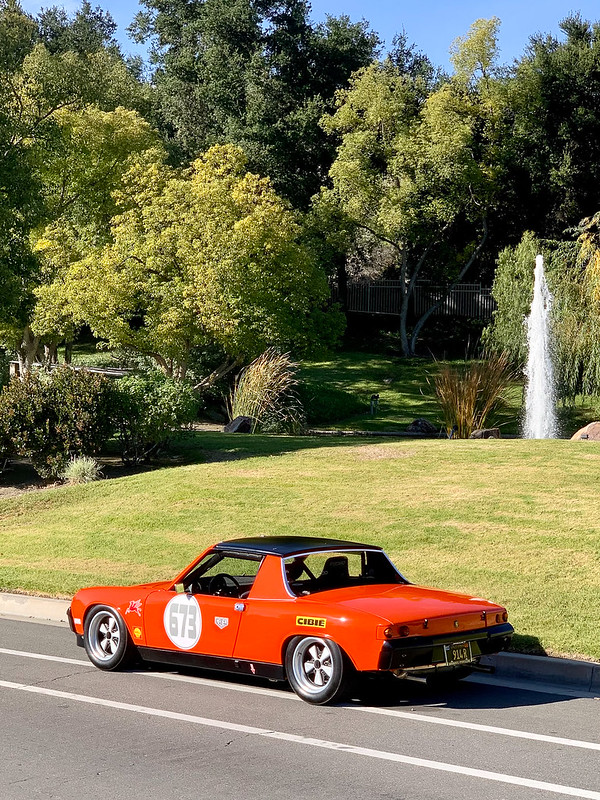

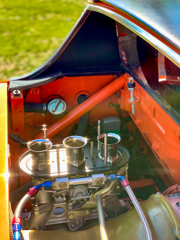

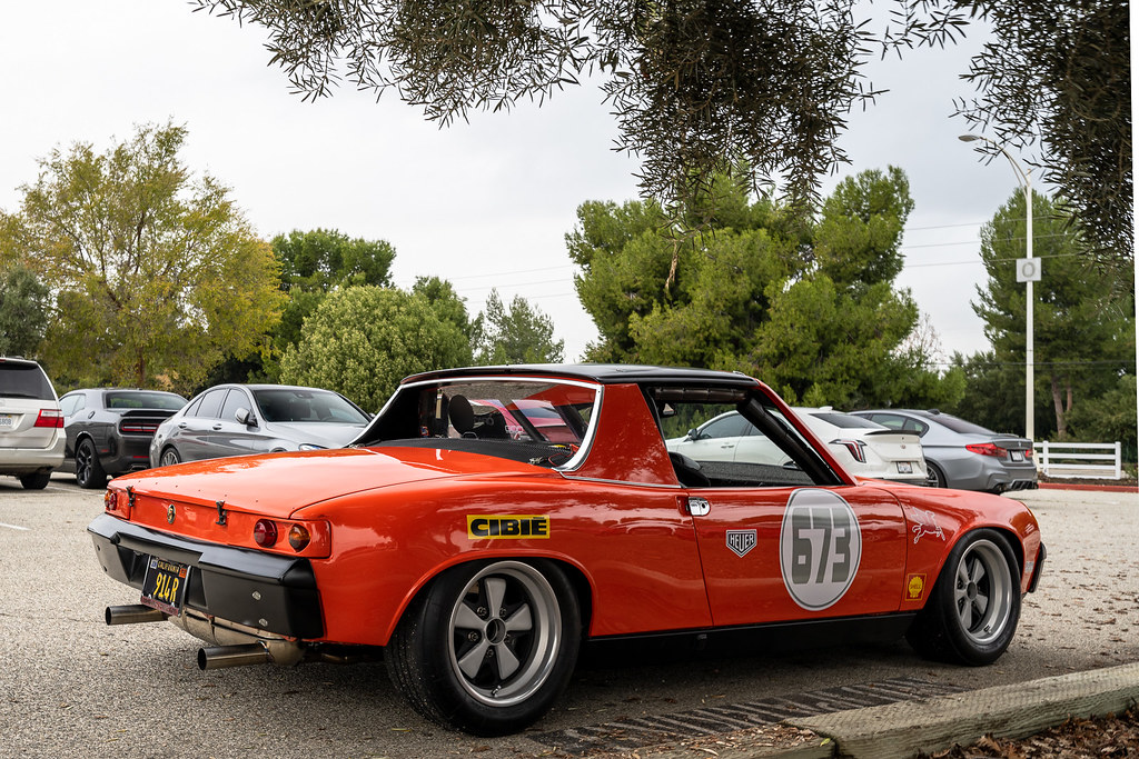

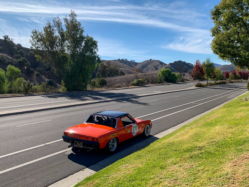

Woohoo, I've been chipping away at my long to-do list and the car is running well (again) now. One challenge since the trans rebuild has been gunk in the fuel system from the old fuel cell that had pretty well disintegrated and from the car sitting too long. I think I finally got that cleared up. Had been thinking it was running horribly due to the new exhaust, but that didn't totally make sense since it should not be much different in flow/backpressure vs what I ran before. Sure enough it was mainly or entirely the Weber jets being clogged and possibly some inferior/fouled gas.
Some fresh pics! I just put some new decals on, and brought it out to the PCA unStock show a couple weekends ago. I plan to bring it to Motor4Toys at Pierce College this Sunday as well.
(IMG:http://www.914world.com/bbs2/uploads_offsite/live.staticflickr.com-21-1669842176.1.jpg)
(IMG:http://www.914world.com/bbs2/uploads_offsite/live.staticflickr.com-21-1669842176.2.jpg)
(IMG:http://www.914world.com/bbs2/uploads_offsite/live.staticflickr.com-21-1669842176.3.jpg)
(IMG:http://www.914world.com/bbs2/uploads_offsite/live.staticflickr.com-21-1669842176.4.jpg)

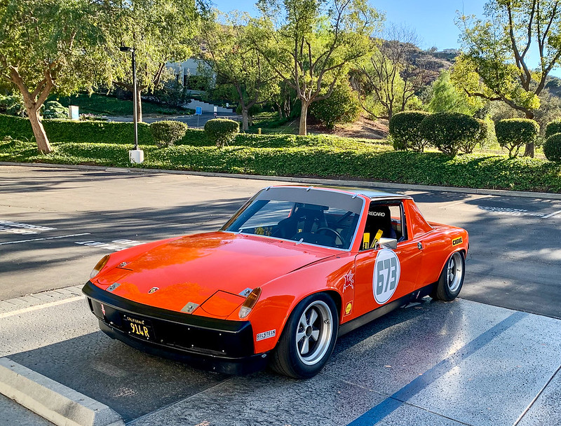

Made it to Motor4Toys on Sunday - the car is running extremely well now but alas the engine will need to come apart again someday for an oil leak.
I need to finish the new fire system installation soon and aim to potentially get out to Streets of Willow in January, which would be my first track event since late 2018. I "just" need some new race tires and trailer tires too... merry xmas to me lol
(IMG:http://www.914world.com/bbs2/uploads_offsite/live.staticflickr.com-21-1670460046.1.jpg)

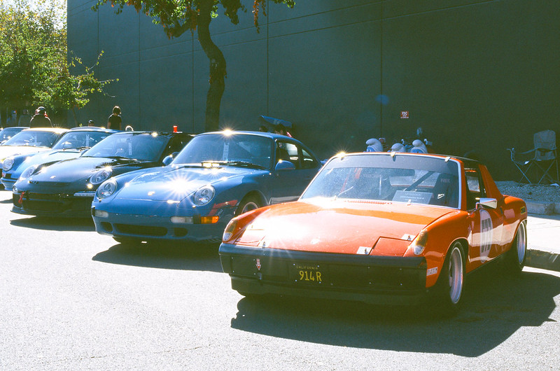

Thanks! Been a bad summer for cars. Just had to rebuild the AC on my truck, the trans and rear brakes on my son's Land Cruiser, fix rodent damage and other crap on my 997, and now this!
Here's a film shot from last year's PCA ünStock show. I signed up my 997 this year as it's way too far to drive my 914...
(IMG:http://www.914world.com/bbs2/uploads_offsite/live.staticflickr.com-21-1694975907.1.jpg)914R at PCA ünStock Show 2022 by Chris Campbell, on Flickr
