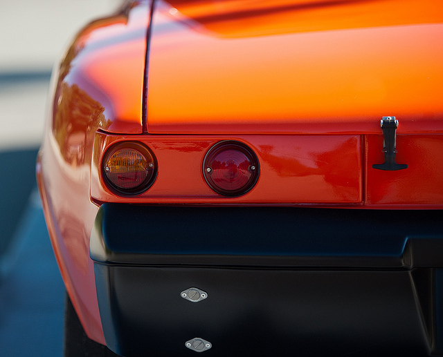

QUOTE(shuie @ Sep 12 2011, 07:54 AM) *
The car looks awesome. Those flares really look great.
It's probably covered in another thread, but where did you get the 911R rear decklid latches and the tail lights?
TIA
Thanks! The lids are from Getty Design but the tie-down latches are just commodity parts I got from Pegasus. Some guys prefer the real NOS parts for factory or true replica/tribute cars, and those turn up from time-to-time on the Early 911S Registry or Pelican classifieds.
I have the info on the "R" taillights at home but there are definitely some earlier threads here on that topic.
Note that the body shop had to extensively modify and re-fit the fiberglass housings as they were crude to start with. They also come "some assembly required" i.e. you have to wire everything up yourself. Therefore it's not an inexpensive mod and probably not one I would do again, but I think the result looks cool.
