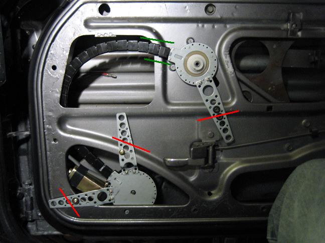

Pics Dr Evil's install:

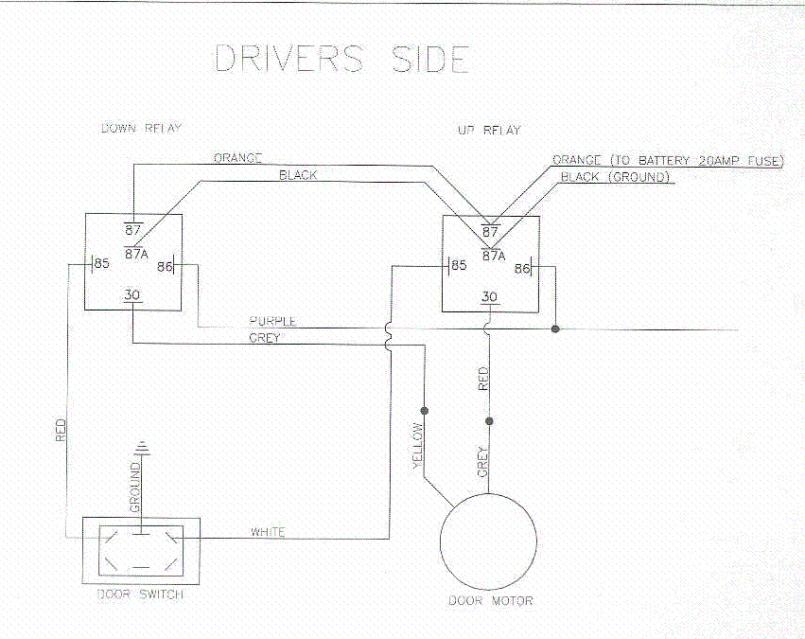

Pic of my install:
At first, the window up/down speed seemed slower than I expected. Subsequently, I installed reversing relays inside each door to get more power closer to the motors. The original power source was routed through the switches; now, the switches activate the reversing relays.
The only challenge, was making sure I had the proper adapter to fit onto the 914 winder. Otherwise, an easy project, and you can keep your eyes on the road while adjusting the windows/air flow

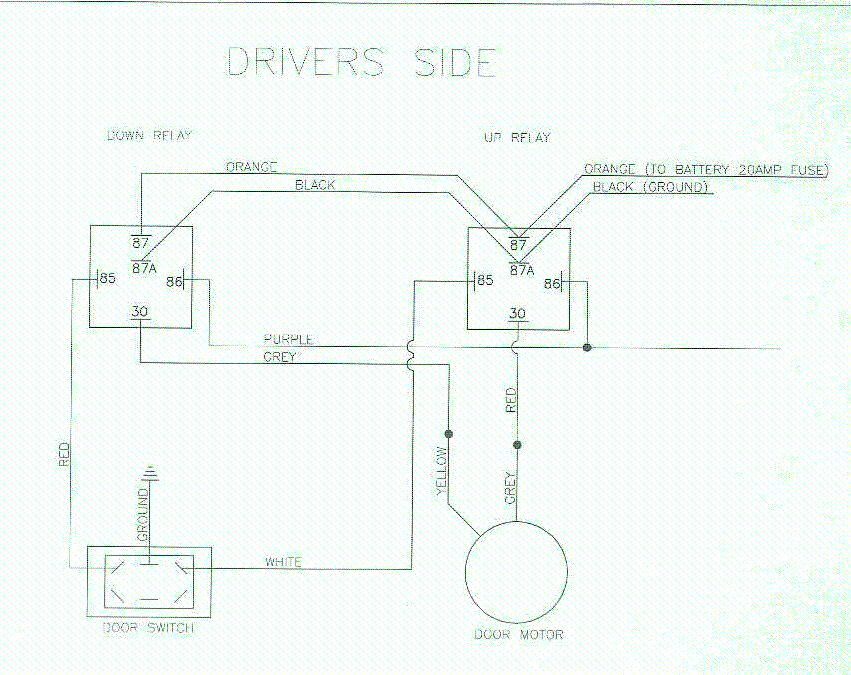

The reversing relays are the key; I had a 10 gauge wire running from the battery to a power amp in the front trunck already; so, I ended up with a plenty of power for the window motors. I would recommend making the window-lifting mechanism as free from friction as possible first, now that I've been through the install
Here's a pic of the reversing relay set up; it was pretty easy to do and they mounted easily in the door recess.

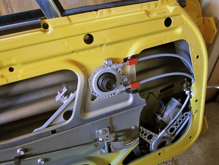

Here is a picture of the SPAL unit in my driver door:
Seems pretty strong and consistent so far.
