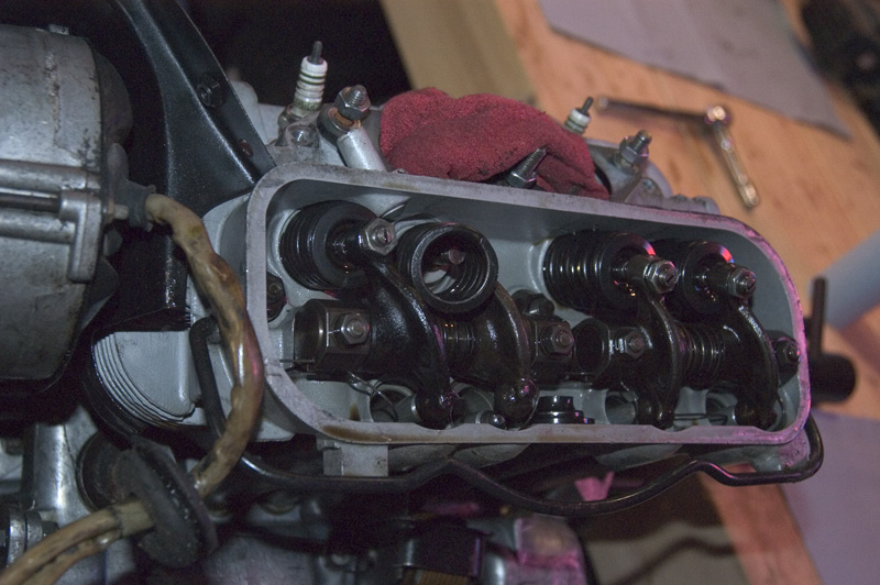

rocker arm is broken and the valve is no longer connected to the spring and it's associated hardware (IMG:style_emoticons/default/wacko.gif)

This is what I saw when the valve covers came off.
