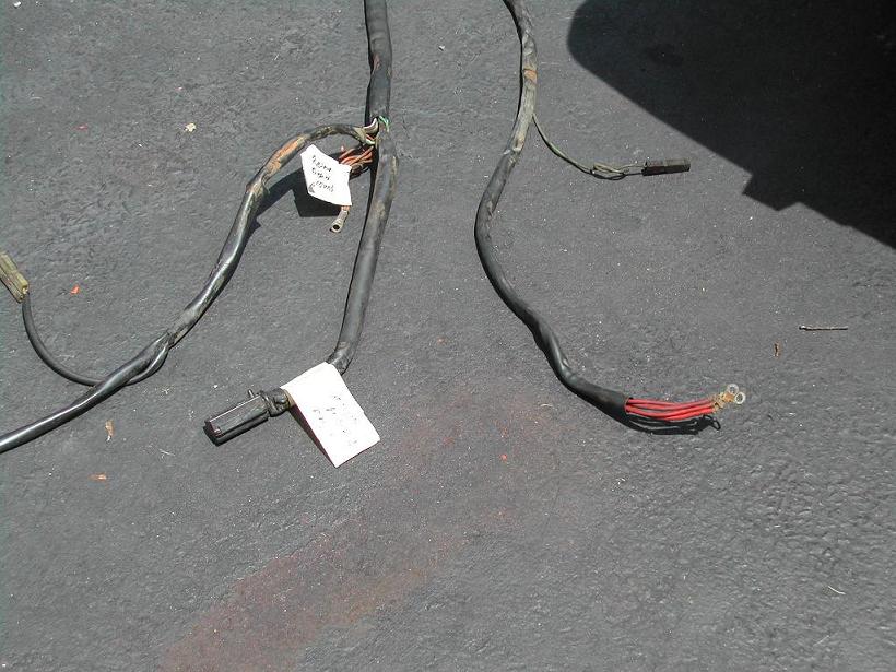

i need your help..i just got a wiring harness in the mail...and im trying to identify all the parts...i did a little..but i couldnt get far..im not very good at reading the wiring diagrams
so i took pictures of each part and im hoping you guys could possibly tell me where they go
i really appreciate all the help i can get

Step 1--buy yourself a Haynes manual and turn to the Wiring Diagrams section. (You can print diagrams out from Pelican's website, or from the PDF manuals available somehwere around here, but Haynes is pretty convenient and is less than $20--well worth it!)
First pic: The ring terminals go on the battery (+) clamp. The connector on the left goes on the relay board; can't see if it's the 12-pin connector at the right-rear or the 14-pin connector on the front of the board. If the latter, it's part of the main wiring harness for the whole car. Talk to Aaaaahndy about reinstalling the main harness.

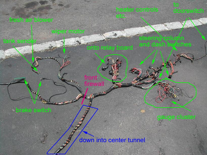

main section ...

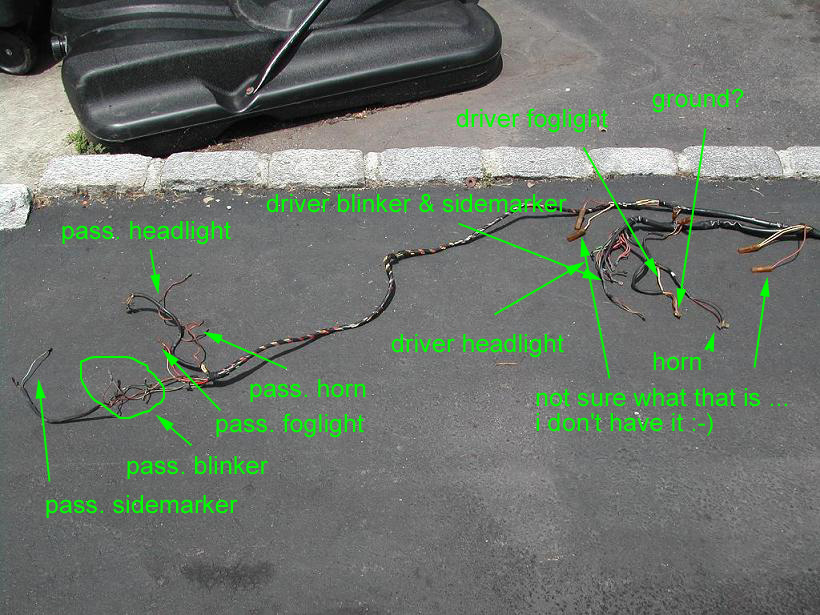

and the front ...
