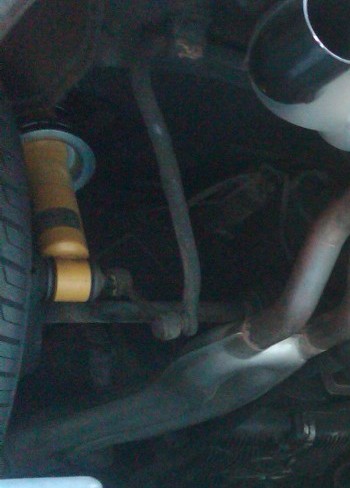

the shocks are adjustable in the location of the retention ring location for the spring, so you have a higher ride with morepressure sooner on the spring, or if it is lowered, then more demand on the shock,less on the spring and lower ride.
I have not gotten to the front. The back was bad old koni and weak springs.
The front is the next project. It feels good, but will atleast need the sway bar as zach said.

this was taken before i put the new sway bar bushings in but you can see the slots for changing the silver spring plate location, up on down.

With my perches set to the lowest position my ride height is close to stock in back...depending on where yours are currently set, you should be able to get about an inch drop by moving it down... Can't tell from the pic which setting you are on now.
