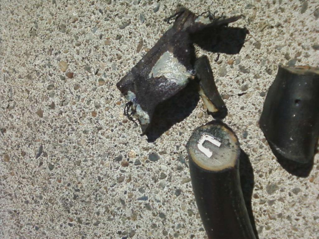

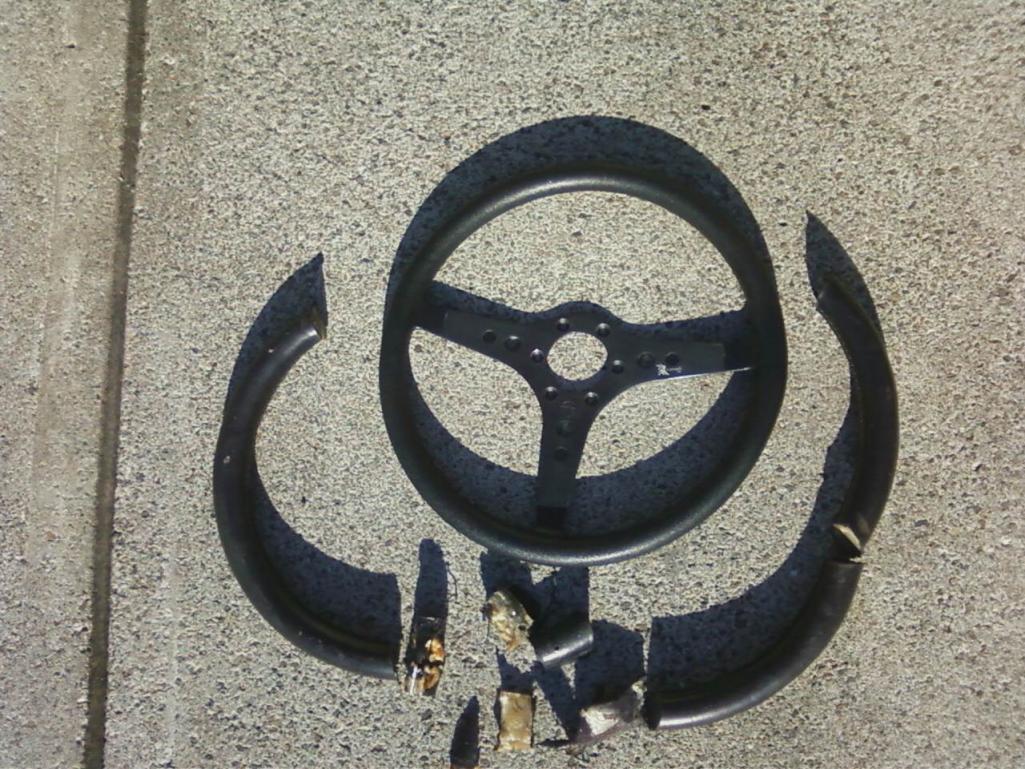

I have an Racemark steeering wheel , the leather is shot and seems to be bubbling something from inside out.
So I attaked it with a band saw. Strange inards, U shaped steel channel ,rivetted to the spokes and then coated with a rubber like goo.

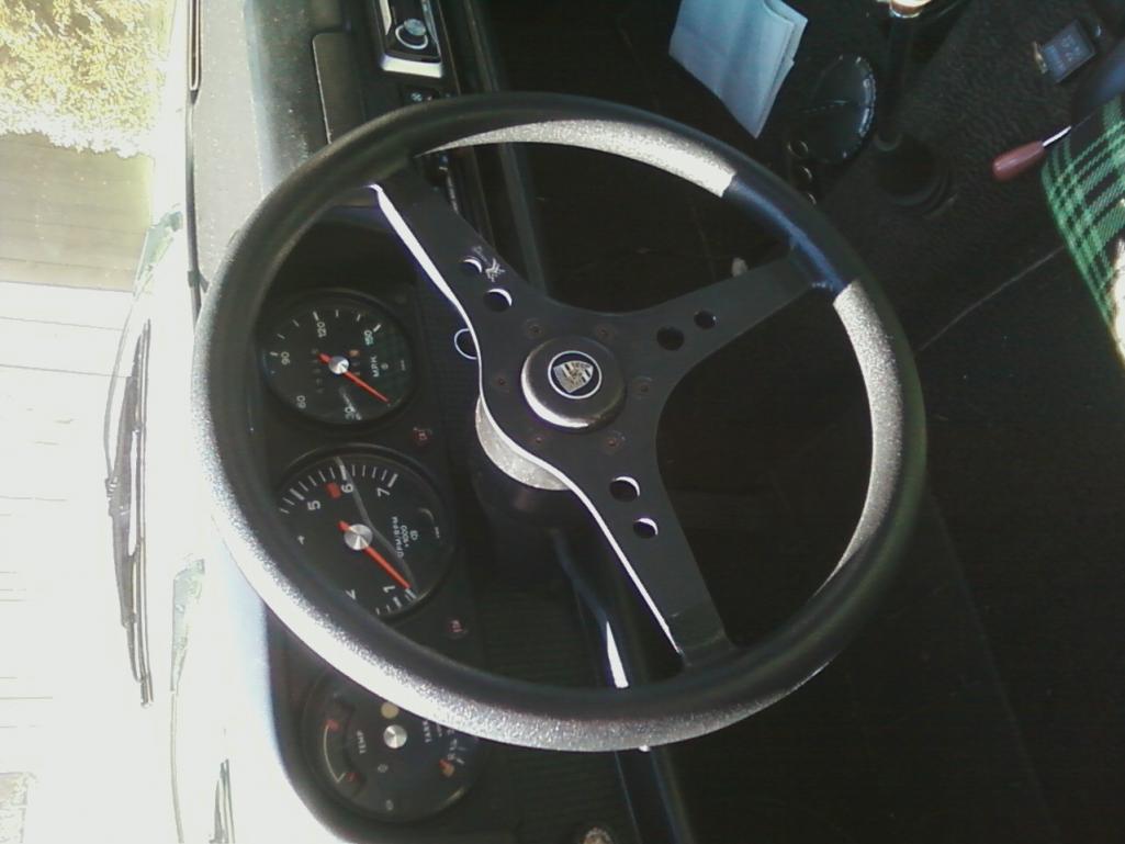

I like my 370mm prottipo in my GT, so I decied to make my Racemark 370mm
Rolled a piece of 6061 al 1.05 dia. to 370mm and welded it to the spokes.

So you rebuilt your wheel (IMG:style_emoticons/default/w00t.gif) and it looks very good in pix..

I searched everyware for Corinthian leather, No luck.
http://en.wikipedia.org/wiki/Corinthian_leather
So off to the auto parts store, and found , gheto swade.
Otherwise known as spray bedliner.
looks and feels fine for my driver.
racerbvd
post Jul 23 2011, 12:19 PM
Posts: 2,375
Joined: 3-February 03
From: Sunny FL.
Member No.: 226
So that is one big steel ring??? You will want to find some type of cover as it will burn your hands when you leave it parked in the sun.. Still, pretty cool, what does it weigh??
sixnotfour
post Jul 23 2011, 12:23 PM
Posts: 11,060
Joined: 12-September 04
Member No.: 2,744
Its an aluminum tube . It is way lighter than the way it was. If I like it I am thinking about trying to stich up a leather cover .
In WA state i dont really have to worry about to much sun.

It looks freakin great (IMG:style_emoticons/default/w00t.gif) !!! because of the thin spokes your steering wheel would be a perfect candidate for 'wheelskins' leather covering!! They sell them on ebay in whatever color, grip and overall diameter!
http://www.ebay.com/itm/Porsche-Cayman-Whe...=item256de2ec6b
rick 918-S
post Apr 16 2012, 06:24 PM
Hey nice rack! -Celette
Posts: 21,140
From: Now in Superior WI
Member No.: 43
How did you attach the aluminum tube to the steel center?
gothspeed
post Apr 16 2012, 06:59 PM
Posts: 1,539
Joined: 3-February 09
From: SoCal
Member No.: 10,019
^^ I think the center tri-spoke was aluminum too, welded together (IMG:style_emoticons/default/smile.gif)
