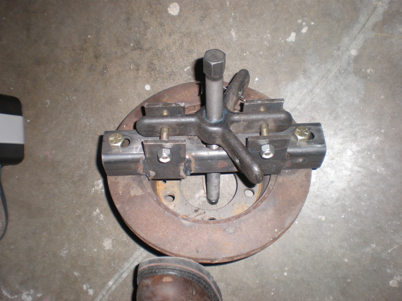

After I pounded on the rear swing arm a bit and thought about all that vibration going through the car,
Me too. I made this puller from the parts in the photo. Works like a champ and no damaging shock to the suspension or the pick-up points. Not mention it's quick too. Attached Image

As you know from my other post, I'm in the middle of this also. My son showed me the slide hammer trick using a sledge hammer and length of chain. It worked but really shook the hell out of the trailing arm & whole car. Ham's method shown above is far preferable....

QUOTE(HAM Inc @ Jul 25 2011, 06:33 AM) *
I like it. Wish I had kept my old rotors... (IMG:style_emoticons/default/smile.gif)

QUOTE(HAM Inc @ Jul 25 2011, 09:33 AM) *
OK, Len, how does it work? It's not obvious to me.

QUOTE(John Jentz @ Jul 25 2011, 09:30 PM) *
I also used a puller. But it was a stock 3-prong cheap one, I don't know why
you would need to make your own.
It works only if the axle is still attached. Try to have the axle level when doing
the pulling.
