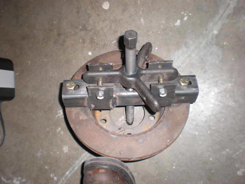

After I pounded on the rear swing arm a bit and thought about all that vibration going through the car,
Me too. I made this puller from the parts in the photo. Works like a champ and no damaging shock to the suspension or the pick-up points. Not mention it's quick too. Click to view attachment

As you know from my other post, I'm in the middle of this also. My son showed me the slide hammer trick using a sledge hammer and length of chain. It worked but really shook the hell out of the trailing arm & whole car. Ham's method shown above is far preferable....
OK, Len, how does it work? It's not obvious to me.
I also used a puller. But it was a stock 3-prong cheap one, I don't know why
you would need to make your own.
It works only if the axle is still attached. Try to have the axle level when doing
the pulling.
