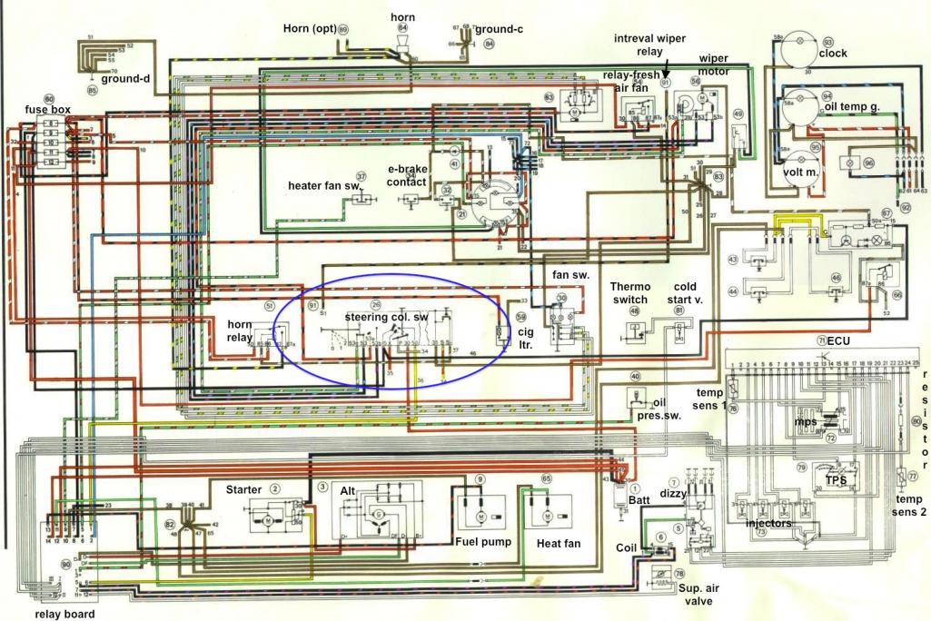

Oh God, I'm going to get flamed for bringing up and old thread.... but I'm curious anyone can fill in the rest of the diagram from the OP? I would like to know what each of the terminals on the ignition switch is for as I'm re-wiring my car with a cutoff switch, master ignition on, and starter button. I could not find the actual switch in the wiring diagram for a 1973 (which is what my car is). Thanks for you help!
-George
Bob L.
post Feb 10 2013, 08:27 PM
Posts: 851
Joined: 7-August 11
From: Austin TX
Member No.: 13,411
there it is...
I got tired of looking back and forth between the diagram and the legend.

By the way, does anybody know which of the 2 temp sensors in the lower right of the diagram(FI harness) is the oil temp sensor (in the taco plate)?
JeffBowlsby
post Feb 10 2013, 11:19 PM
Posts: 9,386
Joined: 7-January 03
From: San Ramon CA
Member No.: 104
Temp sensor 2 is the cyl head temp sensor. THe poil temp sensor is not in the FI harness. Its a green/black wire and varies on location depending on model year.

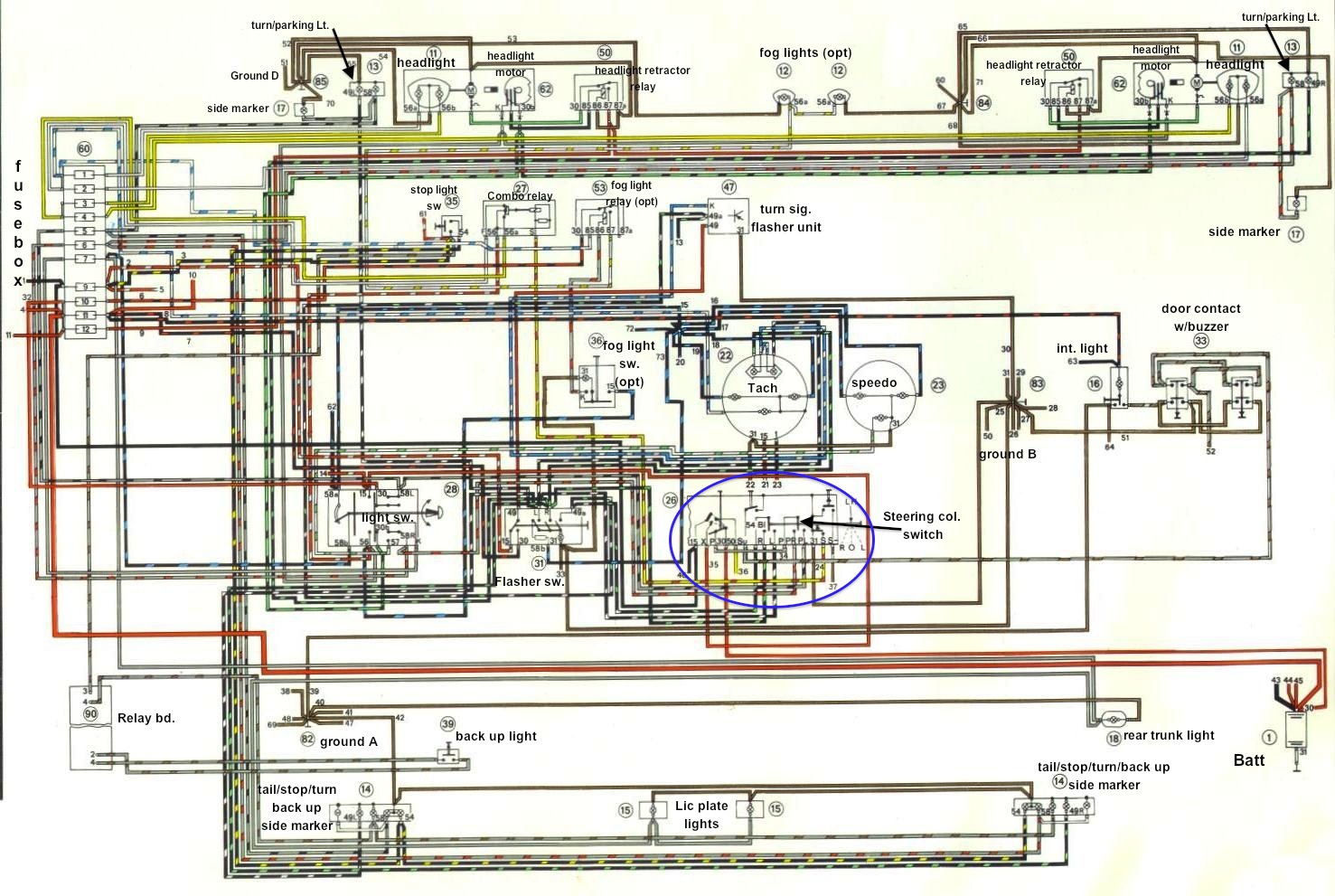

Well, I have a '73 that I'm trying to wire a '76 2.0 into. Soooo.....?
Bob L.
post Feb 12 2013, 01:14 AM
Posts: 851
Joined: 7-August 11
From: Austin TX
Member No.: 13,411
Found it on Part 1 of the diagram as well.
