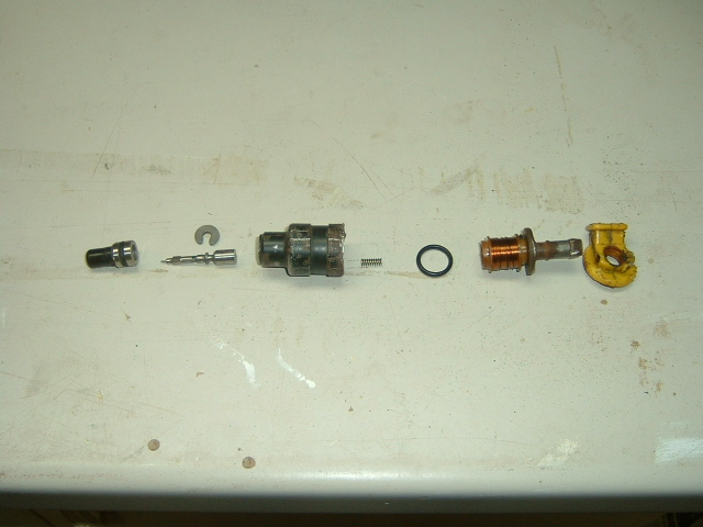

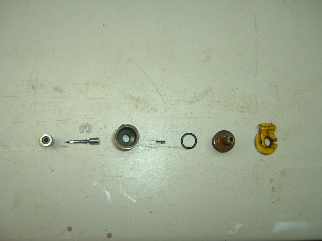

Fuel leaking out of the injector, (into the engine compartment) is the internal O-rings leaking. They cannot be fixed. If they were left dry for some time they may only leak for a while until the rubber softens up, but I would replace the whole injector anyways. I just replaced 2 of them. Then do a leak test, into a test tube with all the injectors as described in this site and a crank test for calibration.
Fuel injection site
If not you risk running some cylinders too lean or too rick, or just have a constant leakdown diluting you oil.
Here is what an injector look like on the inside.

post Jul 1 2004, 10:14 AM
Canadian Member
Posts: 2,083
Joined: 15-January 03
From: Timmins, Ontario, Canada
Member No.: 153
Once taken apart you average man cannot put them back together.
