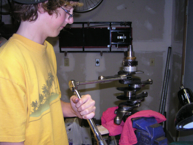

Gerry and I took on the connecting rods tonight. Lotsa fun, kind of a big model. We measured the bearing to journal clearance and all were .0015" and rod side clearance was .012 to .014 on the 4 rods.
Here's Gerry torquing down the rod bolts on #2

Jake Raby   Looks like you are doing it right.... The plastig...   Jun 30 2004, 01:01 AM

Lawrence   Very meticulous... clean and check everything, eve...   Jun 30 2004, 01:45 AM
DNHunt   Jake I was pretty sure you did all that but chec...   Jun 30 2004, 06:34 AM
newdeal2   I see an extension on the tourque wrench...is that...   Jun 30 2004, 06:59 AM
DNHunt   Yep, but not the way he's holding the wrench. ...   Jun 30 2004, 07:06 AM
newdeal2   I'm a stickler for detail and about to get int...   Jun 30 2004, 07:14 AM
Jake Raby   Double checking is good... ALWAYS.. I design and e...   Jun 30 2004, 07:34 AM
