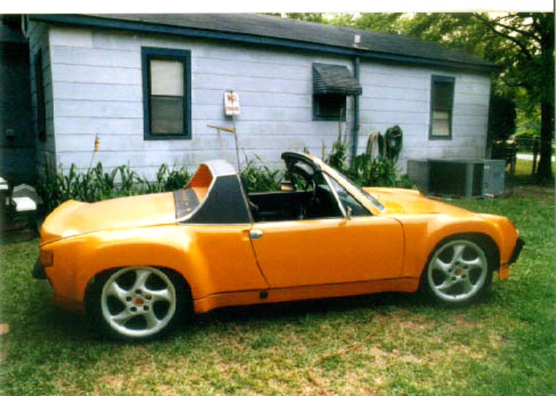

Here's an old pic on my 6r.
Front wheels are 18x8,no spacers,just the 914/6 hubs.
Rears are 18x10,2" spacers,and req'd 11"wide flares to cover'em.
Now that repo flares are available at a reasonable price I'll sooner or later ditch the fibro-flares and redo the body so it's all steel.
Ron
