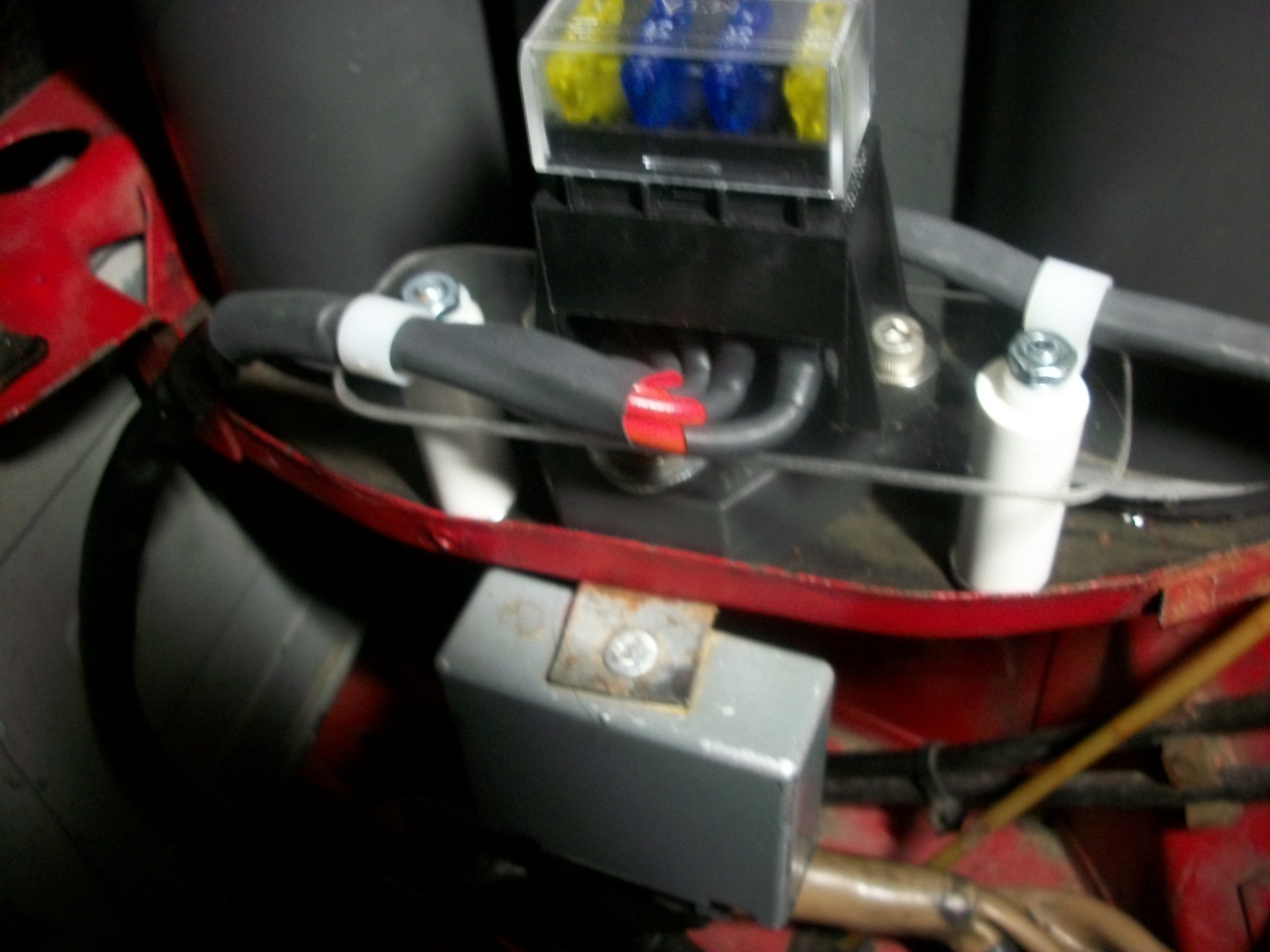

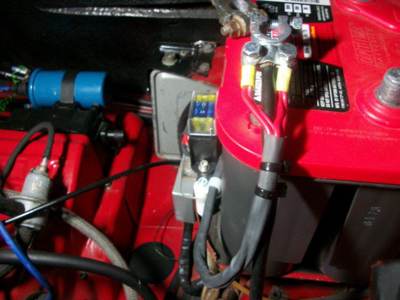

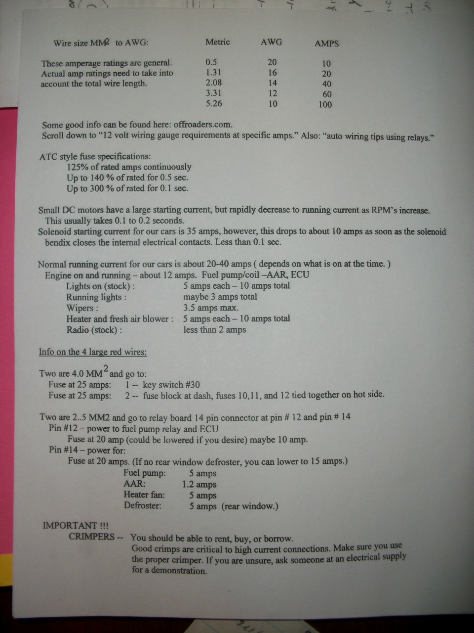

I won't be providing these kits any longer. I apologize to the members who have been waiting. Please feel free to use any info in the thread to help you come up with a fuse solution that meets your individual needs. Parts list on last page.
Tom
NEW INFO FOR EARLY CARS. THEY CAME WITH ONLY THREE RED WIRES!! Two 4.0mm and a much larger wire running forward to the dash area. Please check before ordering.
Last round this summer. Maybe next winter I will do this again if there is a demand.

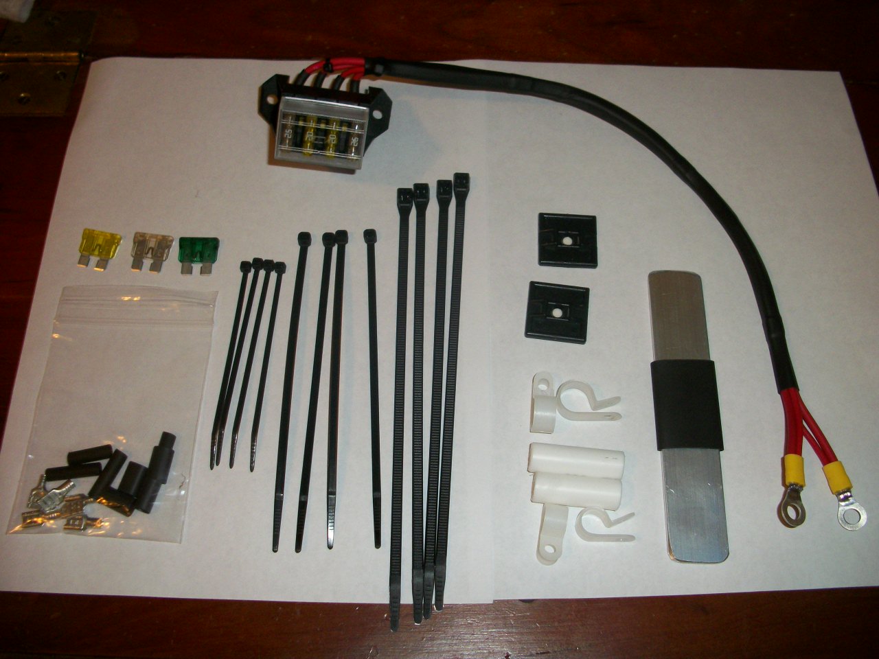

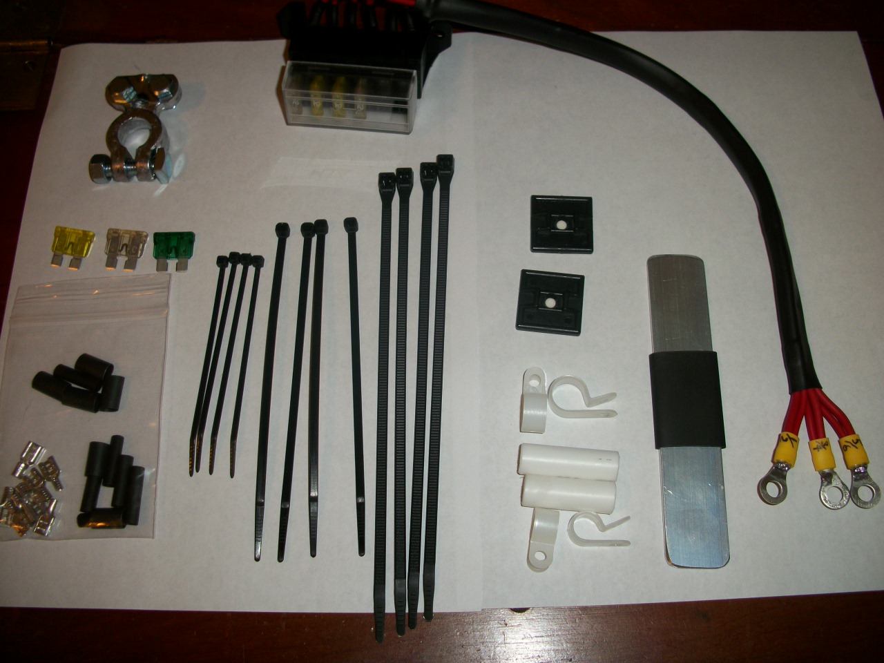

See pics of the new 4-way and 6-way kits, and the completed install of mine. Kits are designed to go on the outer edge of the battery box, however some have mounted elsewhere. If you have need for longer wires so you can mount yours differently, let me know and we can make that work for you.

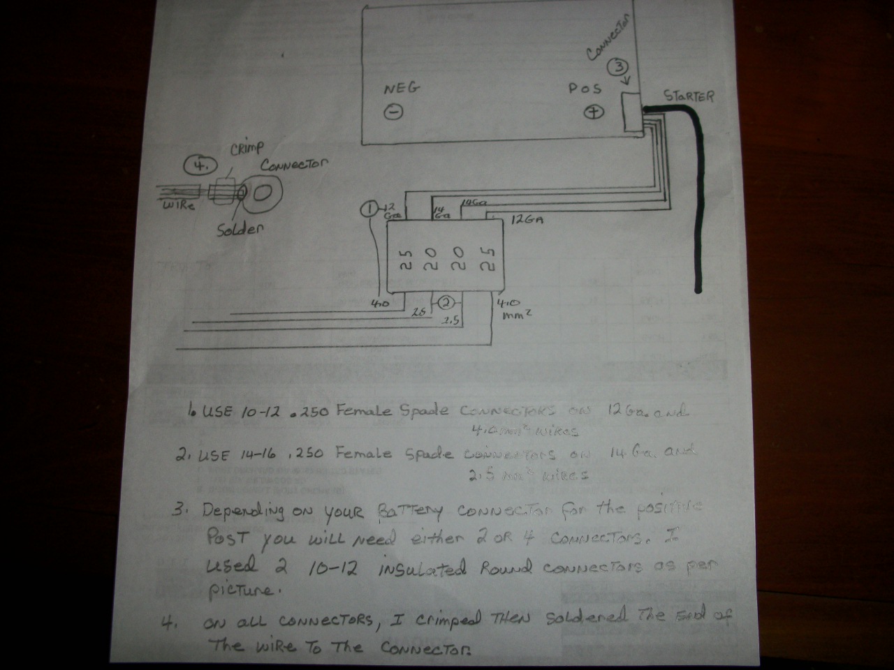

Also, please see the two pages of info below. You should be able to print copies.
From the supplier: 4/6 individually fused circuits with connections that enter and exit from the bottom allow this fuse block to be mounted in narrow locations. Clear plastic dust cover is included. Max load capacity for all circuits combined is 50 amps, 65 amps for the 6-way. Connections are made using 1/4" female push-on connectors.
I will open round four as I already have 3 folks who want one. There will be two models, a 4-way and a 6-way, and three stages; 1-basic, 2-connections on and soldered, 3 - with new battery connector.
4-way
stage 1- basic kit $25.00
stage 2- connectors on and soldered and harness heat shrinked $30.00
stage 3- With new battery connector $32.00
6-way
stage 1- basic kit $30.00
stage 2- connectors on and soldered and harness heat shrinked $35.00
stage 3- With new battery connector add $37.00
I will leave this open until 5 June, them order parts. It looks from the last round that you can expect about a month to receive the kit. IE: if I order parts by 6 June, the kits will ship no later than 30 June.
Attached Image Attached Image Attached Image Attached Image Attached Image Attached Image

A member in Canada just had a fire last week. Fire originated at the 14 pin connector at the relay board. Probably damaged the wiring harness before he could get the batt disconnected. Wiring harness is pretty expensive and a fused red wire would have prevented that.
Fuses shouldn't have to be too big. Max capacity of stock alternator is 55 amps. I think each red wire fused at 25 amps would be sufficient. Do you think that would not be enough? Just trying to get the info needed to make a decision.

All the fuse box that Tom is proposing will protect are the two power leads from the battery to the relay board (pins 12 and 14) and the run to the forward power distribution box. In normal operation these extra fuse should never blow. But of course that is also true for any fuse in any car.
I do agree that care and maintenance should eliminate the need but ...
These connections are getting really old and the insulators are getting old. The risks are rising with time.
The cars are also being maintained by non-professionals who do make mistakes. Sometimes we have to protect the cars against ourselves.
So for a couple of bucks we can protect our expensive wiring harnesses. Not necessary but good insurance. As someone noted earlier, modern cars are being designed with the fuse box right next to the battery. The designers have learned about best practices over the years.
If nothing else the process is bringing to light the dangers of unfused power and people are learning to be careful.
