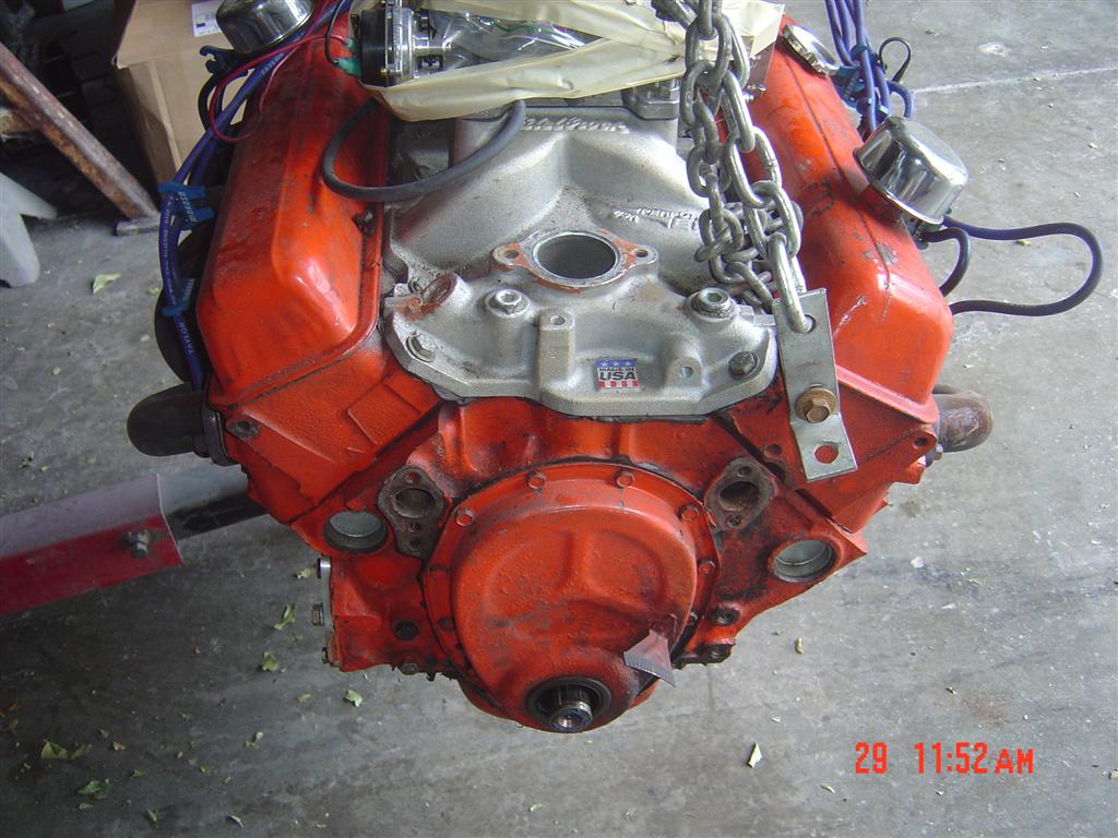

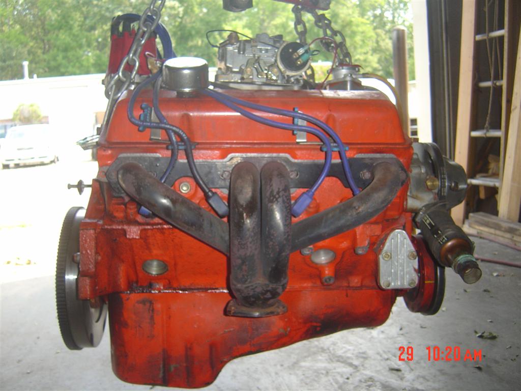

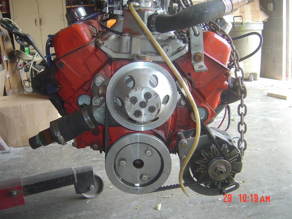

Jim dropped his car off to have me re-do the V8 ( 307 ) install he and Rod did a few years ago. This time around it will be getting the complete Renegade treatment, a new set of Dr. Sheas handi work. Elephant poly bronze bushings, sway bars, 108 c.v.'s. Some BIG ass sway away axles, and a lot of cleaning / detailing. I got started last friday pulling the engine and trans at the last minute before leaving for Matts party. Dr. Evil was going to do a quilie rebuild prior to the party's start. Once we opened up the box, the truth became known. Unfortunaely Jim's intermediate plate was shot. One of the worst Mikes has seen, so Mike took the stack back home to install a good plate, and do the gear swapping. I got to the shop today to find most of the area was tornm to shreds from Irene, so without power or water I couldn't do much other than tear the engine most of the way down. No way to get the flywheel ff until I have power back on so I can' mount it on an engine stand yet (IMG:style_emoticons/default/sad.gif) I was in such a rush on friday I didn't get any pics of the whole car so you'll just have to deal with what I took today (IMG:style_emoticons/default/biggrin.gif)
