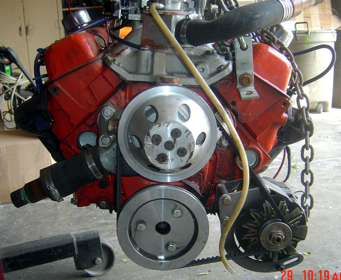

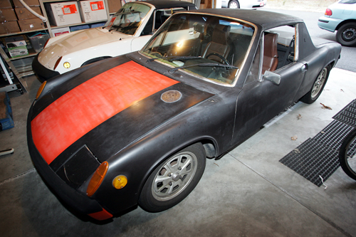

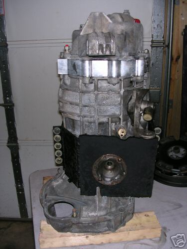

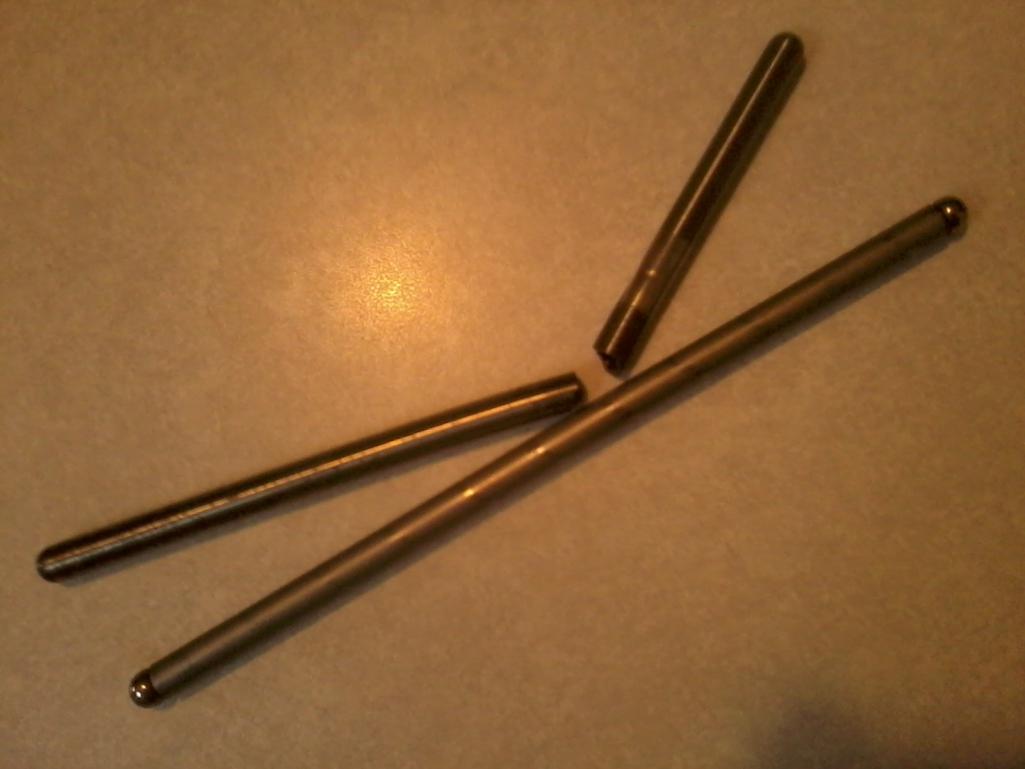

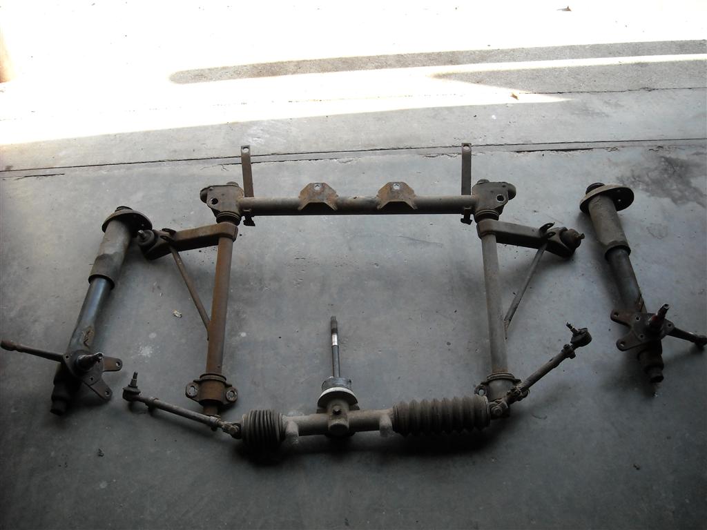

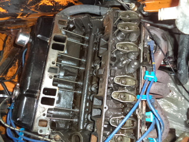

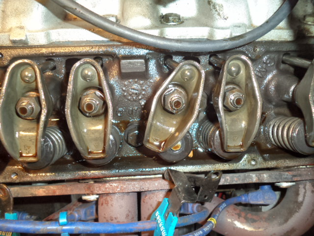

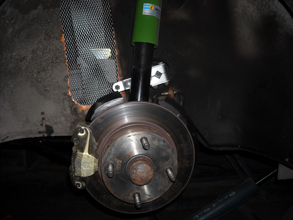

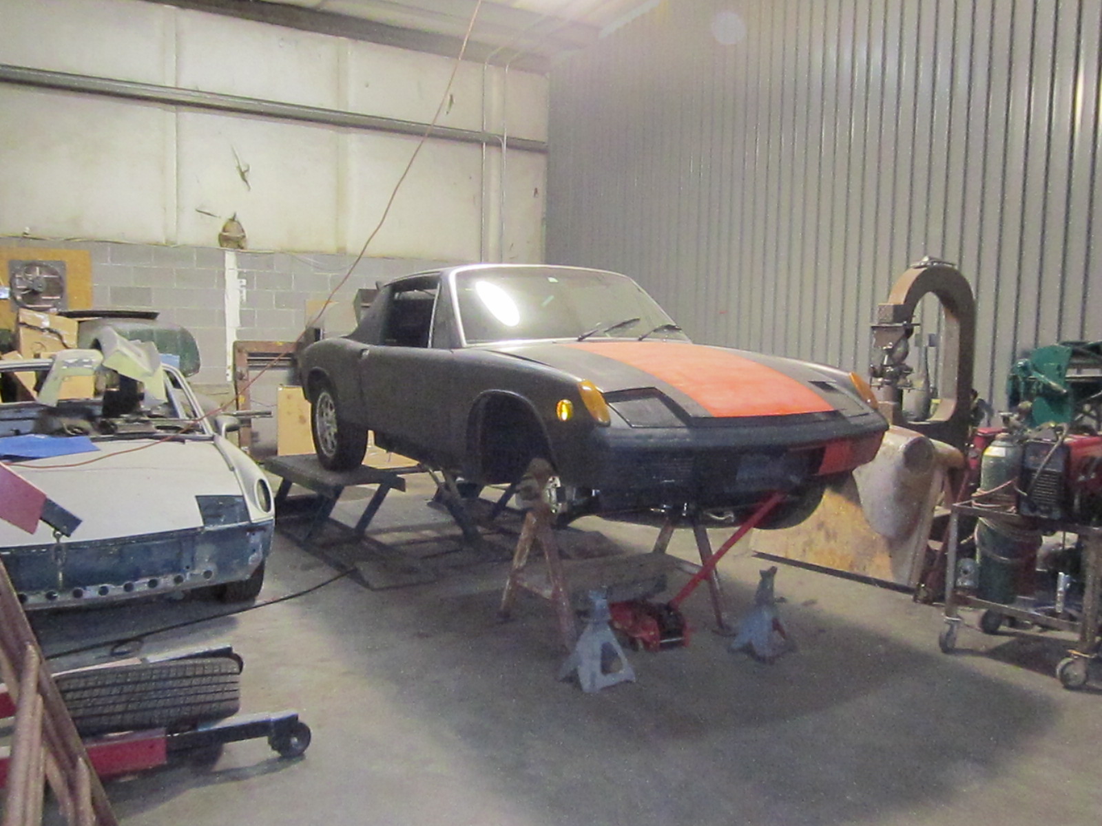

Jim dropped his car off to have me re-do the V8 ( 307 ) install he and Rod did a few years ago. This time around it will be getting the complete Renegade treatment, a new set of Dr. Sheas handi work. Elephant poly bronze bushings, sway bars, 108 c.v.'s. Some BIG ass sway away axles, and a lot of cleaning / detailing. I got started last friday pulling the engine and trans at the last minute before leaving for Matts party. Dr. Evil was going to do a quilie rebuild prior to the party's start. Once we opened up the box, the truth became known. Unfortunaely Jim's intermediate plate was shot. One of the worst Mikes has seen, so Mike took the stack back home to install a good plate, and do the gear swapping. I got to the shop today to find most of the area was tornm to shreds from Irene, so without power or water I couldn't do much other than tear the engine most of the way down. No way to get the flywheel ff until I have power back on so I can' mount it on an engine stand yet (IMG:style_emoticons/default/sad.gif) I was in such a rush on friday I didn't get any pics of the whole car so you'll just have to deal with what I took today (IMG:style_emoticons/default/biggrin.gif)
I must say, this car IMHO has the PERFECT amount of horsepower. Enought to smoke the tires for the redneck in all of us, BUT it is very controlable, and can take off from a dead stop without lighting the rubber up. BOLTS in a straight line and still hangs onto the apex like a 914 should and sounds like a mythological beast in heat. This is the best of both worlds (IMG:style_emoticons/default/aktion035.gif) I am hooked (IMG:style_emoticons/default/biggrin.gif)

Dr Evil   Tranz is 75-80lbs. I lighten the tranz a little ;)   Aug 29 2011, 07:48 PM

Dr Evil   Aftermarket bearing plate is snake oil. The trans ...   Aug 30 2011, 05:39 PM
jimkelly   really - i did not do any hard launches - at worst...   Aug 30 2011, 05:49 PM

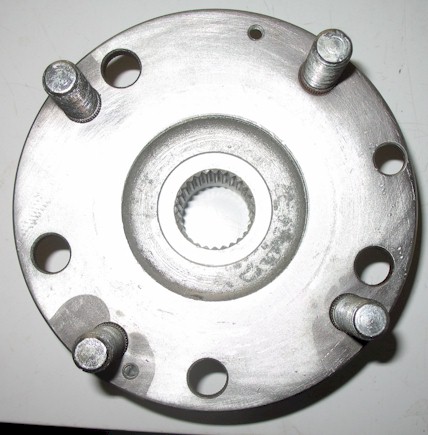

Eric_Shea   You know how most people drill 914-4 hubs to 5-lug...   Aug 31 2011, 09:50 AM
jimkelly   just come right out and say it : ) JIM HAS ISSUES...   Aug 31 2011, 09:54 AM

Eric_Shea   Not at all... I think you've got yourself a ...   Aug 31 2011, 01:42 PM

Ductech   Eric you crack me up. four lug from five lug :lol4...   Aug 31 2011, 02:19 PM

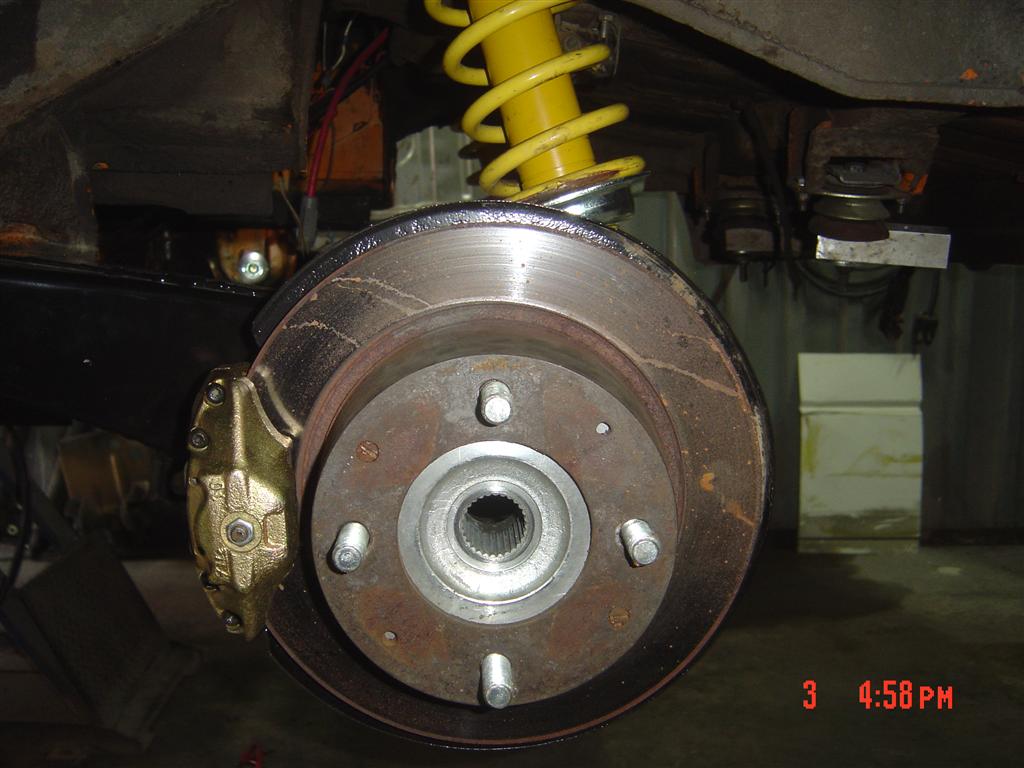

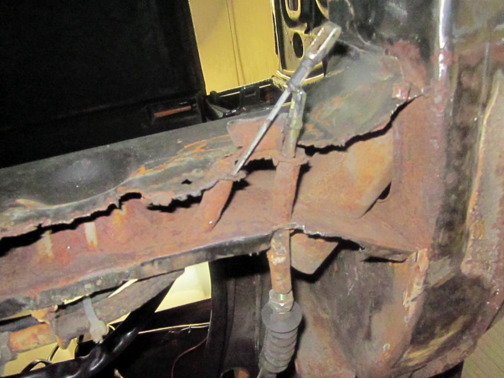

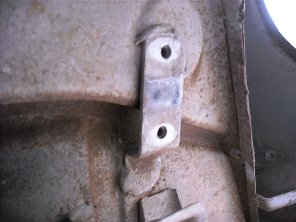

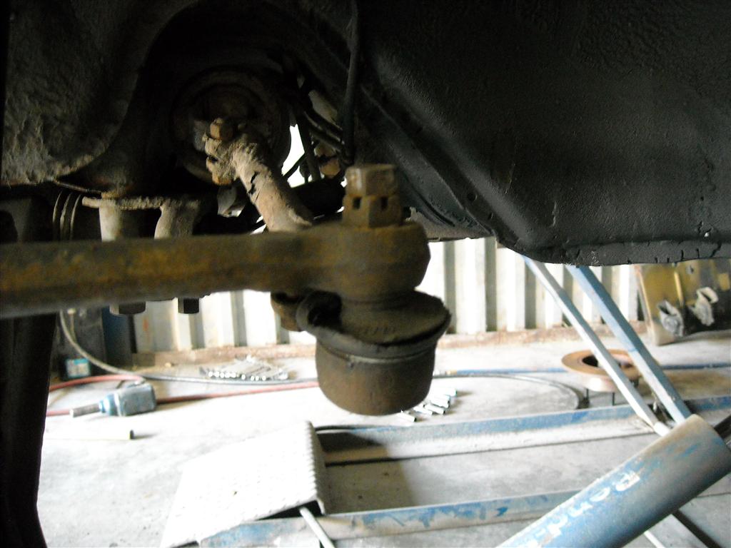

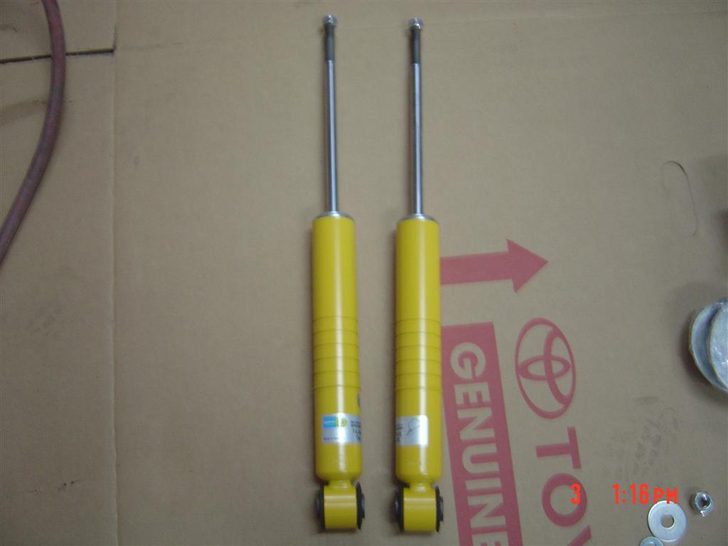

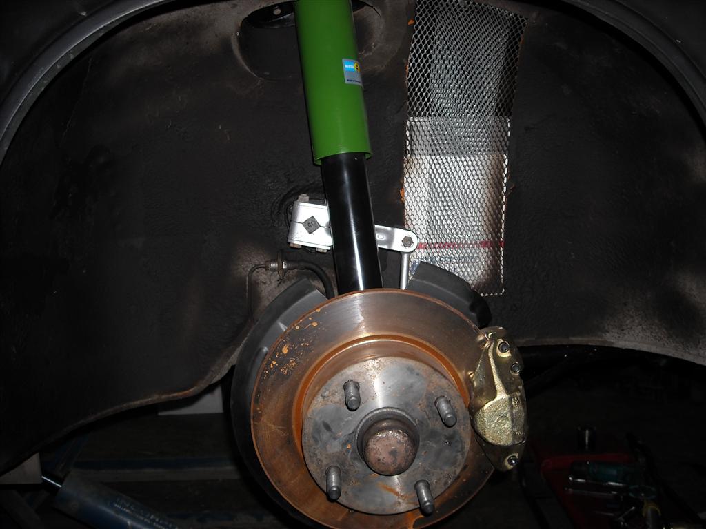

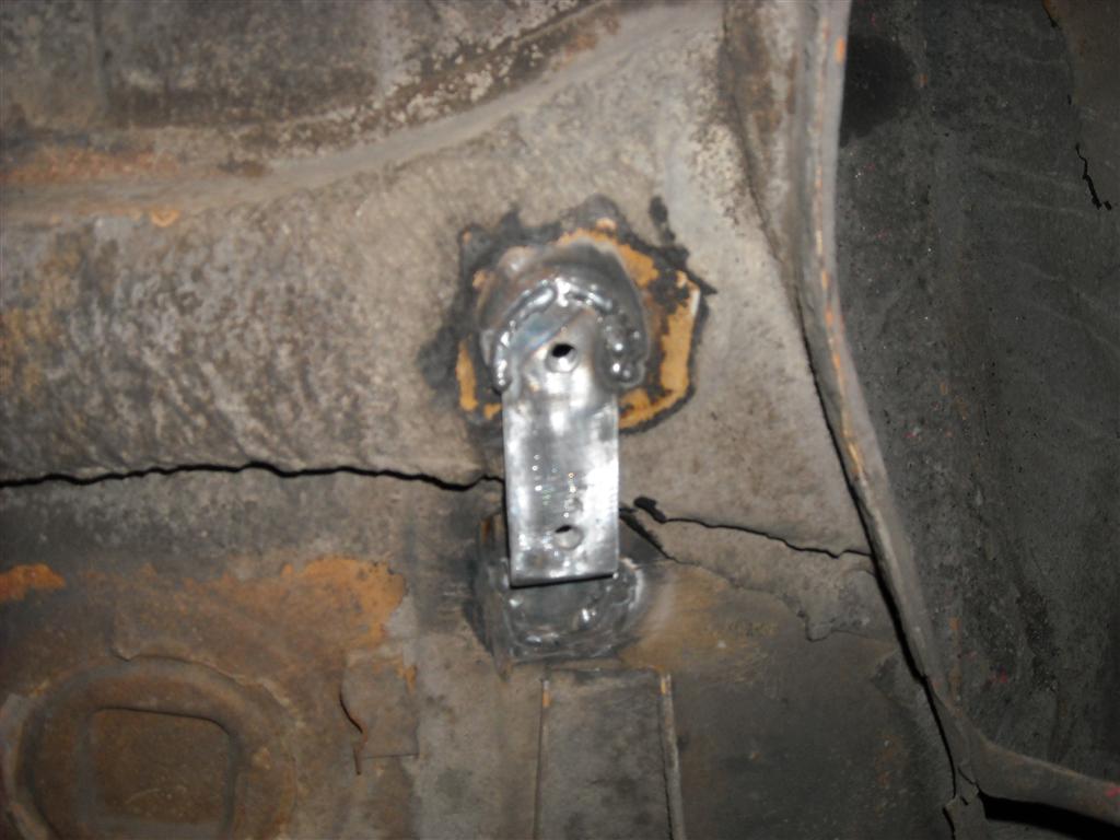

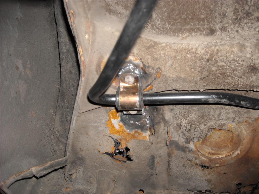

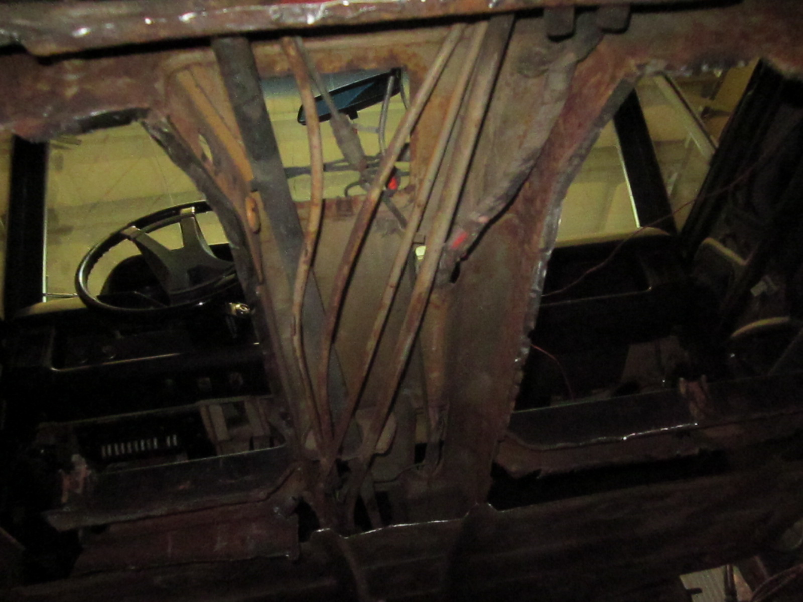

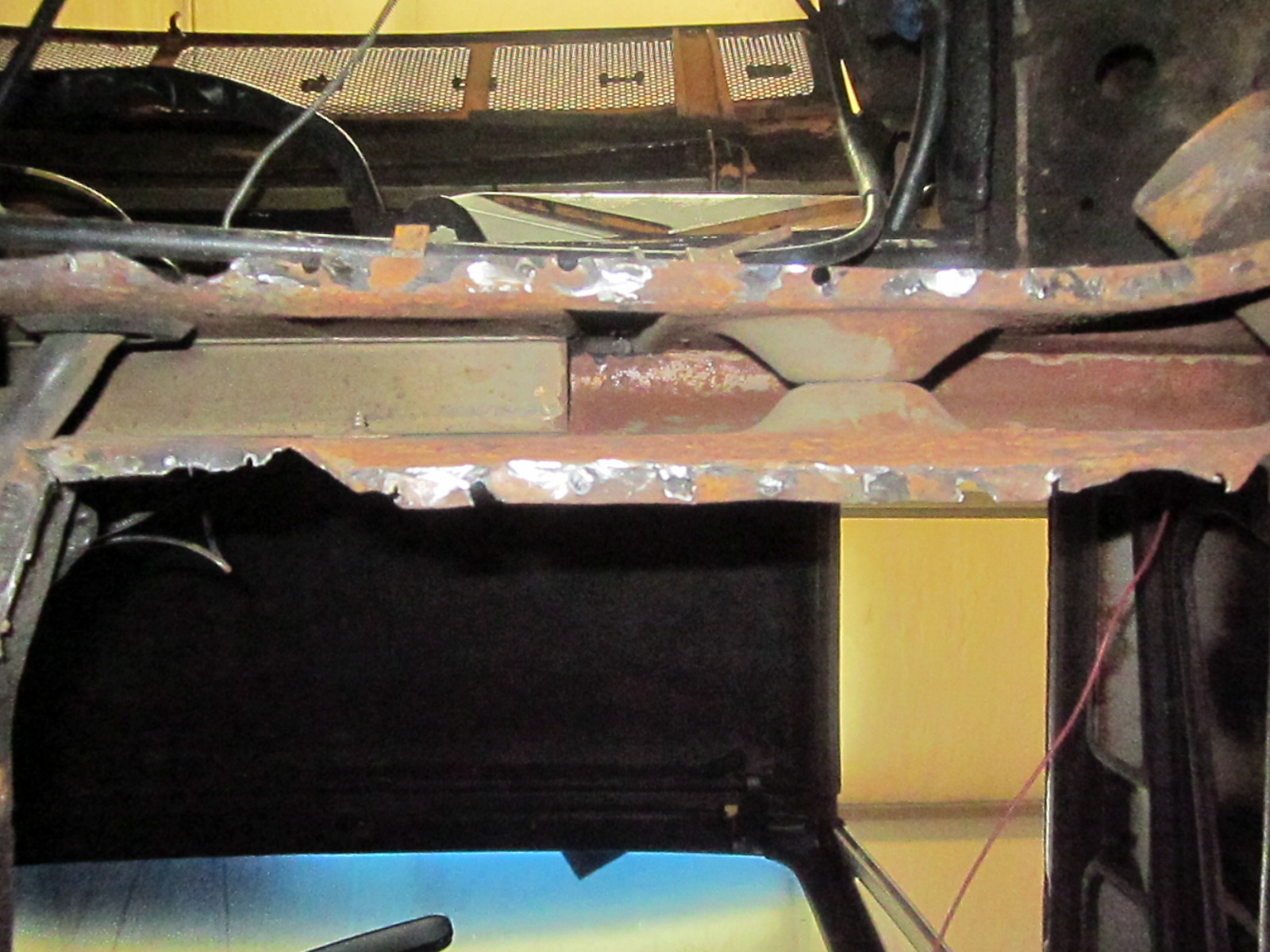

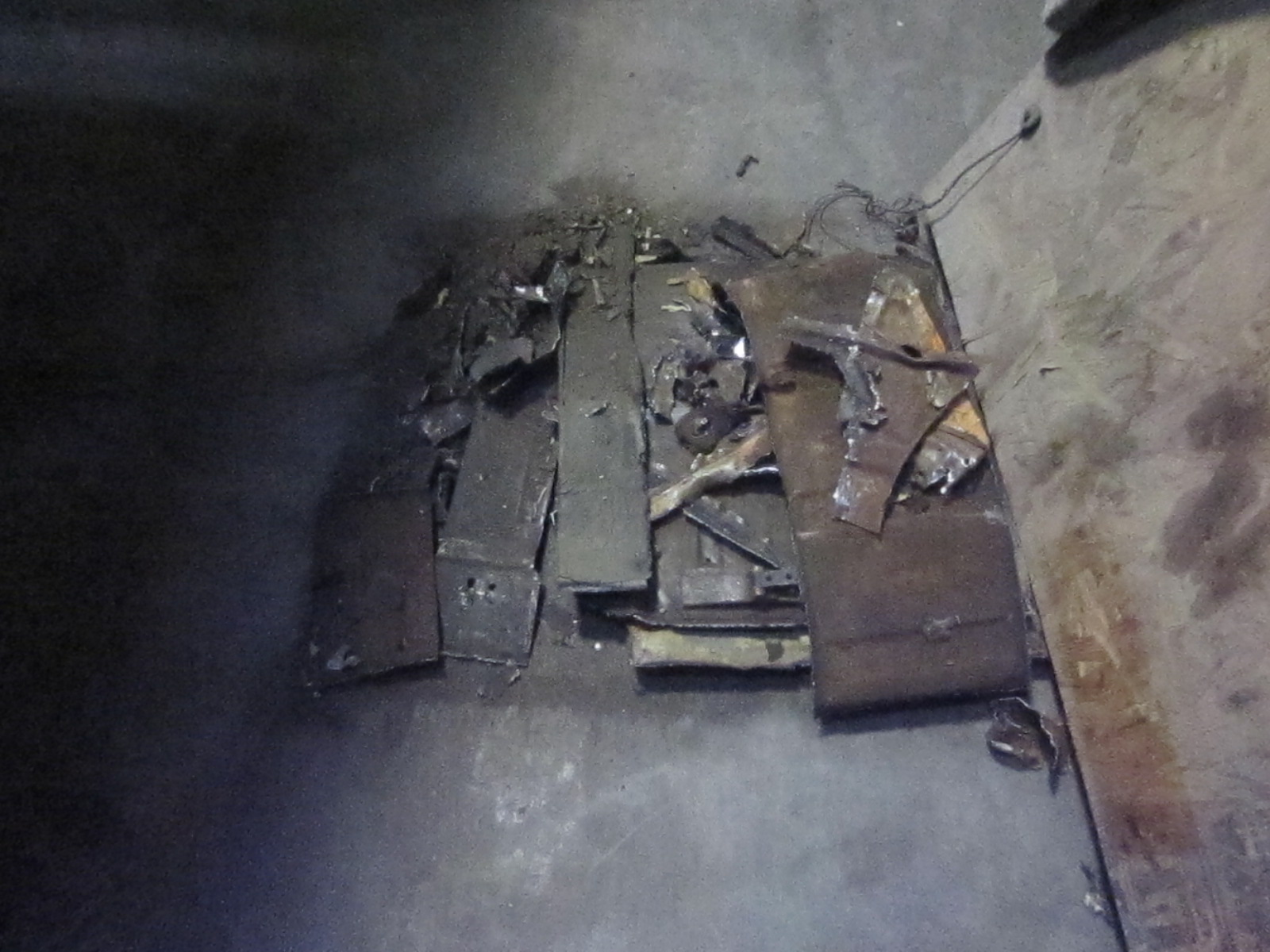

scotty b   So onto the latest :headbang: EVERY oneof the inn...   Sep 6 2011, 06:59 PM

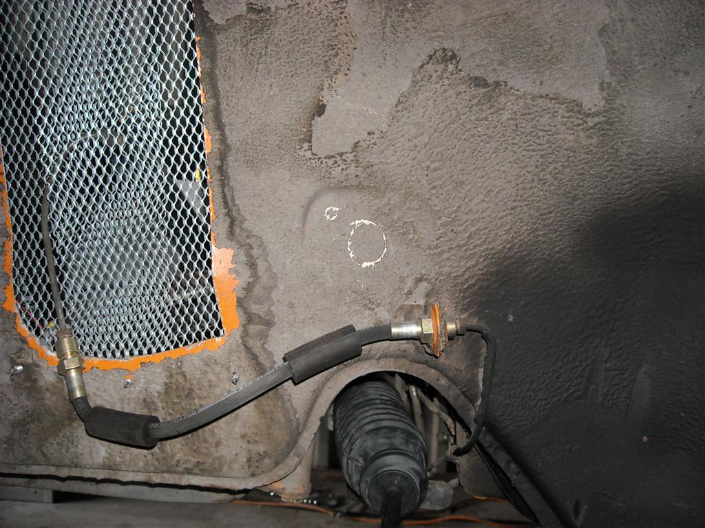

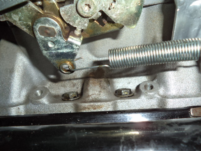

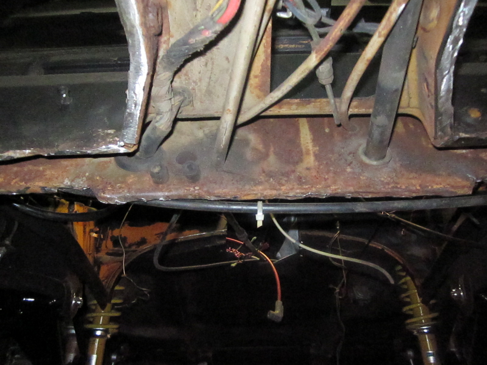

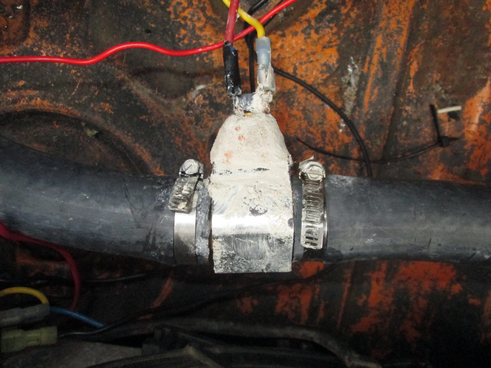

scotty b   Drained the gas tank and pulled it. found Jim...   Sep 6 2011, 07:09 PM
mepstein   Drained the gas tank and pulled it. found Jim...   Sep 6 2011, 07:29 PM
messix   those aren't springs theyre dampers   Sep 6 2011, 07:09 PM
scotty b   those aren't springs theyre dampers potato,...   Sep 6 2011, 07:25 PM
jimkelly   not sure what i am looking at - it appears one are...   Sep 6 2011, 07:44 PM

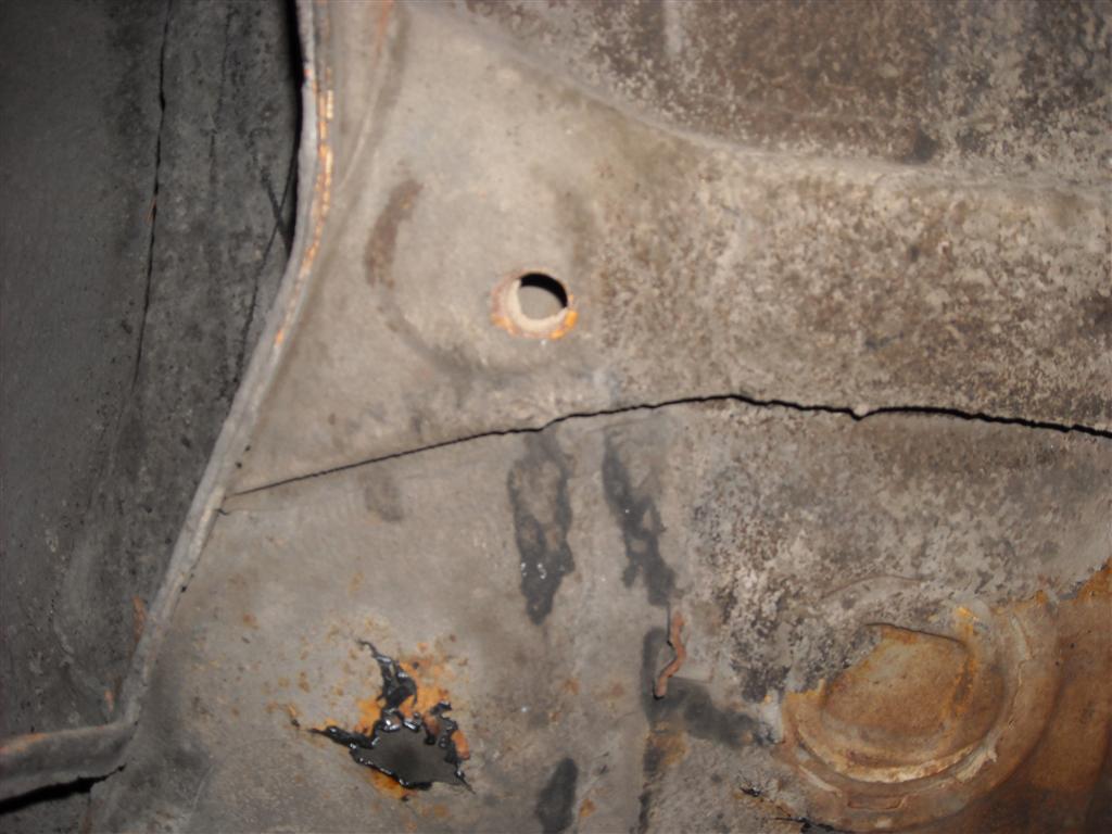

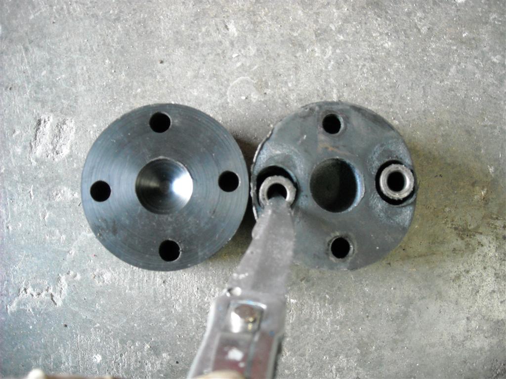

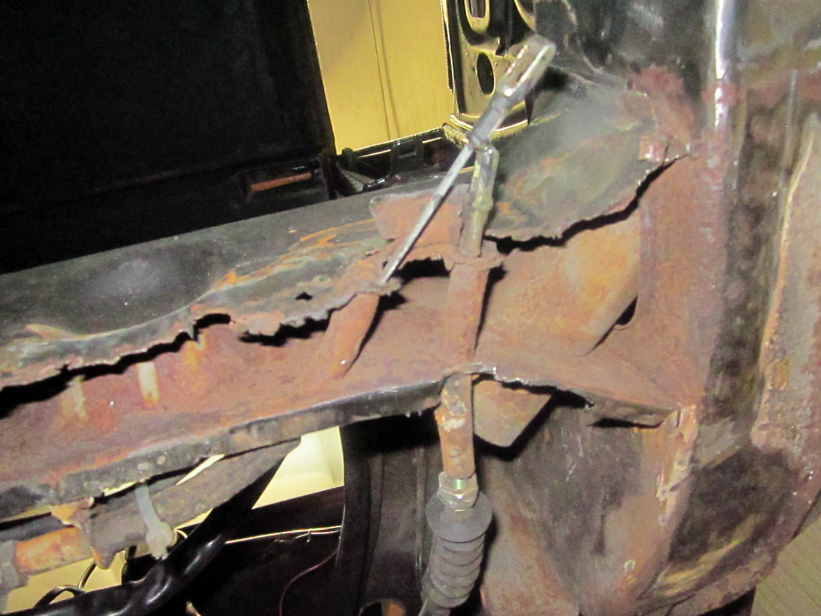

scotty b   I found where O.J.'s knife went. :unsure: Rem...   Sep 8 2011, 02:37 PM

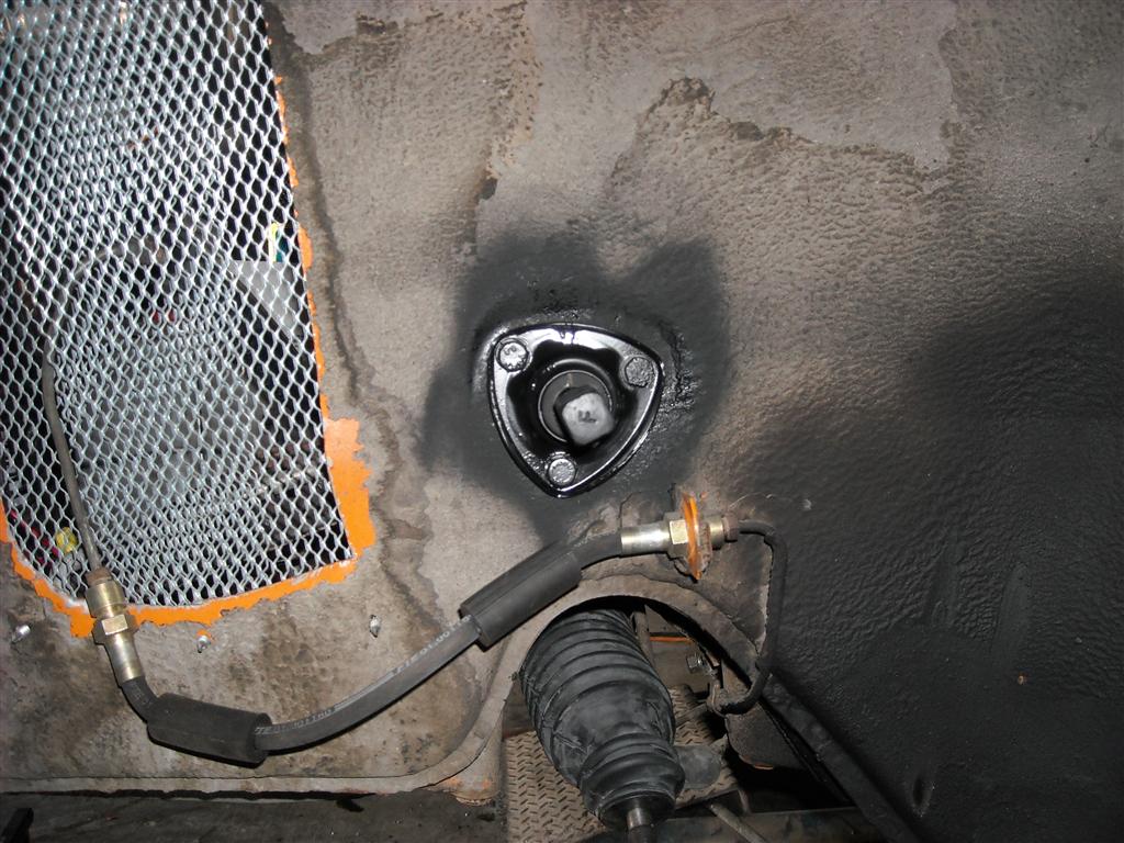

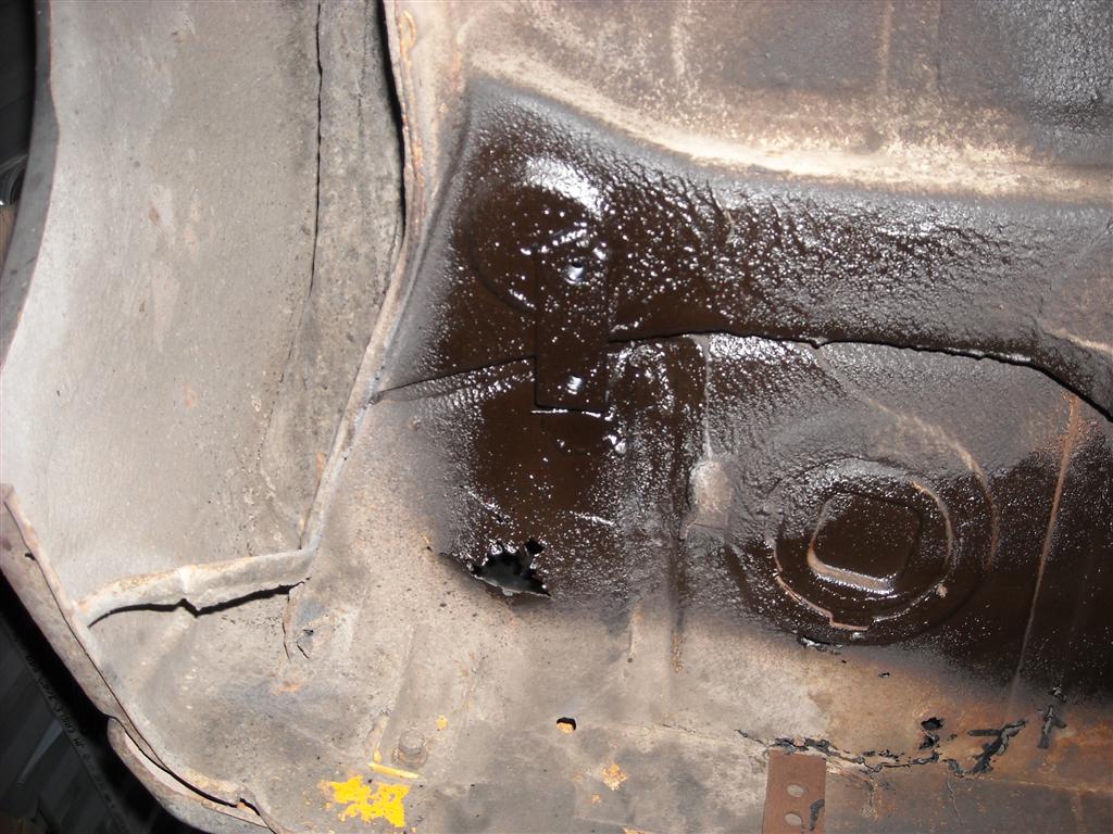

scotty b   :unsure:   Sep 13 2011, 05:38 PM
jimkelly   scott now that is what i call progress : ) i am ...   Sep 13 2011, 06:04 PM
Vacca Rabite   I love watching a Scotty Fix It thread. Zach   Sep 13 2011, 06:37 PM
jimkelly   i can't take the credit for the lovely metal f...   Sep 13 2011, 07:57 PM
TargaToy   Scotty, what did you spray over the newly fab...   Sep 13 2011, 08:41 PM
scotty b   Scotty, what did you spray over the newly fab...   Sep 14 2011, 05:06 AM
matthepcat   Looks like rubberized undercoating rattle can to m...   Sep 14 2011, 12:41 AM
