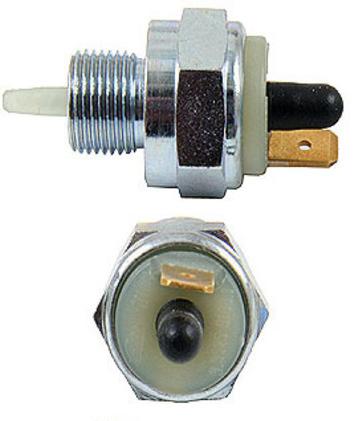

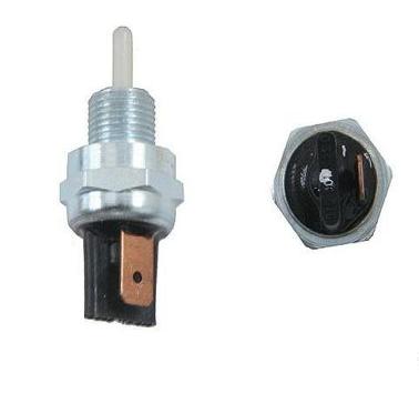

One more thing:
There are 2 version of this single ended switch:
1. will make contact and light up when the pressure drops but will shut-off afterwards. Try to avoid this.
2. will make contact and when the pressure drops and will remain that way until you press the reset switch. Note the black bump next to the electrical contact. Its a rubber boot over the reset switch.
This is the one you want for your safety as the pressure drop will not go unnoticed.

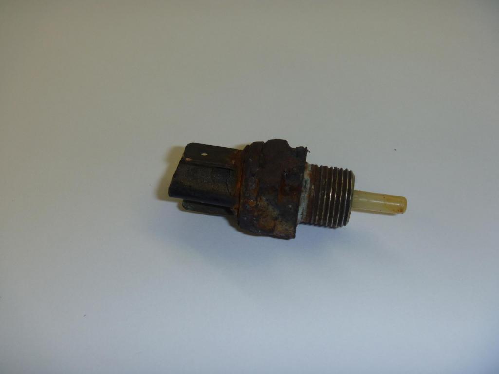

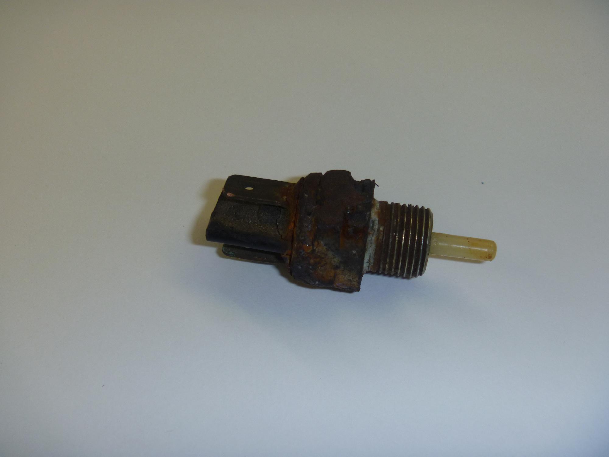

Sorry to stir this one up but I can't believe I even found a post on it! Everyone has been telling me different.
I got a new master cylinder as the OP did and my original was a 2 prong switch. I just swapped out the single prong on my new one for the old 2 prong because I assumed the old one was more complex. The 2 prong sensor does not have a reset button. I can't seem to stop the brake warning lights from flashing and people keep telling me to reset the switch. I can't reset the switch because there is no switch!! Its just a plastic divider and I have not been able to figure out how to reset it. One person mentioned that there was some procedure of pressing the pedal all the way down or something?
After reading this I'll just install the single prong sensor since I know I can reset it.
