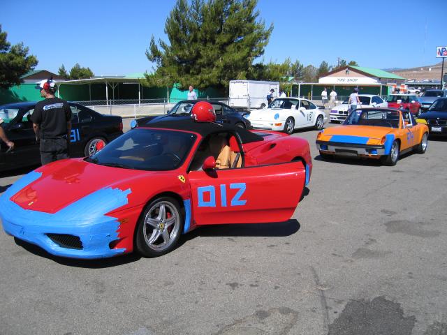

I spent the weekend at the NASA event at Willow Springs. It was pretty fun, and a very fast track - 125 on front stretch, about 105 or so on the back stretch. Turn 8/9 right at about 90/100 mph. Yowzers. I had never driven on that fast of corners before.
