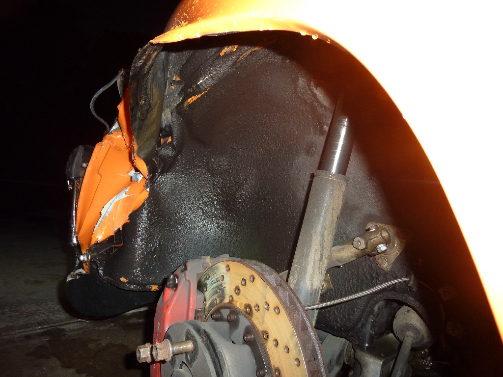

I've been slowly sorting through the mess I made for myself about a month ago at Willow Springs, and have 1 quote to fix the dent.
I'm trying to decide between (A) repairing my chassis, and (B) getting a new chassis and moving all my parts over.
I feel ridiculous even considering scrapping my chassis when I see some of the crazy "rustoration" threads here, but the fact is it's probably going to be about the same cost to straighten this chassis versus buying a donor chassis/car and building it back up.
I'm going to take this "opportunity" to fix/improve some other things on the car while I have it all apart, but I need to figure out my chassis plan first. Here are my options:
A: If I repair my current chassis ($10k - $12k):
- Find front clip
- Remove Brad Meyeur kit (to be replaced with Engman kit)
- Remove/cut existing reinforcing tubes
- Celette bench, weld new clip
- Fix front right fender/flare (it was also damaged, that strut broke)
- Add Engman kit
- Add back reinforcement
B: Build up a donor car/chassis and move over all my parts ($10k - $15k):
- Find a donor car/chassis
- Remove all rust/prep chassis. Rust repairs.
- Add 4 steel GT flares
- Maybe also put this one on a Celette bench first too to make sure it's straight.
- Add Engman kit
- Add chassis reinforcement
- Lots of small modifications I had already made: lower drivers floor/seat, close up a bunch of unused holes/make it cleaner, lots of seam welding, dash modifications, etc, etc
... plus full R&R on the front suspension/etc, but I need to do that regardless of my chassis plan.
With A it "my" original car, but with B I actually think I might end up with a nicer end result because I'm going through almost everything again, but it's probably a little more money and A LOT more work for me (versus 95% of A is just me writing a check). Am I off on my prices?
So, what do you think? A or B?

> It's _very_ difficult to fix and it will never have the same stiffness again.
The shop that would do the work (European Auto Body in Escondido) knows 914s and I think would do great work.
I had that same concern. What do others think on this? Does a straightened chassis lose a lot of its strength? I was thinking that by adding reinforcement (and maybe more than before for a semi-tube frame build) that the car could get be even stiffer than before. But would those same reinforcement on a new chassis be even better...

Just my $.02... This car can be repaired... You are going to need a frame puller and a lot of jig building. Judging by how far that the roof is tweaked makes me think that the damage is further into the car than the nose. Inspect the longs and see if there are kinks in them or creases. If there are post photos of them. If they are ~ shaped than that means you have some shrink, that means somewhere else you have stretch... Not the end of the world because folks have been fixing that sort of thing since the beginning of auto repair... But it may mean replacing some pieces that you didnt anticipate. I do agree with your statement of strength though. After an impact it is very hard to get the car back to the rigid piece it once was, not that these 914's are super rigid to start....
I would say rebuild if you can! That car is very nice!

W are talking steel here. If the chassis is properly pulled by someone who understands these chassis there is no reason it can't be pulled back to where it should without overworking the metal. Once the chassis is in line on the Cellete and it has been checked to make sure the chassis is straight, then putting it back on the Cellete and welding in the reinforcements will pose no problems and you can make the chassis stronger than it was before. The cost difference is pretty much irrelevant. The chassis swap would be easier, because your not having to go backwards, but there would be more work involved in getting the chassis back to where the current one is.
To me it seems like a toss up. If I were doing the work I would find starting with another chassis easier, but either way can be done.
Yes, we know we have to put on on a Celette bench with the 914 fixtures.
