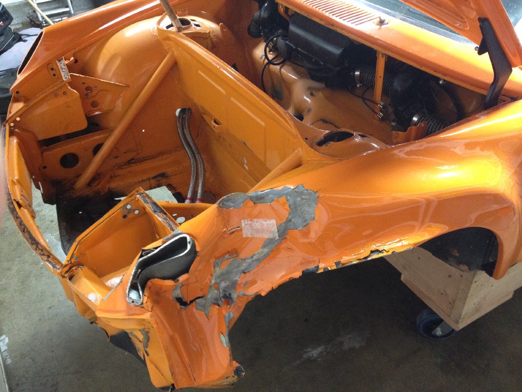

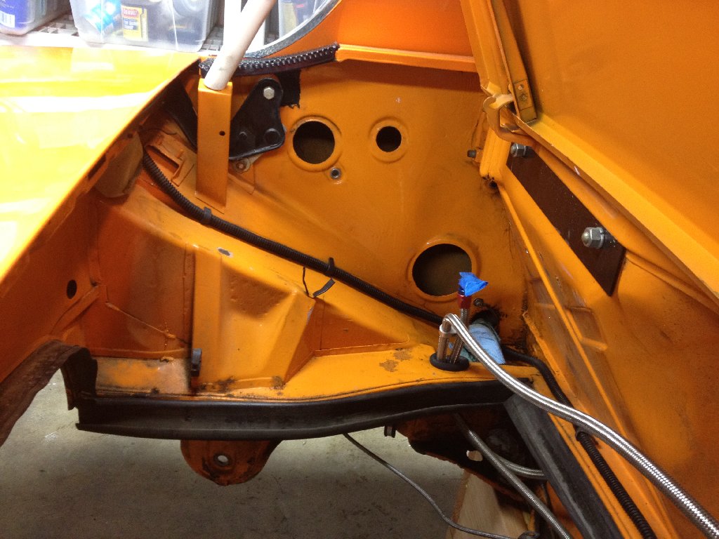

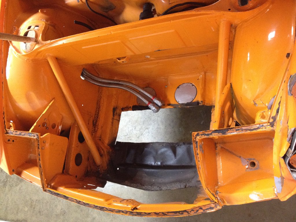

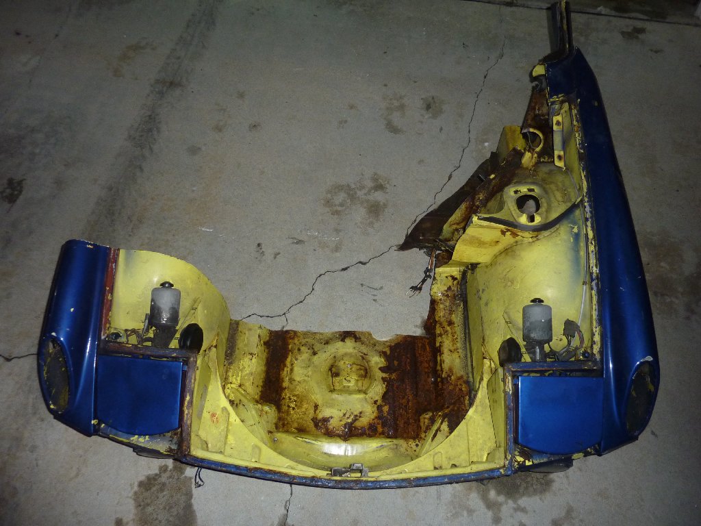

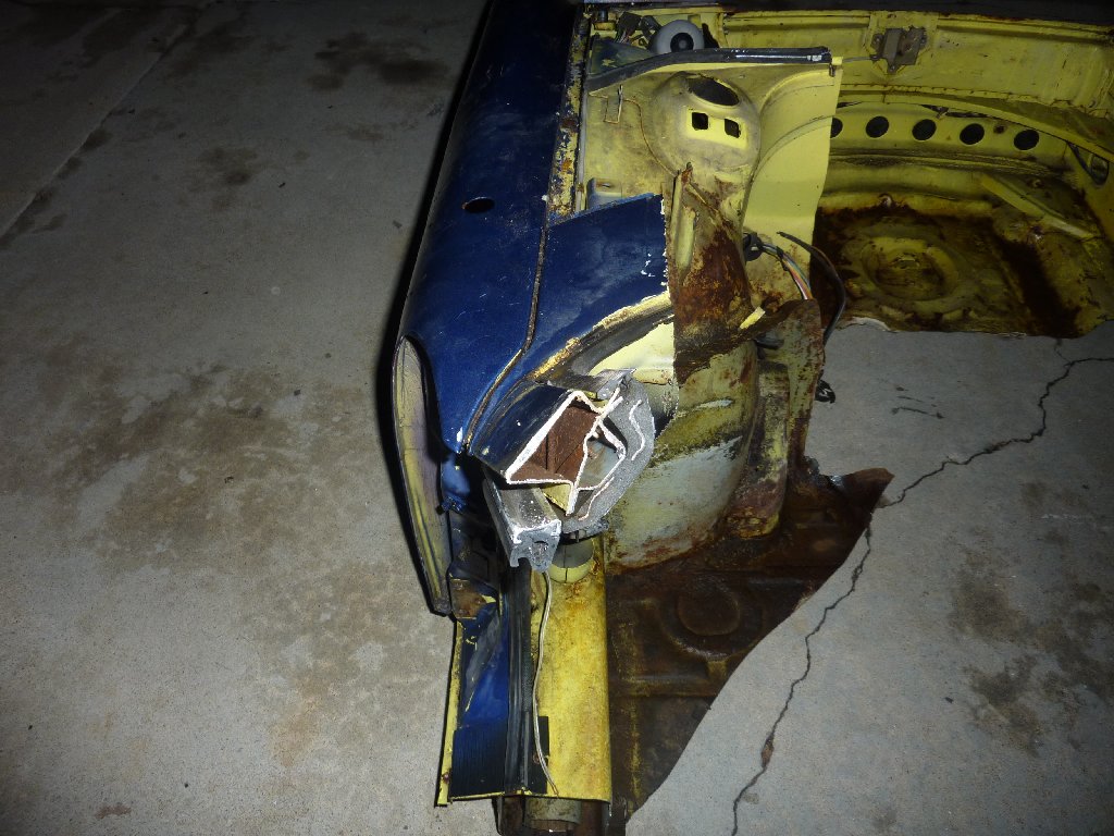

I've been slowly sorting through the mess I made for myself about a month ago at Willow Springs, and have 1 quote to fix the dent.
I'm trying to decide between (A) repairing my chassis, and (B) getting a new chassis and moving all my parts over.
I feel ridiculous even considering scrapping my chassis when I see some of the crazy "rustoration" threads here, but the fact is it's probably going to be about the same cost to straighten this chassis versus buying a donor chassis/car and building it back up.
I'm going to take this "opportunity" to fix/improve some other things on the car while I have it all apart, but I need to figure out my chassis plan first. Here are my options:
A: If I repair my current chassis ($10k - $12k):
- Find front clip
- Remove Brad Meyeur kit (to be replaced with Engman kit)
- Remove/cut existing reinforcing tubes
- Celette bench, weld new clip
- Fix front right fender/flare (it was also damaged, that strut broke)
- Add Engman kit
- Add back reinforcement
B: Build up a donor car/chassis and move over all my parts ($10k - $15k):
- Find a donor car/chassis
- Remove all rust/prep chassis. Rust repairs.
- Add 4 steel GT flares
- Maybe also put this one on a Celette bench first too to make sure it's straight.
- Add Engman kit
- Add chassis reinforcement
- Lots of small modifications I had already made: lower drivers floor/seat, close up a bunch of unused holes/make it cleaner, lots of seam welding, dash modifications, etc, etc
... plus full R&R on the front suspension/etc, but I need to do that regardless of my chassis plan.
With A it "my" original car, but with B I actually think I might end up with a nicer end result because I'm going through almost everything again, but it's probably a little more money and A LOT more work for me (versus 95% of A is just me writing a check). Am I off on my prices?
So, what do you think? A or B?

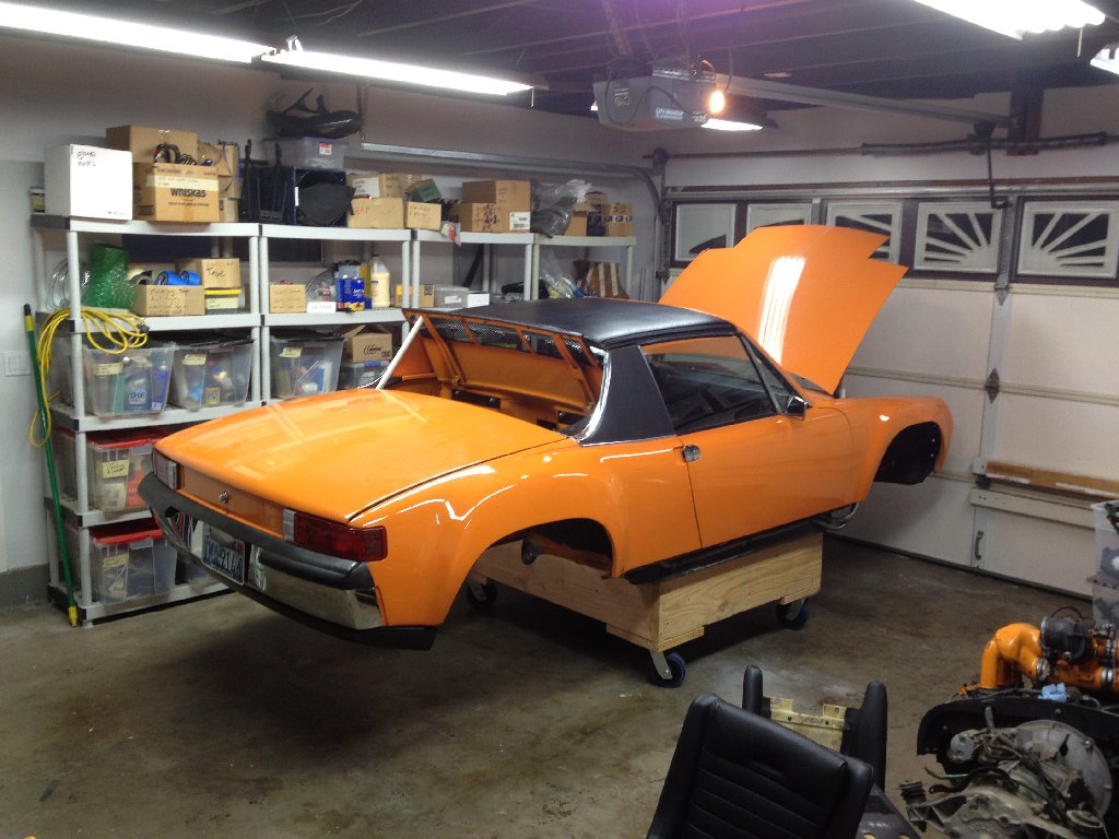

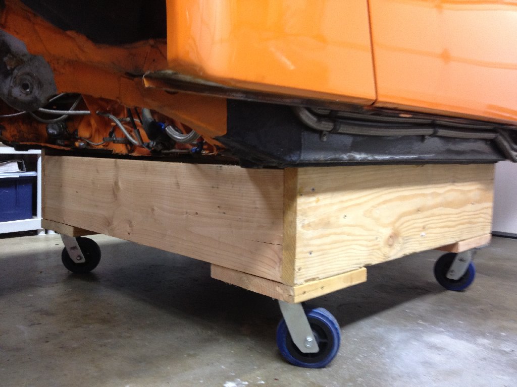

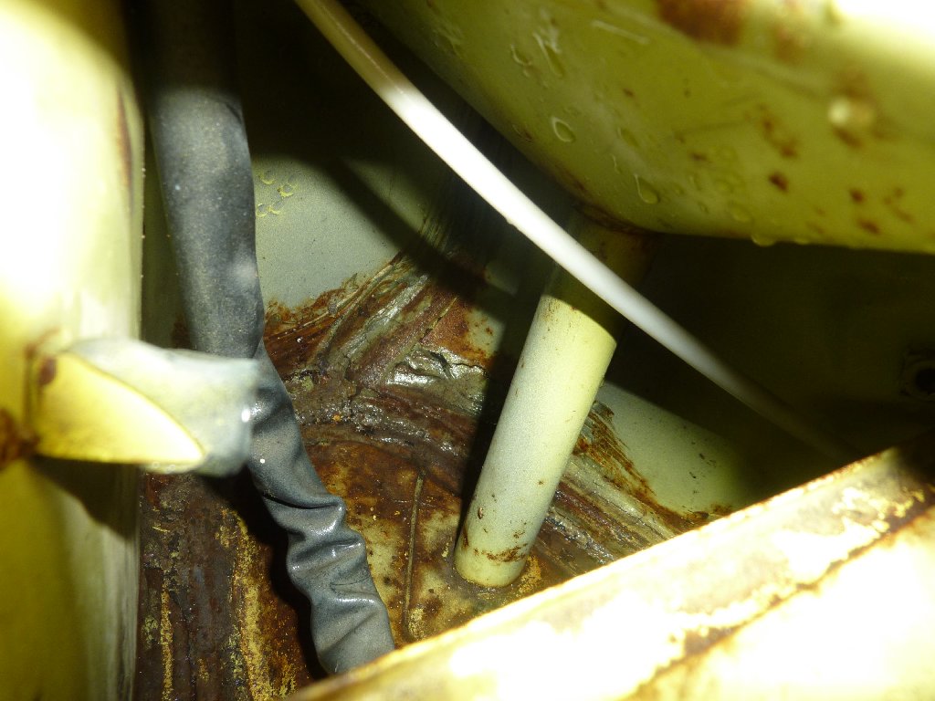

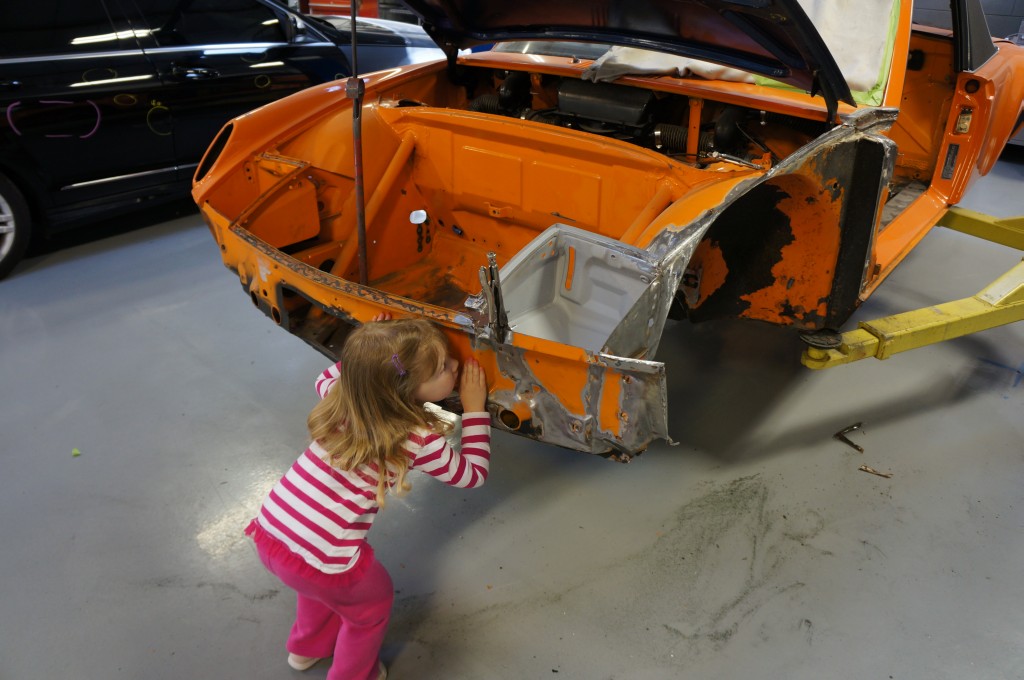

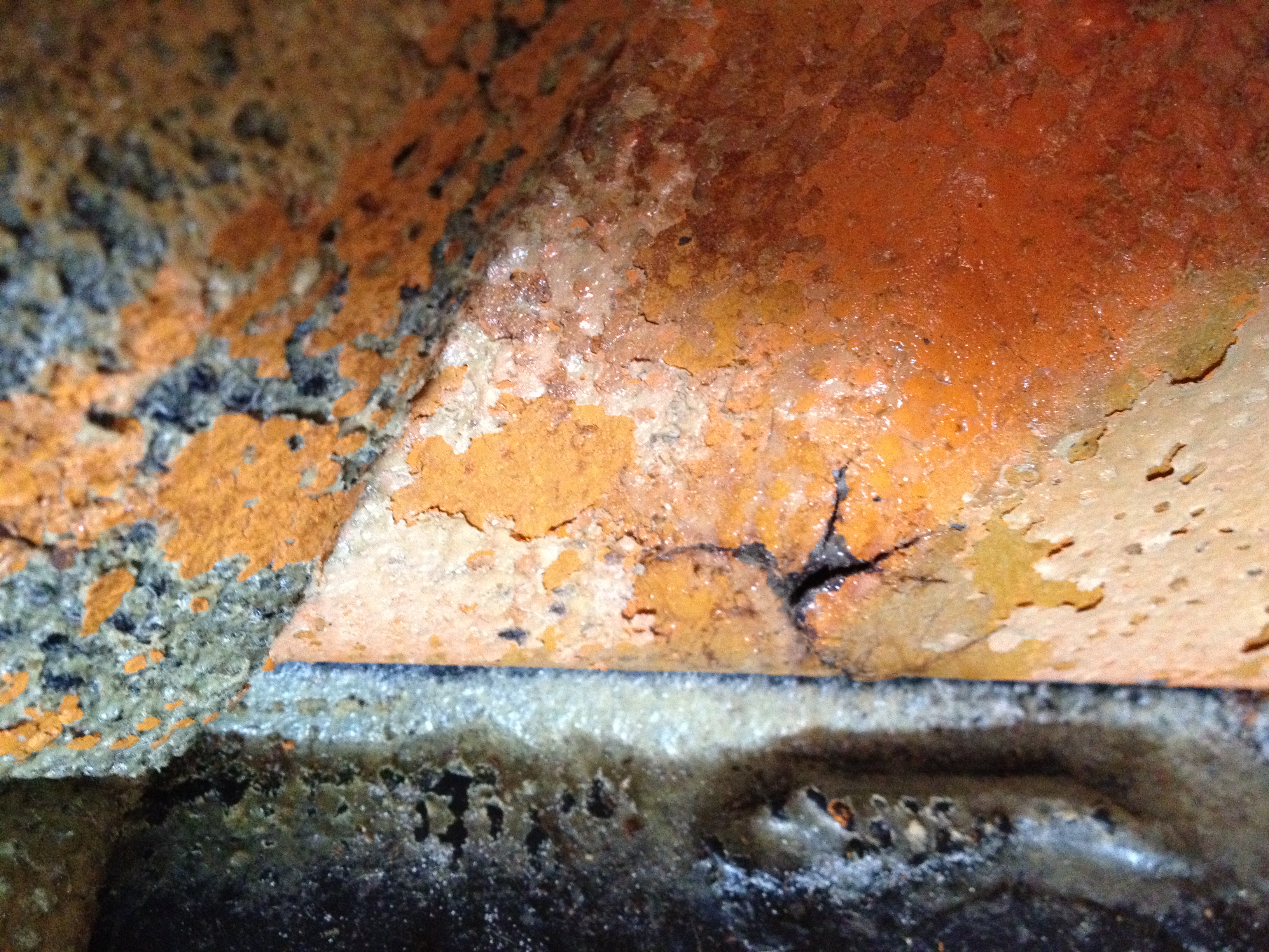

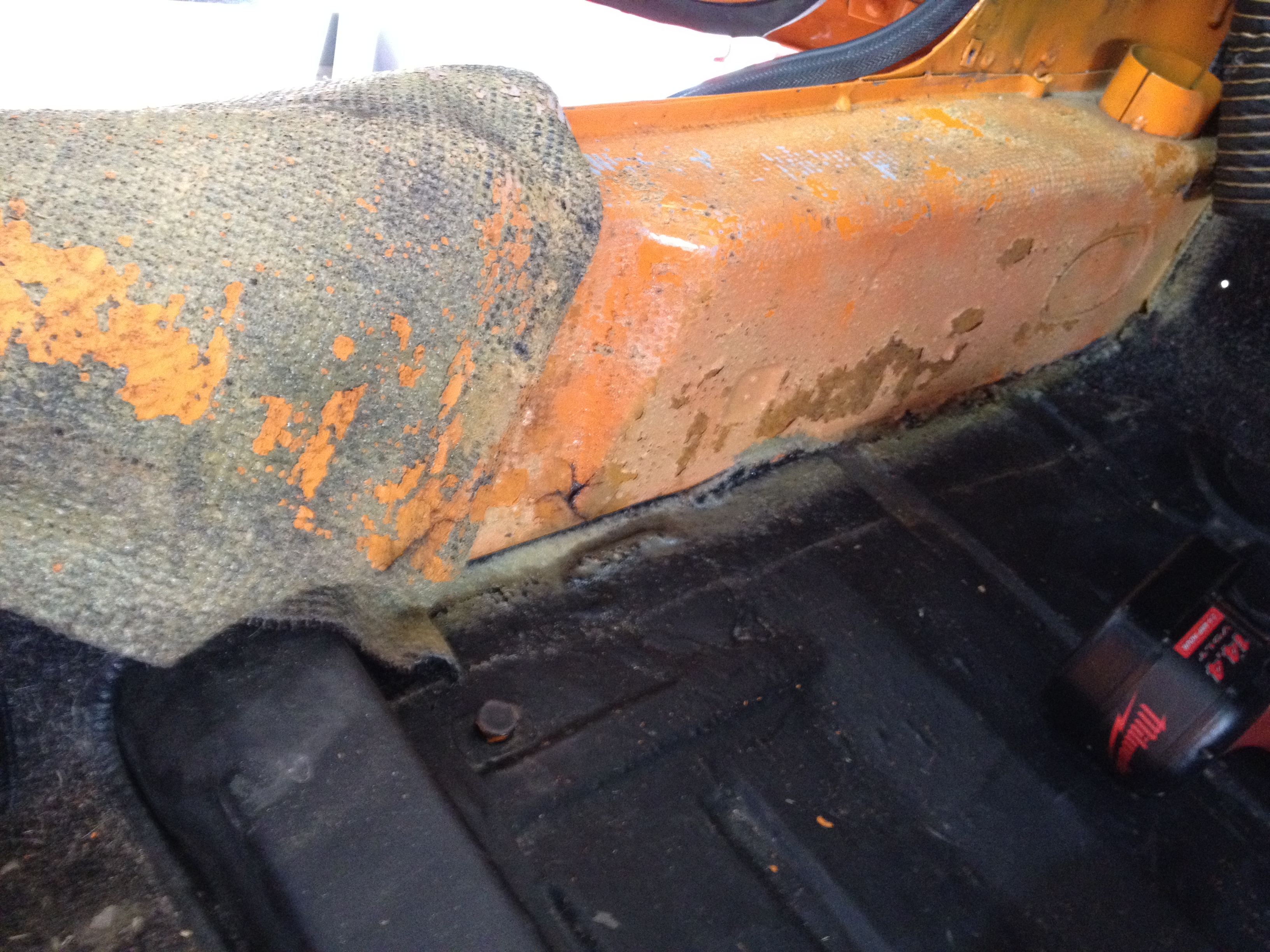

siverson   We'll I'm almost done tearing the car done...   Nov 19 2011, 11:36 PM

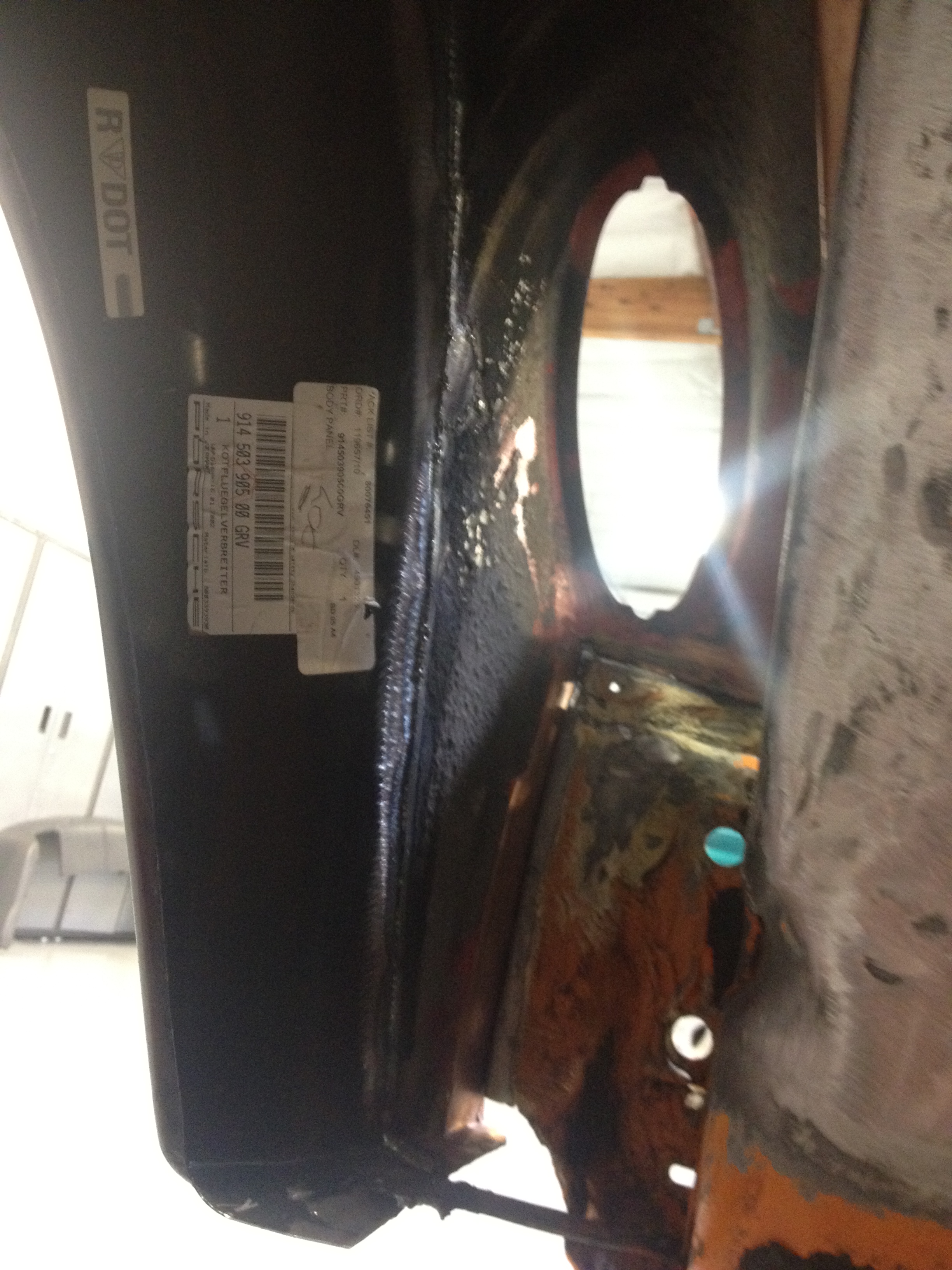

siverson   close up BTW - the crack looks sort of old and th...   Nov 19 2011, 11:38 PM
rick 918-S   That crack is very very common. Good to see progre...   Nov 19 2011, 11:44 PM
sean_v8_914   common, most crack there. I could come up with 5-6...   Nov 20 2011, 12:15 AM
siverson   Thanks for the input. Glad to hear it shouldn...   Nov 20 2011, 01:47 PM
Steve   That's another good reason for the Engman kit....   Nov 20 2011, 02:04 PM

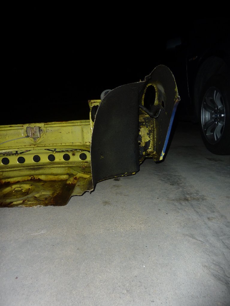

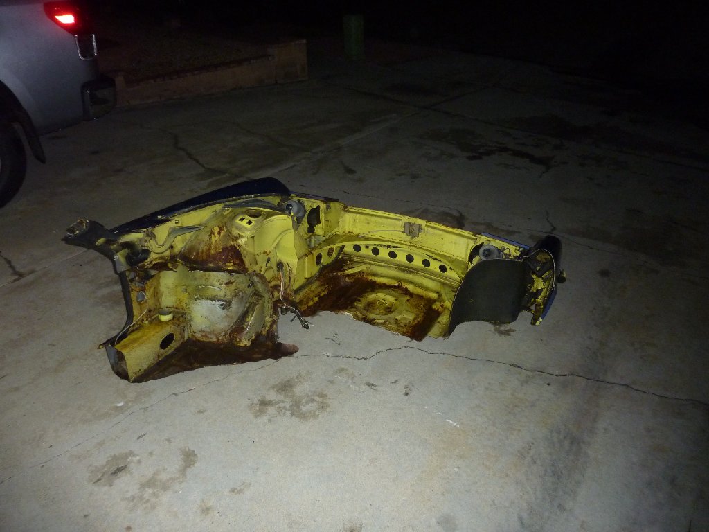

siverson   Finished the tear down this past weekend and got t...   Nov 28 2011, 10:03 PM
siverson   At this point, I was 70% sure I was going to show ...   Nov 28 2011, 10:05 PM
siverson   But it worked out ok. -Steve   Nov 28 2011, 10:06 PM
siverson   Hopefully it will be back together when he's r...   Nov 28 2011, 10:08 PM

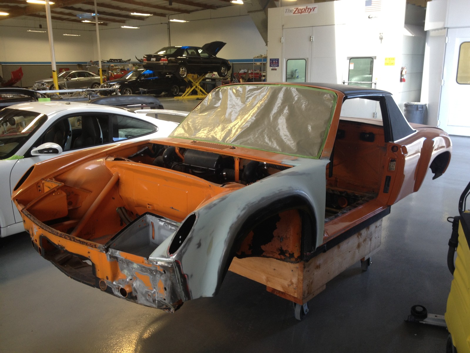

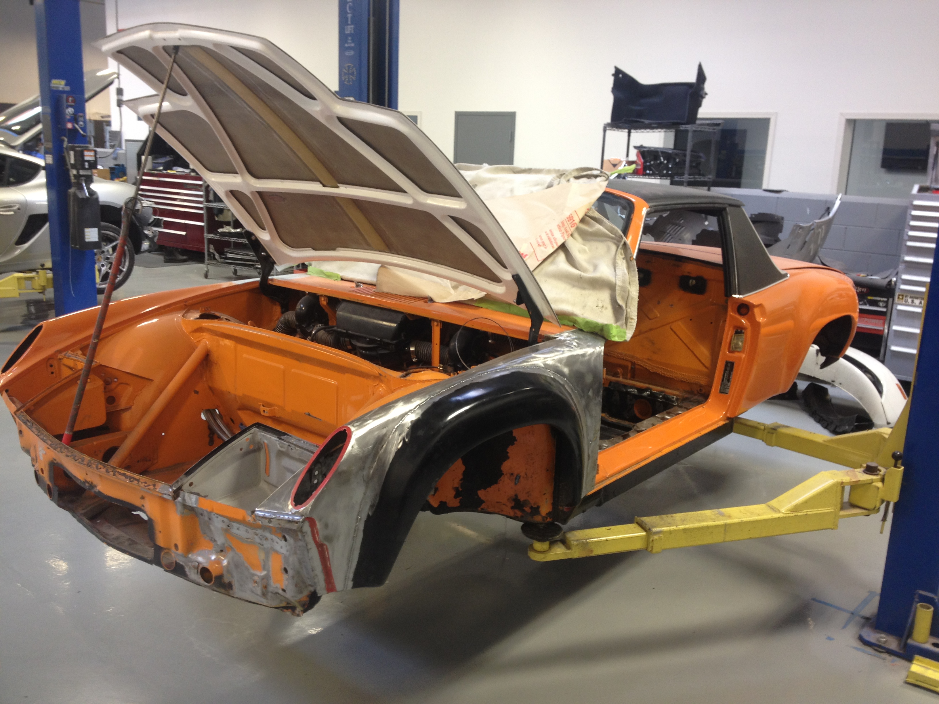

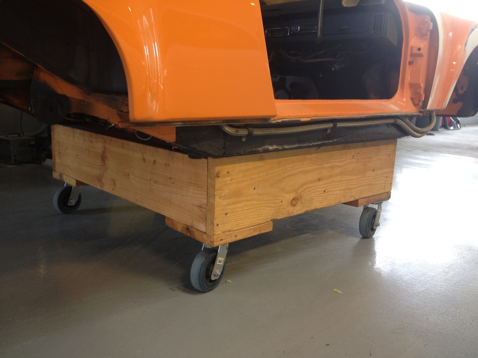

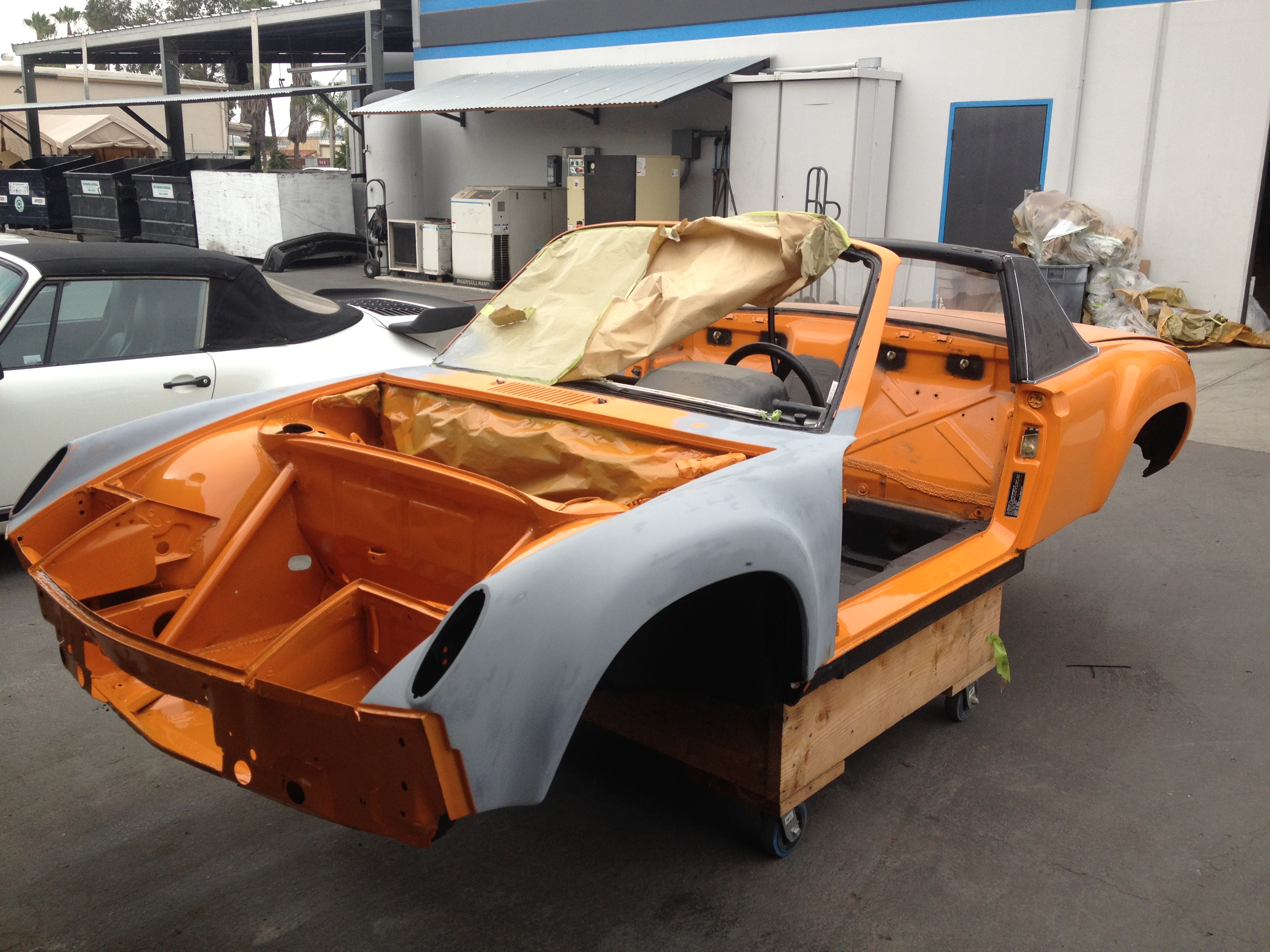

siverson   Some progress was made this week. First, the Cele...   Mar 16 2012, 02:22 PM
siverson   And some shots from the bottom if you're curio...   Mar 16 2012, 02:23 PM
siverson   And another patient that 914 is sharing the room w...   Mar 16 2012, 02:24 PM
siverson   And it's straight again. Lots of strange pulls...   Mar 22 2012, 12:45 PM

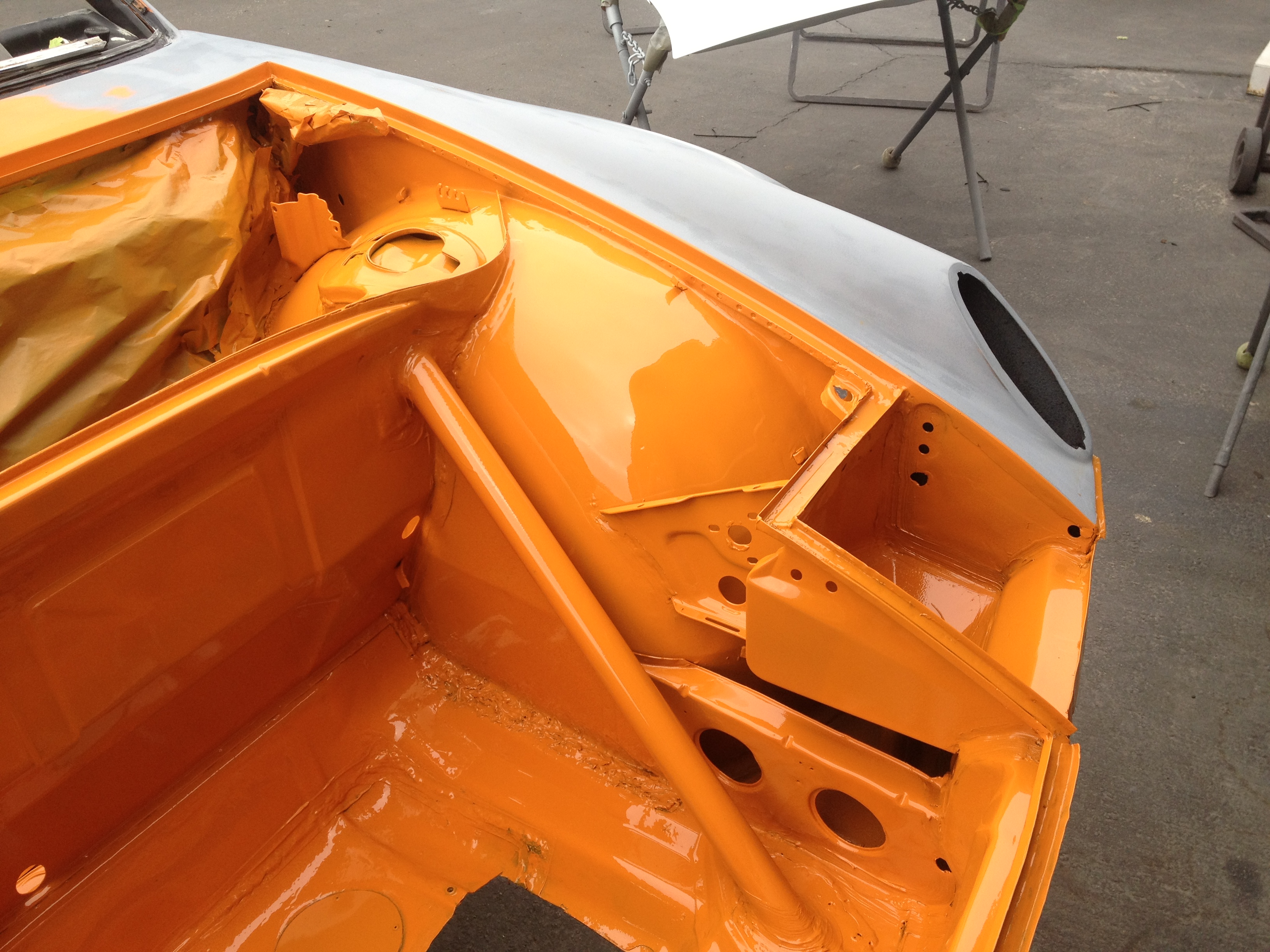

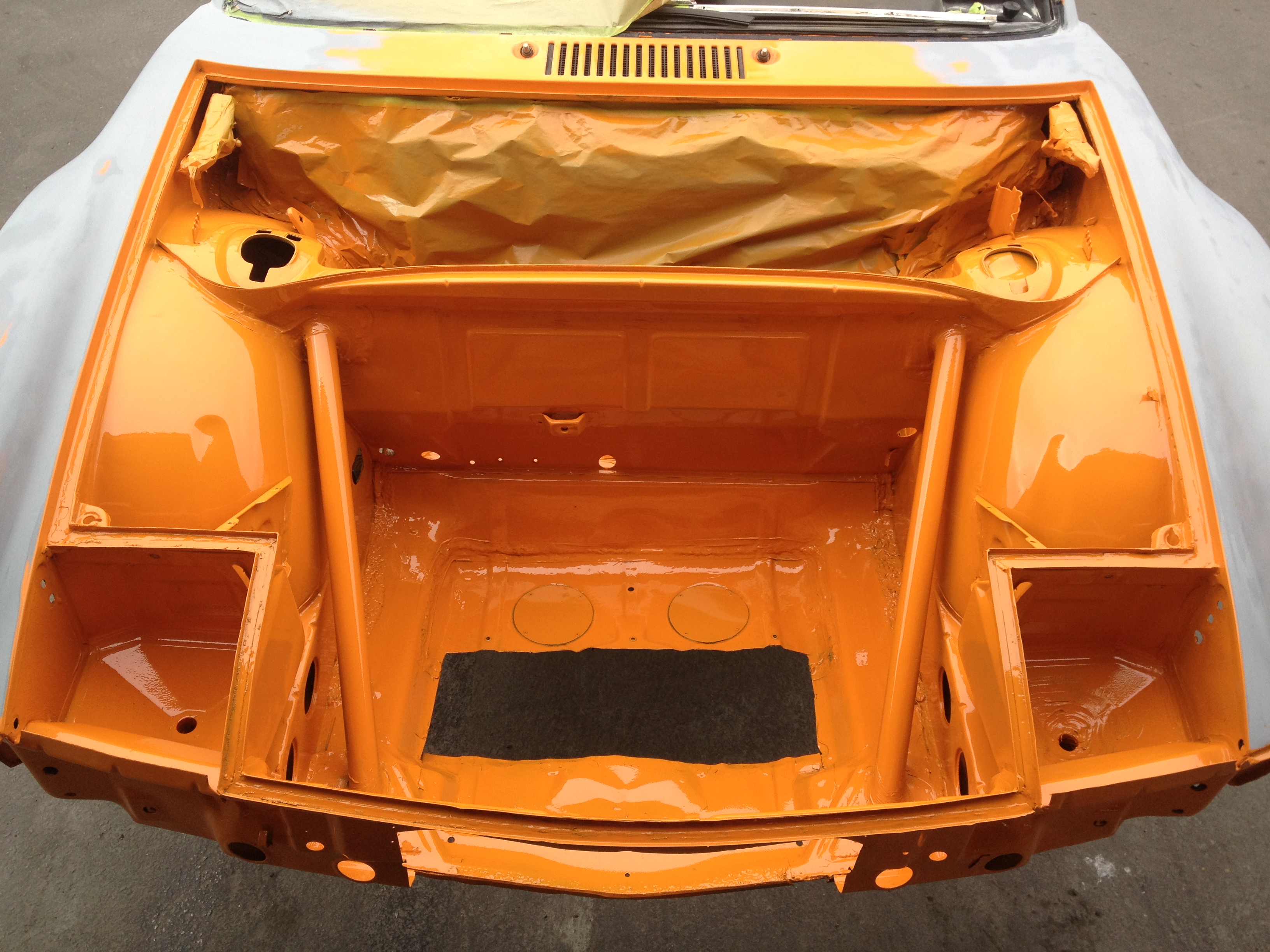

siverson   More progress photos. And last call looking for a...   Apr 3 2012, 09:12 PM
