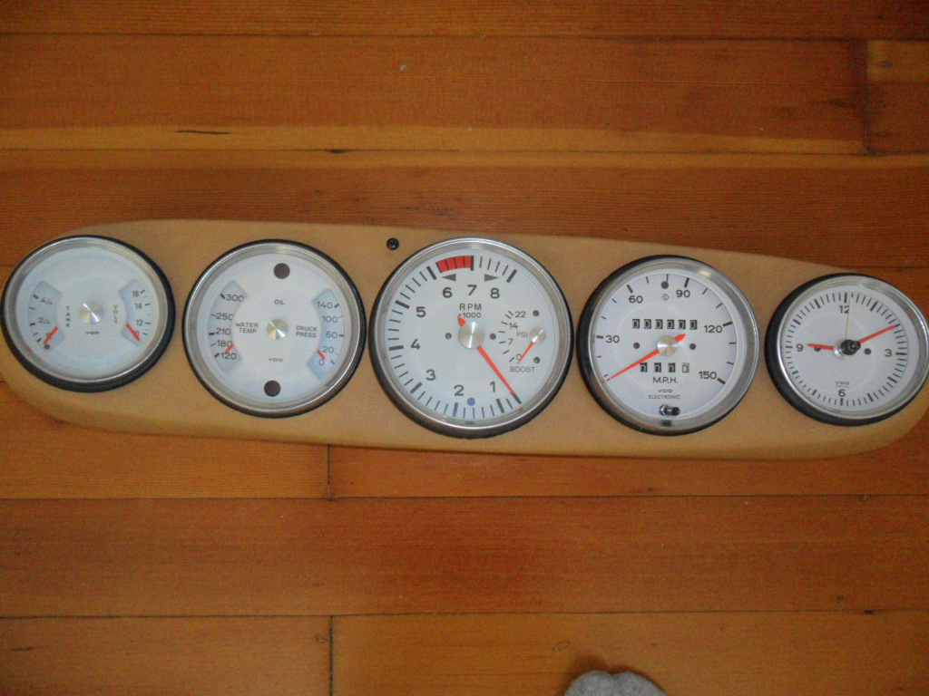

Chris Scott   Here is a photo of the gauges that north hollywood...   Sep 5 2011, 04:28 PM
roadster fan   Wow! Cant wait to see it in person. That is g...   Sep 5 2011, 04:44 PM
rohar   Great, now it's going to be pretty too. There...   Sep 5 2011, 05:30 PM
rohar   Oh, and the redline on your tach seems a bit low a...   Sep 5 2011, 05:32 PM
Chris Scott   We realized the deficiencies in the gauges also bu...   Sep 5 2011, 05:39 PM
