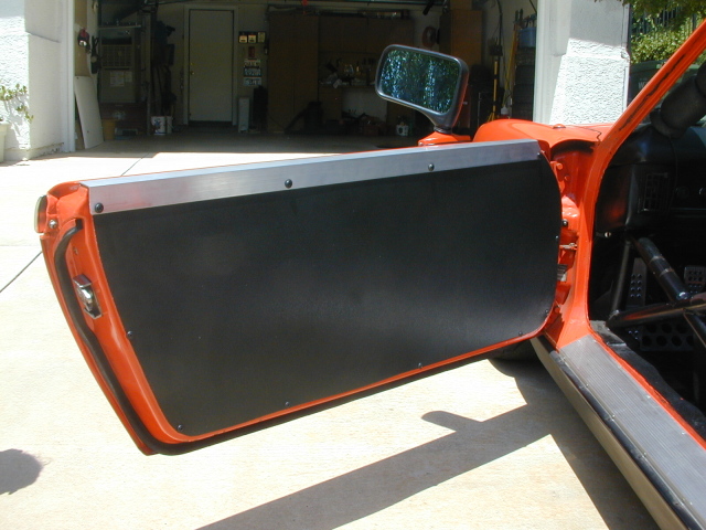

Here's my current solution. Early non-beam doors with my trick 'custom' (IMG:style_emoticons/default/jester.gif) $20 door panels (thin black ABS and angle-aluminum). Glass, regulators/winders and locks are gutted. You would not believe how much all that upholstery and inner-door stuff weighs!
The brushed aluminum matches the exterior and interior trim reasonably well, and the ABS door panel material is textured similarly to the stock (smooth) dash vinyl.
