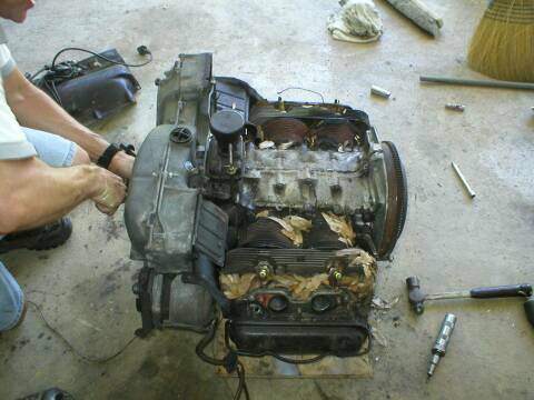

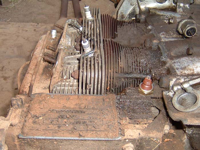

heres what it looked like

There shouldn't be any gaskets between the heads and the cylinders, so that's actually not a problem.
It looks like that engine needs a good cleaning, at least. It also sounds like you're already committed to doing a complete tear-down and rebuild, which wasn't clear in your first post. It sounded like you were prepared to simply clean things and put it back together.

Wow that is one dirty engine. Bet it ran hot too as nearly completly blocked off oil cooler. If you were to just clean it up it will run much better. My 1.7L was just about that bad on the cylinders I drove from Seattle to Pascagoula like that. Didn't know it till I tore it down.
Plenty of info here on the board about seals and sealing compounds. Do searches like "oil leak"
Broken fins are not that big of a deal as long as it is just a short section on one cylinder each. (IMG:style_emoticons/default/coffee.gif)

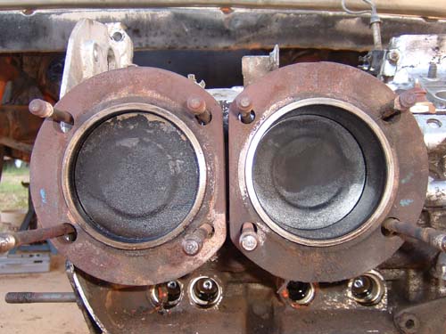

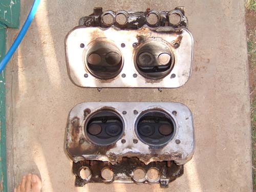

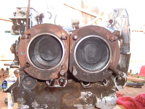

(IMG:style_emoticons/default/smile.gif) The pic of the cooler if you look in the center wher you can see the fins, well i rubbed my finger over that it was totaly blocked. I have more pic's of the heads and cylinders the heads had no gaskets on them nor did the cylinders had no "lets see Auto atlanta calls it a head gasket w/ diagram, haynes book has sealing rings and pelican also has sealing rings so I am assumeing that it is a sealing ring, there were none! the reason I pulled the heads was all, injectors were fireing and spraying correctly in the viles, the front to cylenders were very strong 2&4, the back 2 cylinders 1&3 were fireing BUT not as strong, these are the 2 injectors that I replaced new, in the pic's cylinders 1&3 have carbon build up, same for the valves on the heads. I'll order new rings and pin's for the pistons and have the cylinder walls polished out, cannot find 1.7 pistons and cylinders.
During the tear down it had a Factory Air cond. compressor, since there is nothing other than this will not put back on, still turns and has oil in the compressor all the bolts were loose on that on the block, will replace the clutch cable outercovering or plactic torn off , Funny thing on that there was a worm gear clamp clampped on the cable on the pulley end, I guess when who ever had it before me put that there to space the clutch out, on the Fly Wheel bolts, they were supposed to be a 12 point bolt, they were 17 mm hex head bolts that were gound off on top to fit, it was balanced did drive it no vibration. The Tin screws well they were most al there but some were removed and used else where on the car. in the pics that i posted today the o-ring seals for the oil tubs this is how it came out and are not right size.
The reason for the drop well when you put new oil censor in and the oil light omes on after it warmmed up, and the car died at all stops and would have to restart, and all the oil leaks, rear main leaking front was questionable will repace anyway I thought it would be better to do this to actually know and run like it should run.
The Body as normal will have to replace the battery tray rotted through and brace while I'm there will remove the light rust on the metal there to see if it needs replaced, there is a Silver dollarsized rust spot on the drivers side roll bar right above the door handle and the jack pole drivers side rusted off may have to replace that longitudnal other than that the rest of the body other than the color it was originally signal orange was poorly painted over metalic blue will replace all body metal with metal and repaint it.

2 of 4
Hammer920
post Jul 16 2004, 09:55 AM
It's a Learning Experience
Posts: 83
Joined: 27-April 04
From: Levelland, TX
Member No.: 1,989
3 of 4

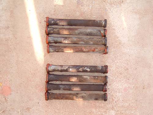

Hammer920
Posts: 83
Joined: 27-April 04
From: Levelland, TX
Member No.: 1,989
4 of 4

the guys are right NO seals between cylinder head and cylinders !
if you had 'em throw them away, if you bought 'em new, sell them on ebay.
as for the rest, a good cleaning first, buy a case of brake-cleaner and spray down all that dirt and oil-grime.
then inspect carefully for cracks in the heads etc.
you'll be surprised how much cleaning one can do on those little suckers ...
(IMG:style_emoticons/default/wink.gif) Andy

(IMG:style_emoticons/default/smile.gif) I wouldn't have got this far without my haynes book! the thing I am most concerned about is the 1&3 pistons w/ all the carbon build up have not taken off the cylinders, will take a brush and wd-40 then simple green to clean off the lower portion of the engine have already got the top part cleanned off. I'm this far I do probly need to put new rings and pins in the pistons do You guys agree? I do have more pic's of everything before the tear down the drivers side was also filled with oil and dirt. will not put those gasket rings in did come with the kit, another question I have is the kit has red gaskets 8 of them and green gaxkets 8 of those are those for the oil tubes? the red's are i know?
the head gaskets or the for the heads were not on the car what you see in the pics was all that was there.
