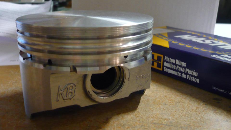

jsayre914   Minor Setback. I was pulling out my stash of parts...   Nov 9 2011, 03:04 PM
scotty b   It's toast, and the AA's are a crap shoot ...   Nov 9 2011, 03:40 PM
914rat   You can buy just 1 jug from AA.The stock jugs are ...   Nov 9 2011, 05:05 PM
Vacca Rabite   Yep, bore the stock ones. They are better then the...   Nov 9 2011, 06:03 PM
