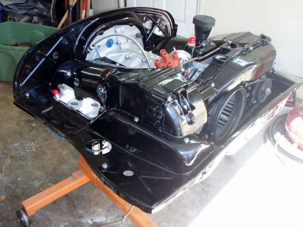

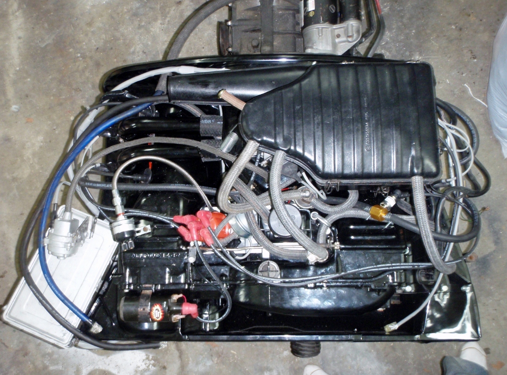

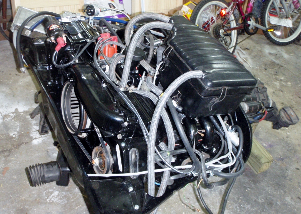

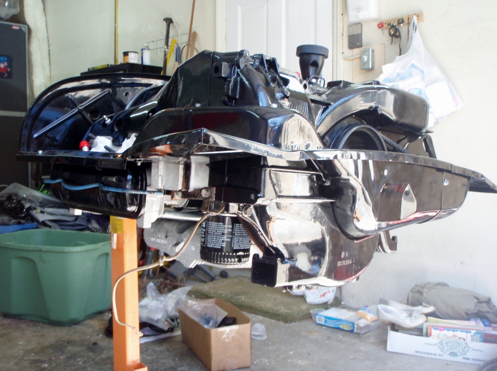

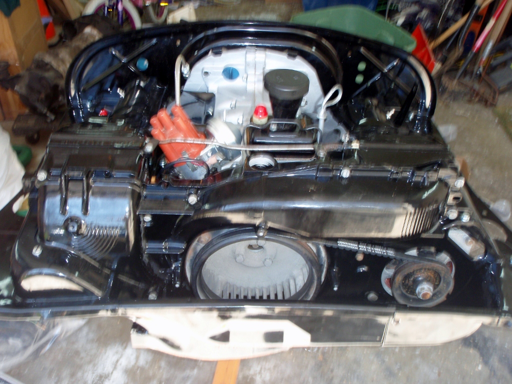

Few Pics for Ya.
The engine is ready to go back in. (IMG:style_emoticons/default/piratenanner.gif)
I have been busy doing other projects on (IMG:style_emoticons/default/dry.gif) the house. so no start yet. Tommorow is a new day (IMG:style_emoticons/default/smile.gif)
