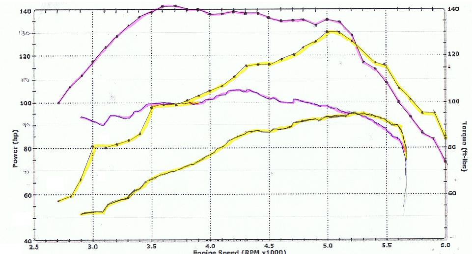

Dyno Results. (not Bad) (IMG:style_emoticons/default/smile.gif)

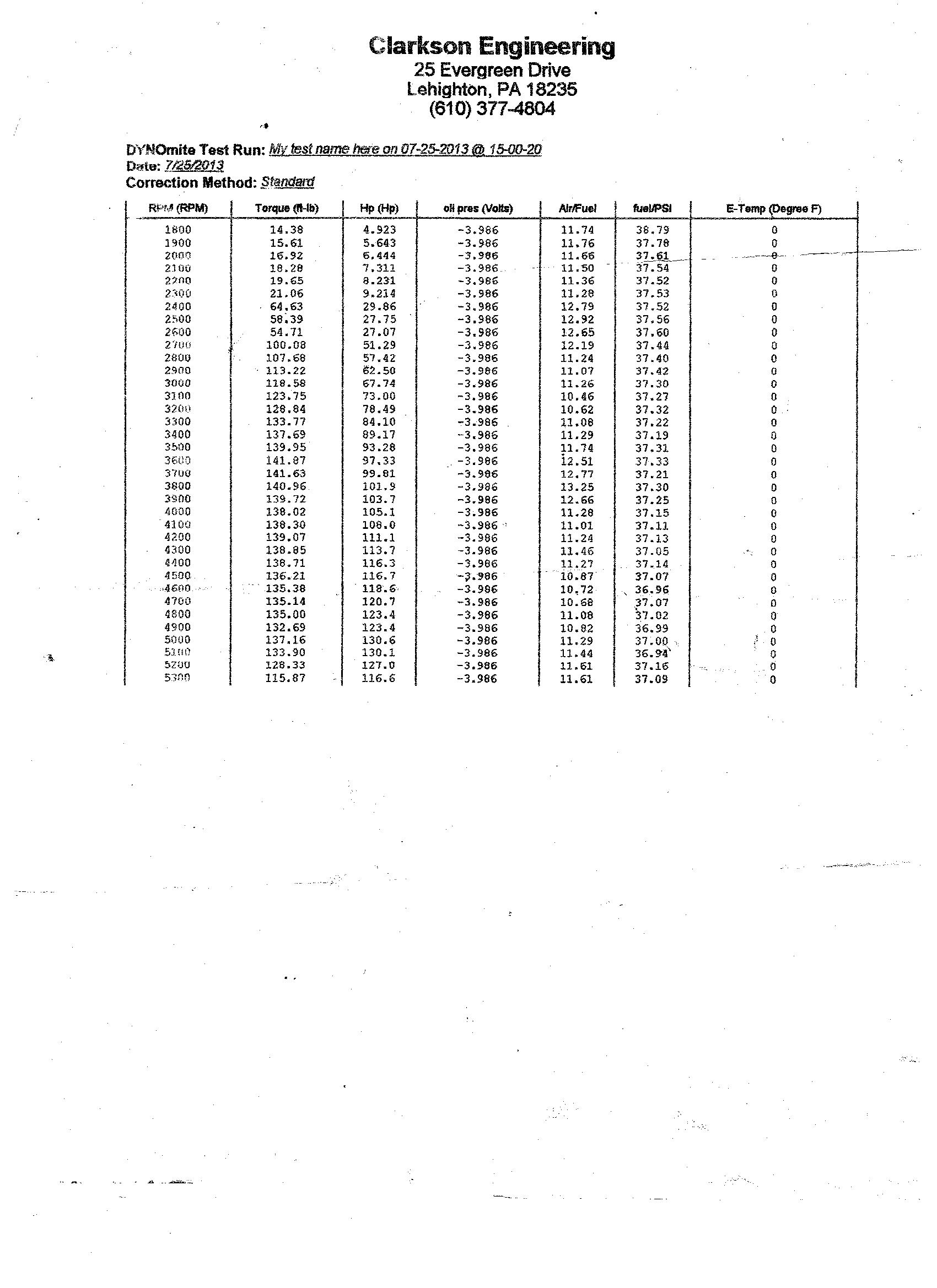

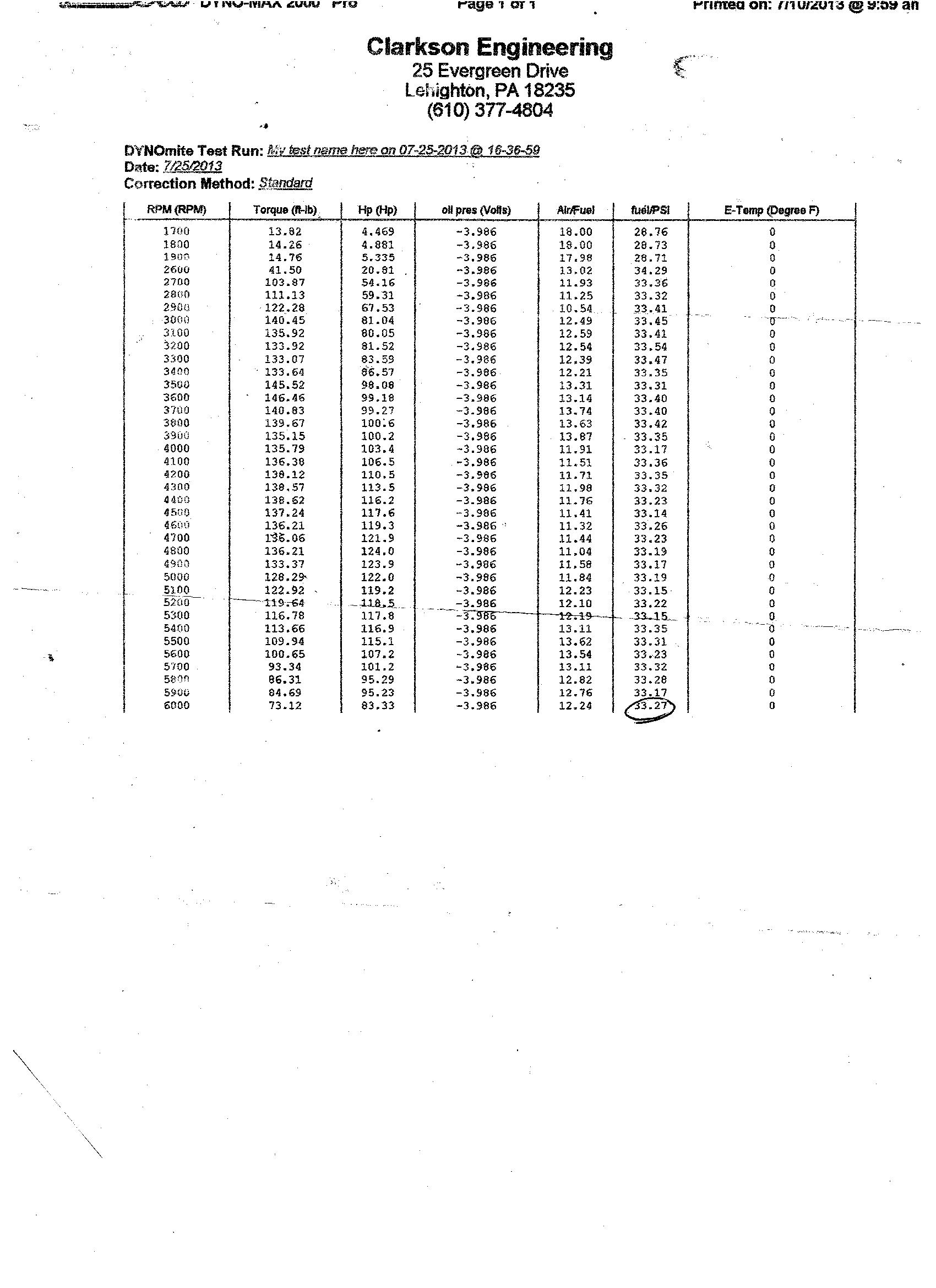

I got 2 pages from Tony, but no graph (IMG:style_emoticons/default/dry.gif)
I did a search for a stock 2.0 d-jet Dyno graph, then I added my numbers to the chart by hand and connected the dots for comparison.
Yellow =HP
Purple = Torque
jsayre914
post Aug 7 2013, 12:04 PM
Post #124
Speed Up !!!
Posts: 3,210
Joined: 10-February 08
From: Timonium MD 21093
Member No.: 8,696
You could even say that this motor is OFF THE CHRTS ! (IMG:style_emoticons/default/biggrin.gif)

That is fantastic.

Welcome back Joe! (IMG:style_emoticons/default/beerchug.gif)
Awesome DYNO results!
