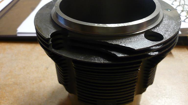

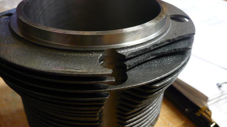

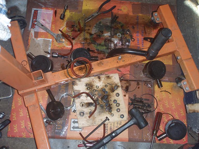

jsayre914   Minor Setback. I was pulling out my stash of parts...   Nov 9 2011, 03:04 PM
scotty b   It's toast, and the AA's are a crap shoot ...   Nov 9 2011, 03:40 PM
914rat   You can buy just 1 jug from AA.The stock jugs are ...   Nov 9 2011, 05:05 PM
Vacca Rabite   Yep, bore the stock ones. They are better then the...   Nov 9 2011, 06:03 PM

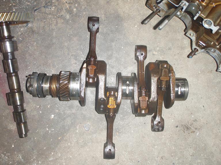

jsayre914   Few more pics of the guts before bed :) ...   Nov 9 2011, 11:13 PM

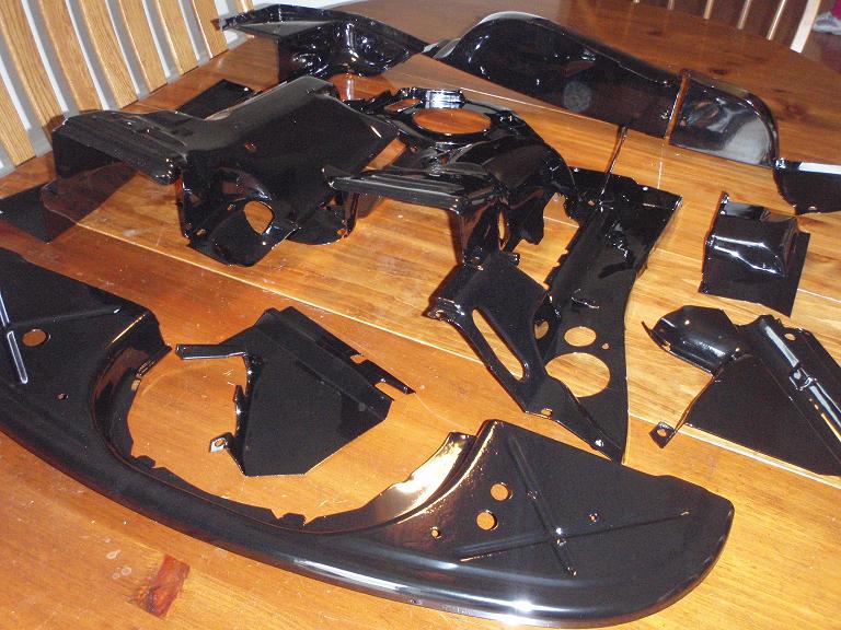

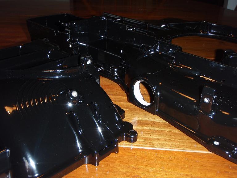

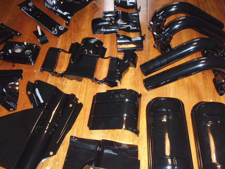

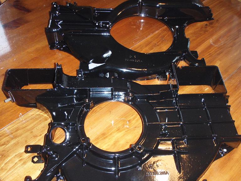

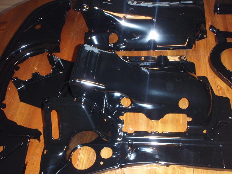

jsayre914   So I got a call from the powder shop. Everything i...   Dec 30 2011, 12:03 PM

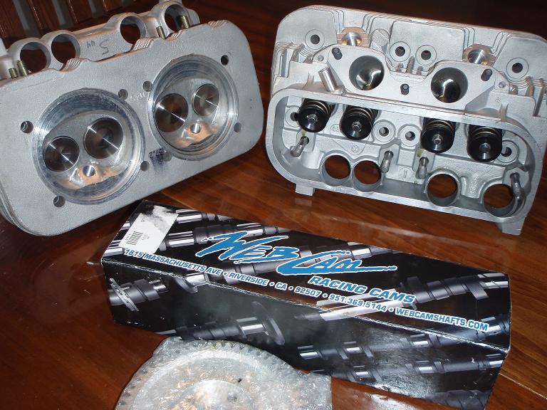

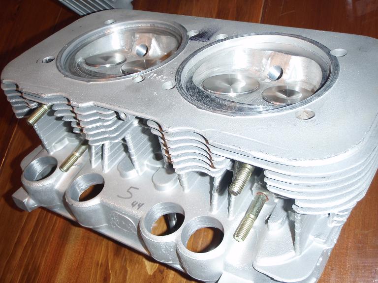

jsayre914   As promissed :drooley: I think they did an outs...   Jan 3 2012, 10:20 AM
jsayre914   And the original Heads brought to life by Len :el...   Jan 3 2012, 10:23 AM

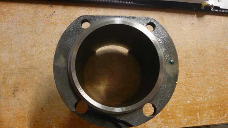

jsayre914   Next stop.... WARRIOR ENGINE to see if my 94mm a...   Jan 3 2012, 10:25 AM

type47   And there's a problem with that? 7 degrees out...   Jan 4 2012, 01:07 PM
Jake Raby   Dean told you the truth about the bushings... The ...   Jan 4 2012, 01:55 PM
