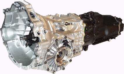

I have seen a lot of talk about the Getrag 6 speed boxes being used on the european GT40 relica's, as well as the Audi 1E 6 speed box, both mounted to Ford 302's and 351's.... Does anyone happen to know if either of these boxes = the Boxter S box under a different name?
Thom

Ok,
Lets see if I can do this....
This is the Audi 01E box, supposedly the same as the 968 box, according to this website... http://elektro.cmhnet.org/~charlie/photos/...s/01E/ind3.html

Problem with the Porsche box:
NO provision for a starter. It was mounted to the bellhousing up on the engine.
B

I could see the Audi box working... but what about the ratios ??

Go here for the ratio's...
http://elektro.cmhnet.org/~charlie/photos/.../01E/trans.html
And you might find this interesting as well...
http://elektro.cmhnet.org/~charlie/photos/...s/01E/ind2.html
