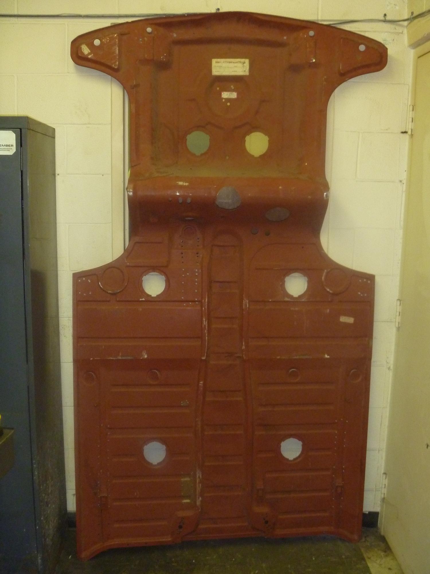

Alright, I spoke a while back that I was going to start producing the Front trunk pan. I already have all the steel and all the CAD work done, so all I need to do is prep the steel and start cutting!
I wanted to start a thread here for all to follow the progress and also to get a better idea of what goes on at Restoration Design. I am the one in charge of designing and making all the dies here for the 914, 911, 912, and 356's. I have only made two small dies( pedal cluster support, seat mount bracket) for the 914 so far so I wanted to make something else that was in need.
I started with an NOS full floor pan. The one that runs from the firewall all the way to the front trunk pan. Brought that away to get a digital scan and then from there I designed the male and female halves of the die.

lrm914   Awesome! I always wondered what the large hol...   Sep 27 2011, 01:43 PM
SirAndy   Any idea what they are for? Best guess would be fo...   Sep 27 2011, 01:47 PM
