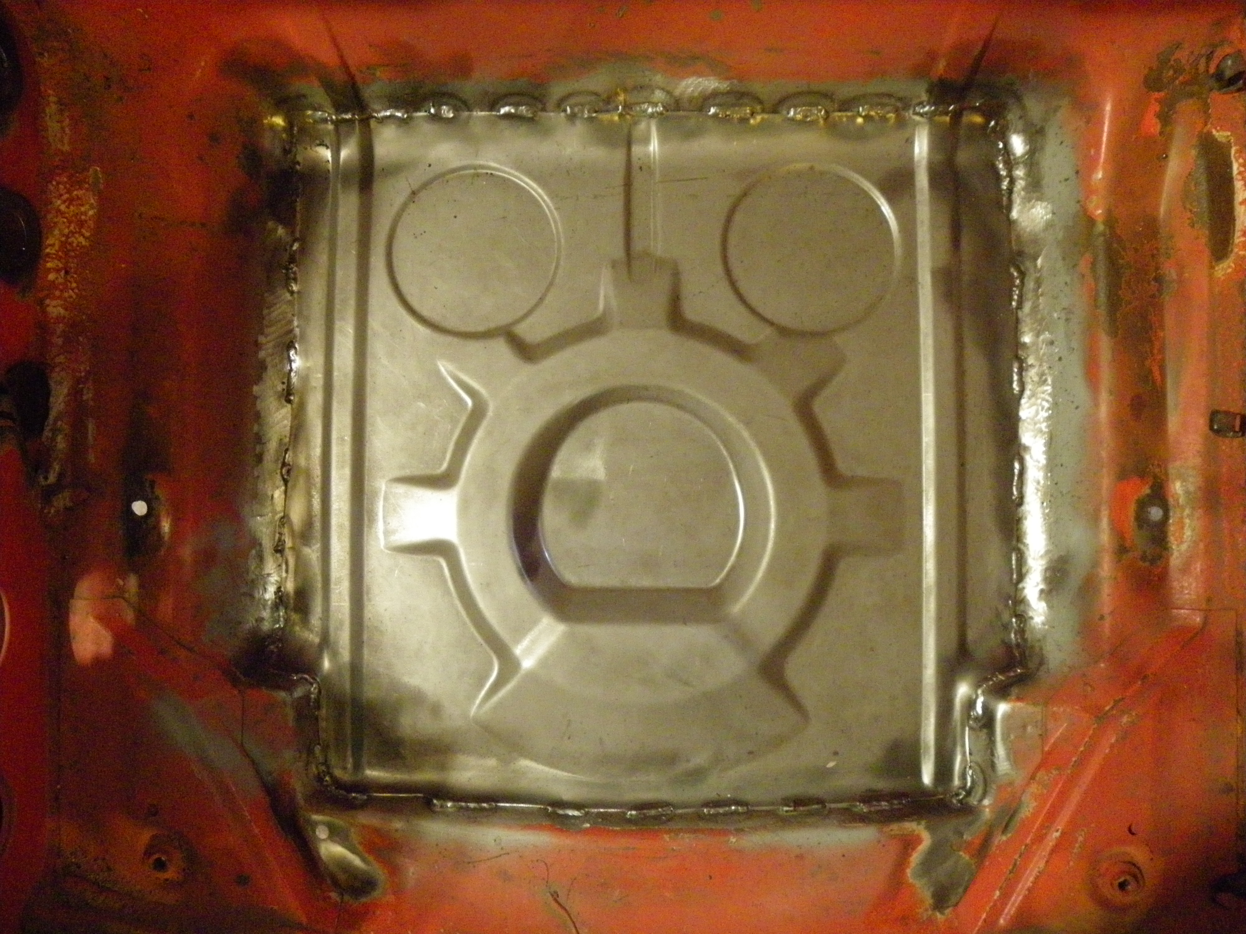

Just thought I'd pop this pic up on the world... New front trunk pan A/C patch welded in. Droped right in. (IMG:style_emoticons/default/smile.gif)

QUOTE(MrHyde @ Sep 2 2012, 05:14 AM) *
Thanks for putting that up Mike!

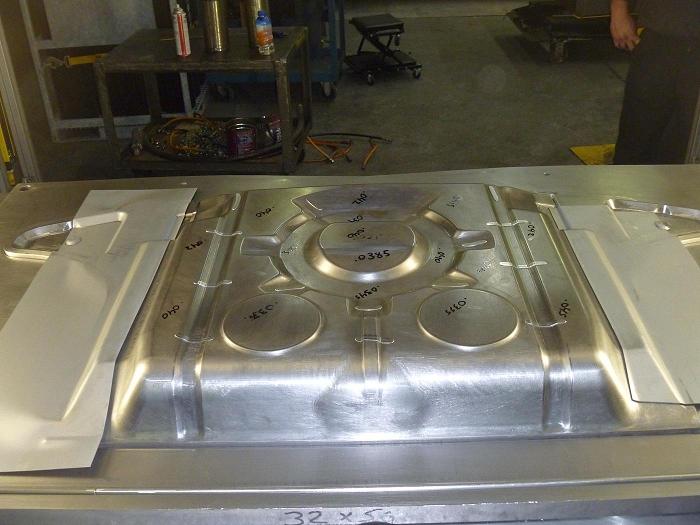

We are almost there! I think we will have a good wrinkle free stamp by the end of the week. There is still work to be done on the laser trimmer and then the edges to be folded up.
Here is a picture of what we have to do to check all the tight spots for clearance.
We first stamp two small sections of sheet metal where we know there is no tight spots. Then we place small pieces of lead(solder strips) on the die in several spots. Shut the press with full 500 tonnes and then measure the thickness of each piece of lead to determine where more polishing needs to be done.
You can see where the tight spots are written in marker. It varies from .029-.049 I know that it doesn't seem like much, but .20 will keep the die from shutting fully and thus cause our wrinkling.
