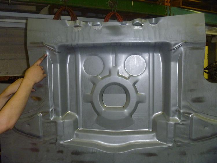

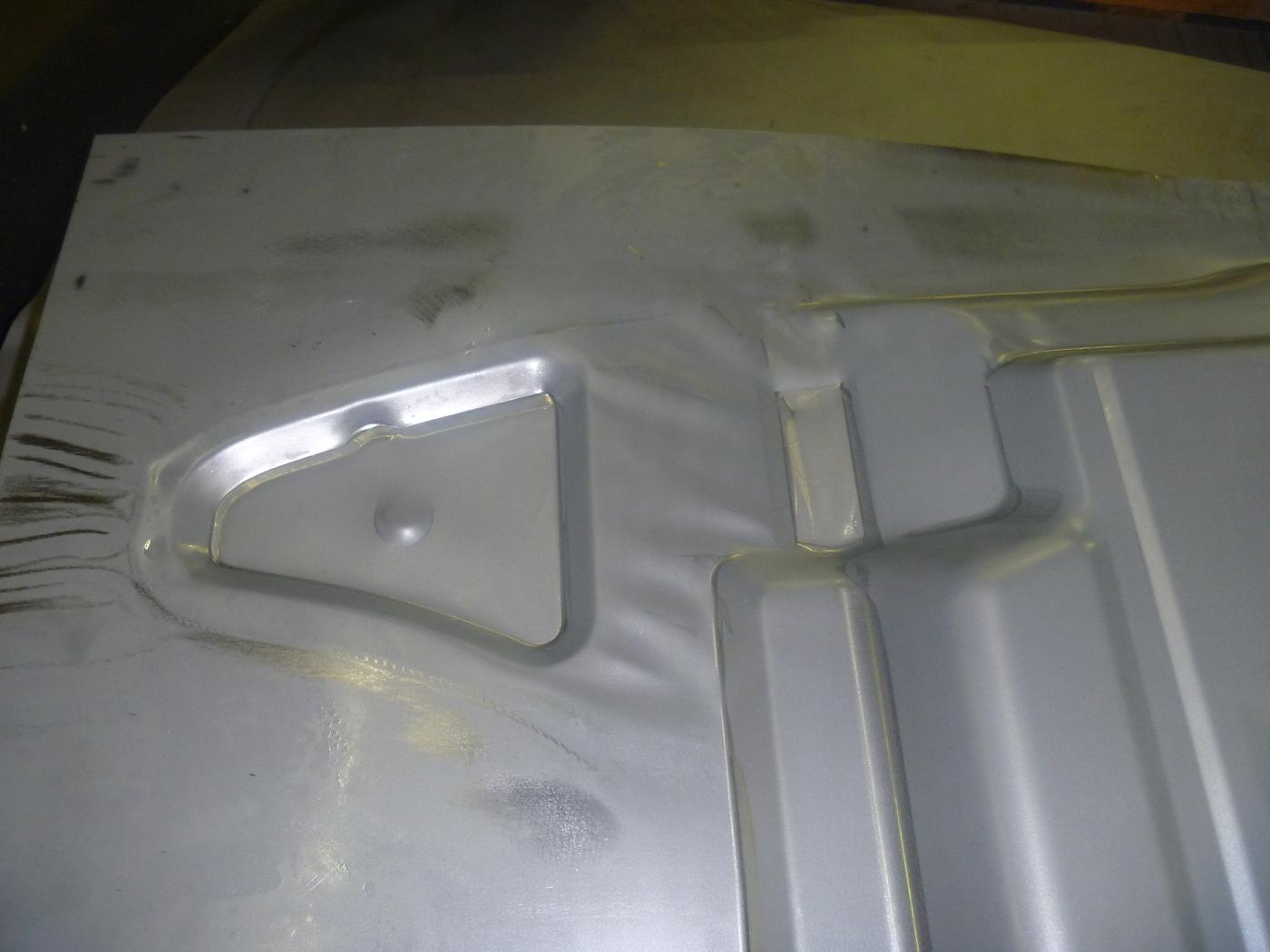

Alright, I spoke a while back that I was going to start producing the Front trunk pan. I already have all the steel and all the CAD work done, so all I need to do is prep the steel and start cutting!
I wanted to start a thread here for all to follow the progress and also to get a better idea of what goes on at Restoration Design. I am the one in charge of designing and making all the dies here for the 914, 911, 912, and 356's. I have only made two small dies( pedal cluster support, seat mount bracket) for the 914 so far so I wanted to make something else that was in need.
I started with an NOS full floor pan. The one that runs from the firewall all the way to the front trunk pan. Brought that away to get a digital scan and then from there I designed the male and female halves of the die.

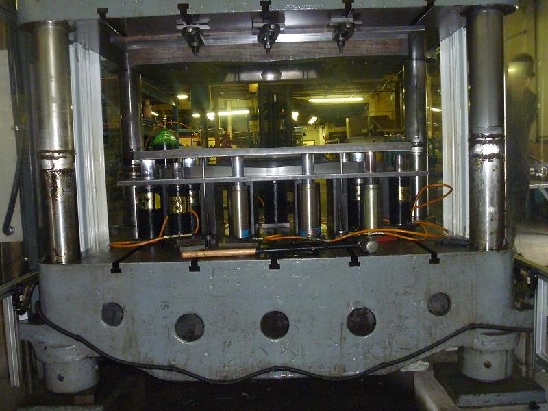

peteyd   I dont have a press that can handle a die that lar...   Sep 27 2011, 03:05 PM

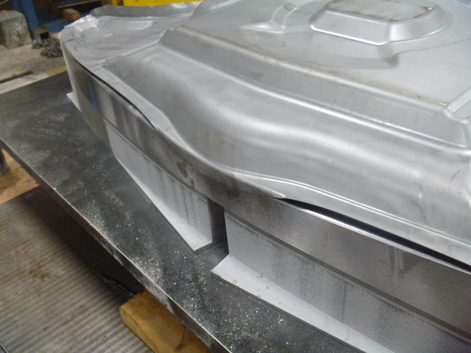

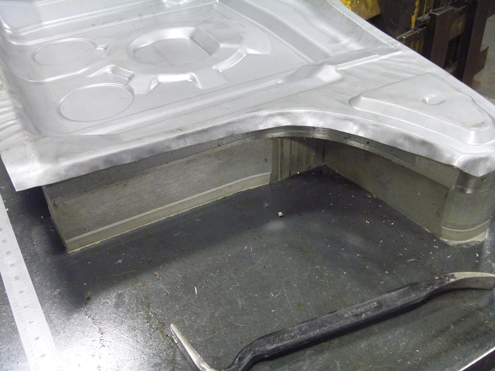

peteyd   Little update... I have taken the die off, obviou...   Nov 18 2011, 02:30 PM

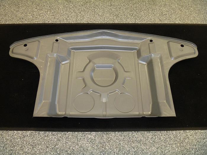

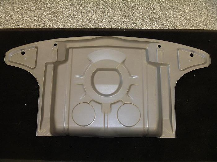

peteyd   After a long hiatus, I have gotten back to work on...   Mar 16 2012, 08:13 AM
