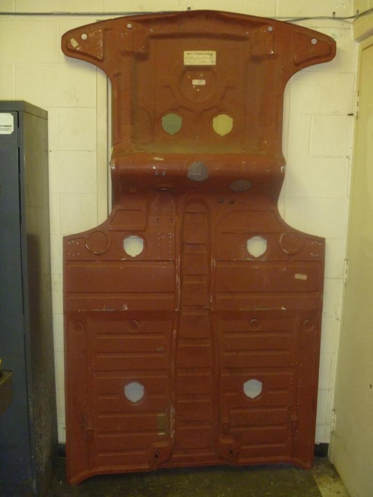

Alright, I spoke a while back that I was going to start producing the Front trunk pan. I already have all the steel and all the CAD work done, so all I need to do is prep the steel and start cutting!
I wanted to start a thread here for all to follow the progress and also to get a better idea of what goes on at Restoration Design. I am the one in charge of designing and making all the dies here for the 914, 911, 912, and 356's. I have only made two small dies( pedal cluster support, seat mount bracket) for the 914 so far so I wanted to make something else that was in need.
I started with an NOS full floor pan. The one that runs from the firewall all the way to the front trunk pan. Brought that away to get a digital scan and then from there I designed the male and female halves of the die.

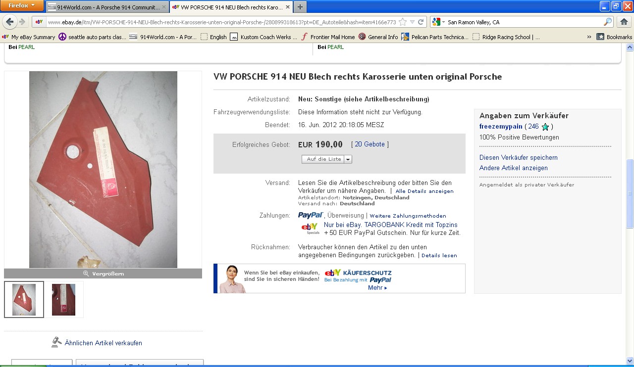

lrm914   Awesome! I always wondered what the large hol...   Sep 27 2011, 01:43 PM
SirAndy   Any idea what they are for? Best guess would be fo...   Sep 27 2011, 01:47 PM

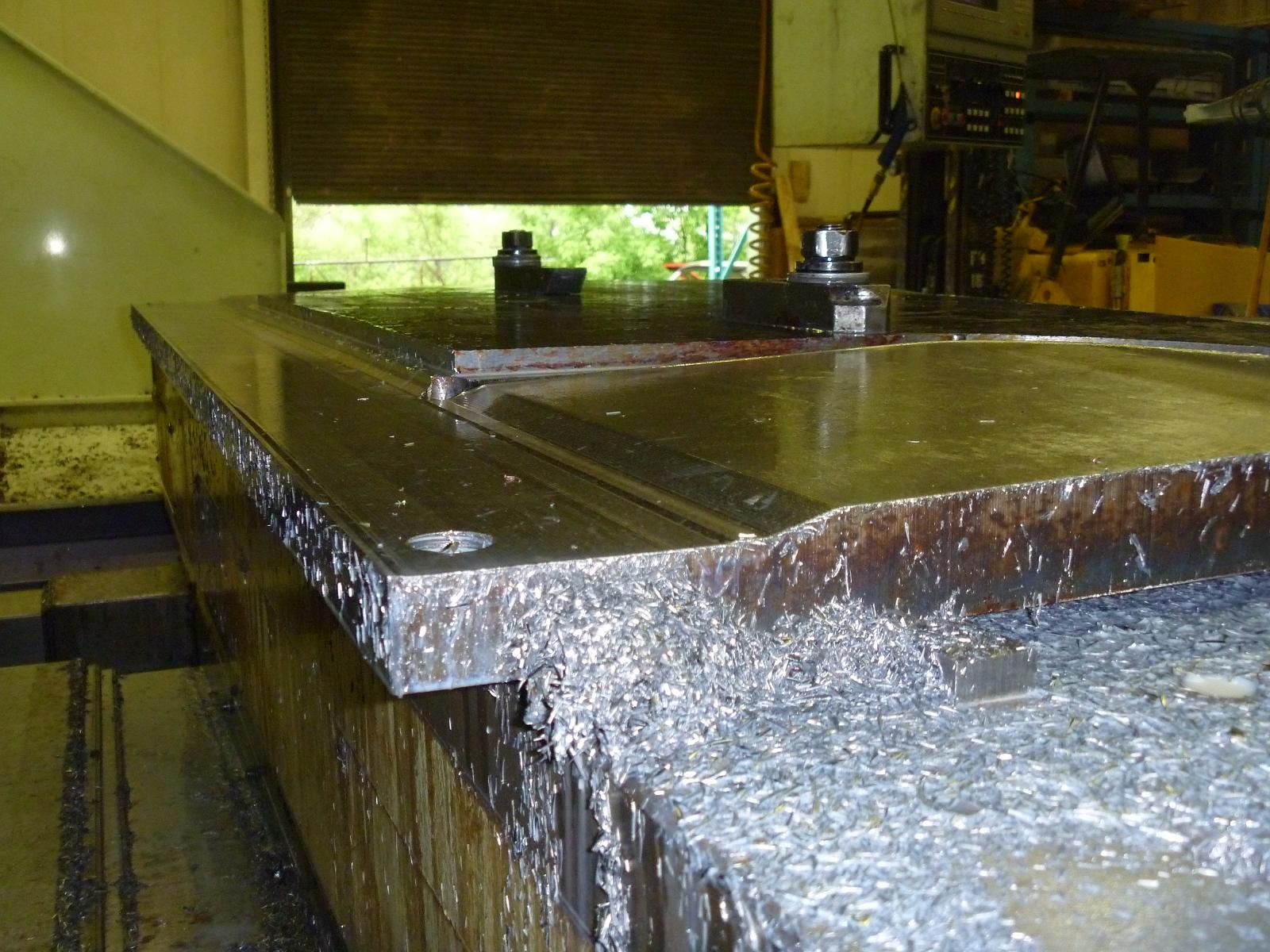

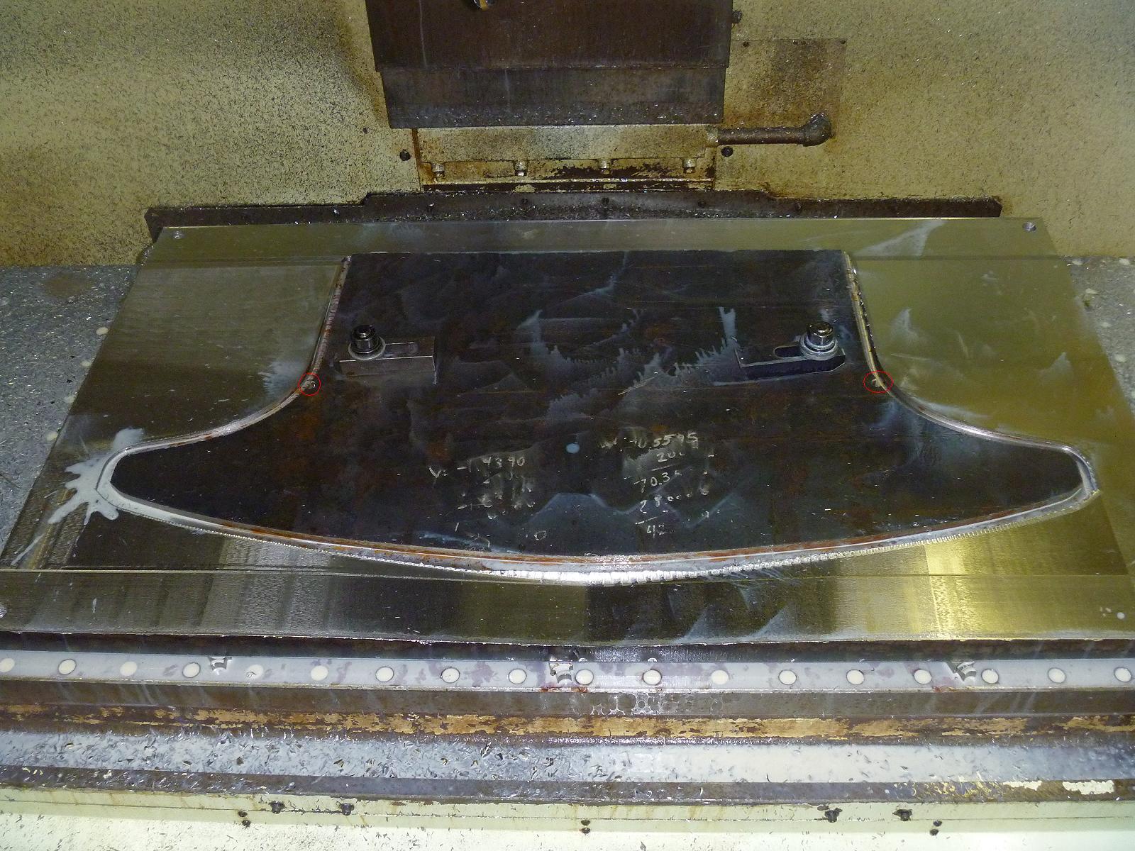

peteyd   Did some prep work on the blocks of steal so I can...   Sep 28 2011, 10:28 AM
peteyd   Now I can move them onto the mill and drill and po...   Sep 28 2011, 10:29 AM
zymurgist   Wow, how much does that thing weigh?   Sep 28 2011, 11:18 AM
peteyd   Wow, how much does that thing weigh? The larger...   Sep 28 2011, 01:14 PM

peteyd   Loading the steal... I have to clean up an ed...   Sep 30 2011, 10:39 AM

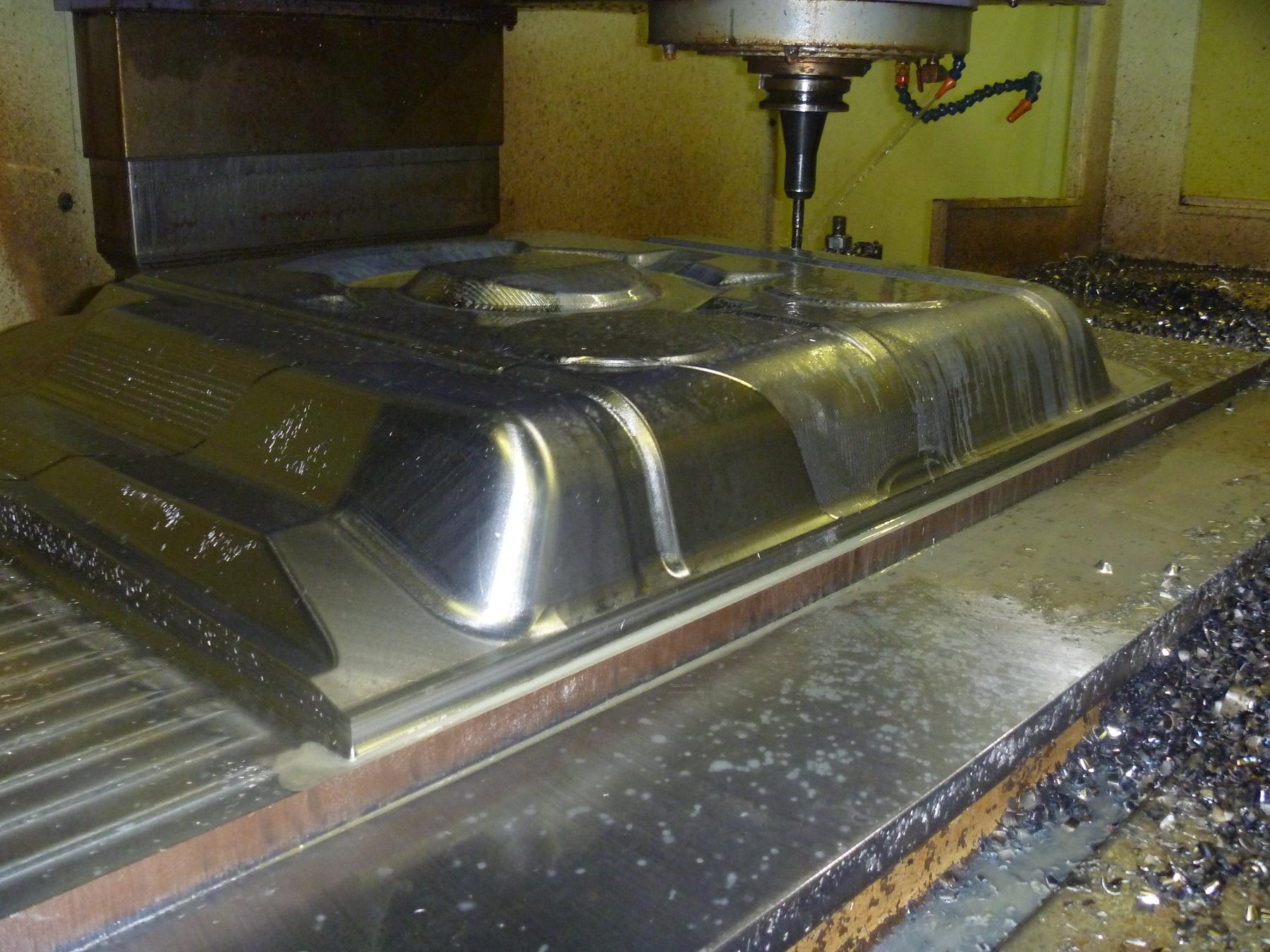

peteyd   Got some work done yesterday, and set the steel up...   Oct 6 2011, 01:31 PM

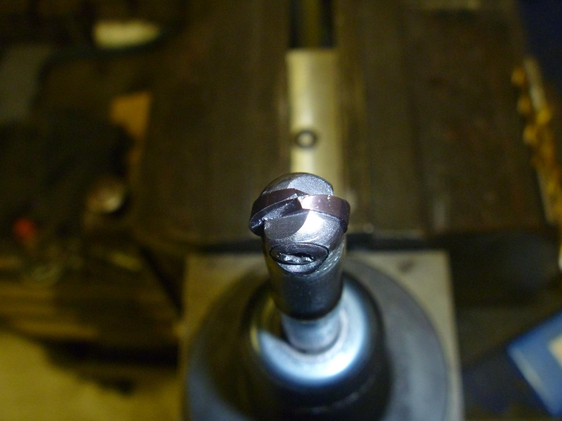

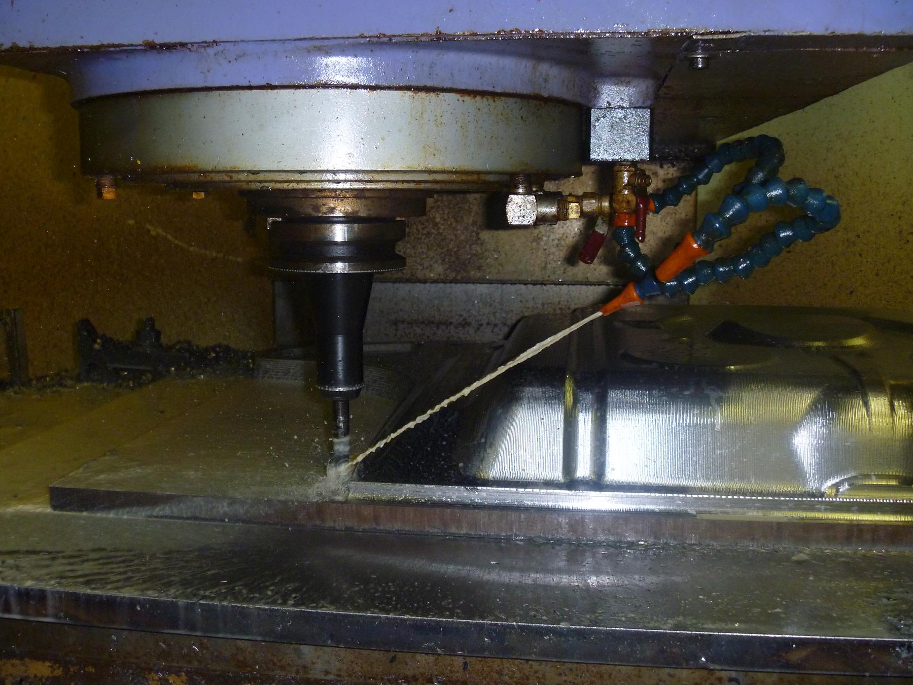

peteyd   OK, came back to work later on. There was a massiv...   Oct 6 2011, 08:24 PM

peteyd   :Qarl: The 1" ballnose finished with no gli...   Oct 7 2011, 08:44 AM

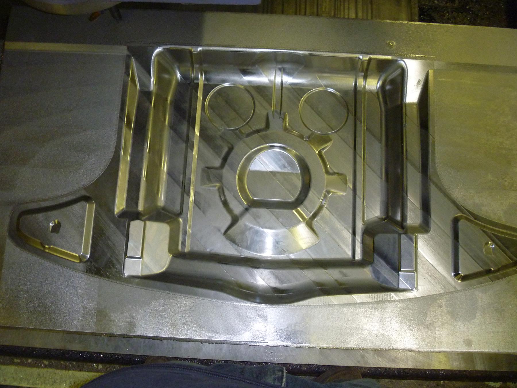

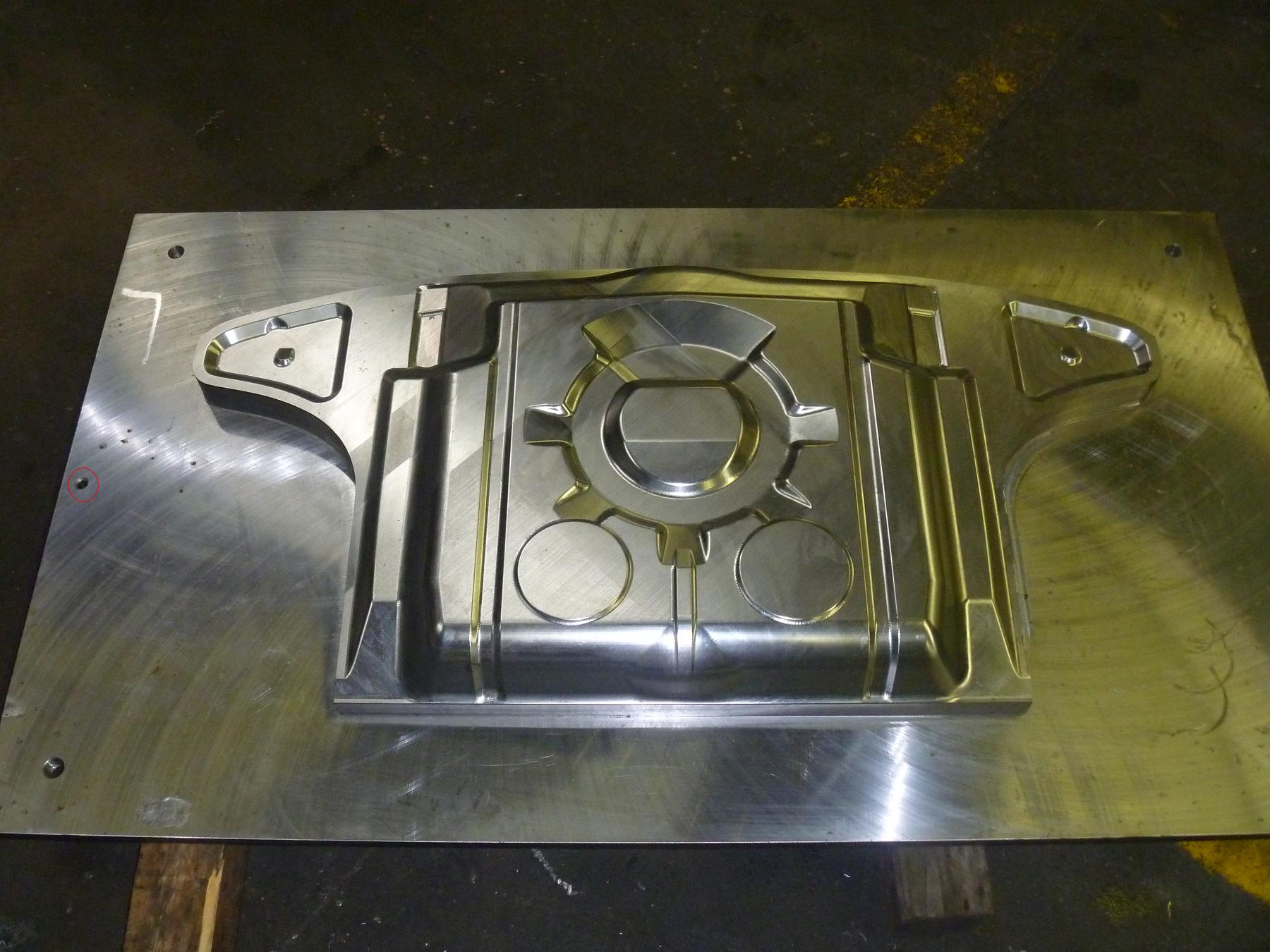

peteyd   Well its been a little while since I had an update...   Nov 4 2011, 10:57 AM
zymurgist   Why does the die have to be polished? Just curiou...   Nov 4 2011, 11:26 AM
peteyd   Why does the die have to be polished? Just curio...   Nov 4 2011, 01:14 PM
zymurgist   Why does the die have to be polished? Just curi...   Nov 4 2011, 01:45 PM
peteyd   [quote name='peteyd' post='1566461' date='Nov 4 2...   Nov 4 2011, 05:54 PM

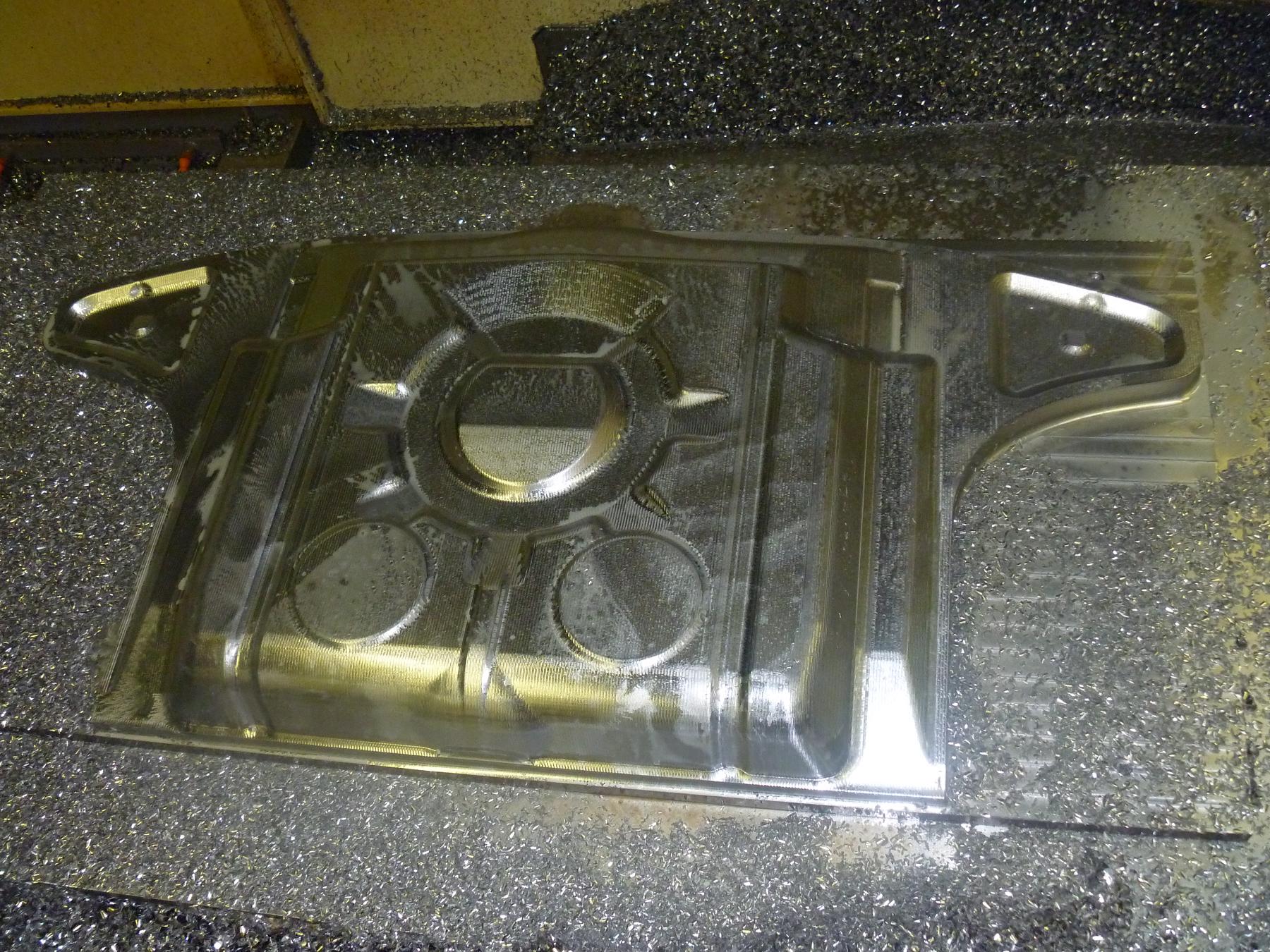

peteyd   Little update... I have taken the die off, obviou...   Nov 18 2011, 02:30 PM

a914622   I ran the 1.5 dia at 3000rpm .06 deep at 350 ipm. ...   Nov 18 2011, 11:45 PM

peteyd   After a long hiatus, I have gotten back to work on...   Mar 16 2012, 08:13 AM
