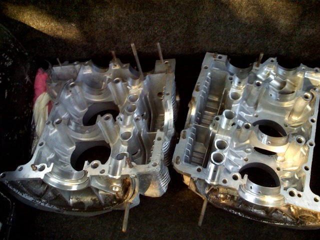

OK got the case back after cleaning and tapping the oil galleys.
more photos to come...
