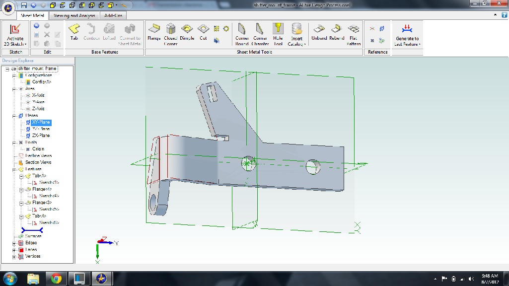

Here is a screen shot of the new cable shift mount for the subaru 5mt that I'm almost done with. 1/4" and three bolts holding it to the housing... goodbye flex and slopy feel, hello crisp and solid shifting (IMG:style_emoticons/default/evilgrin.gif)

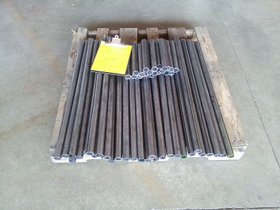

Picture of the steel as delivered, everything is going well with the production run, I will get some more pictures at the end
