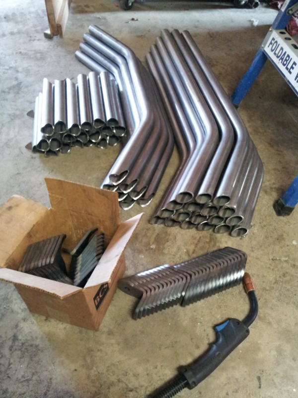

Half way through the production run pleased to report everything is going great! Here is a before pic from this morning (IMG:style_emoticons/default/piratenanner.gif)

Well right at about 5ish i ran out of wire, didn't have a spare spool on hand but the good news is i got through enogh of the cradles to fill the pre-orders!
Ill update the member vendor thread with more specific info.
here is a partial after pic (IMG:style_emoticons/default/biggrin.gif)

Looking good, you make me want to redo mine. (IMG:style_emoticons/default/beerchug.gif)

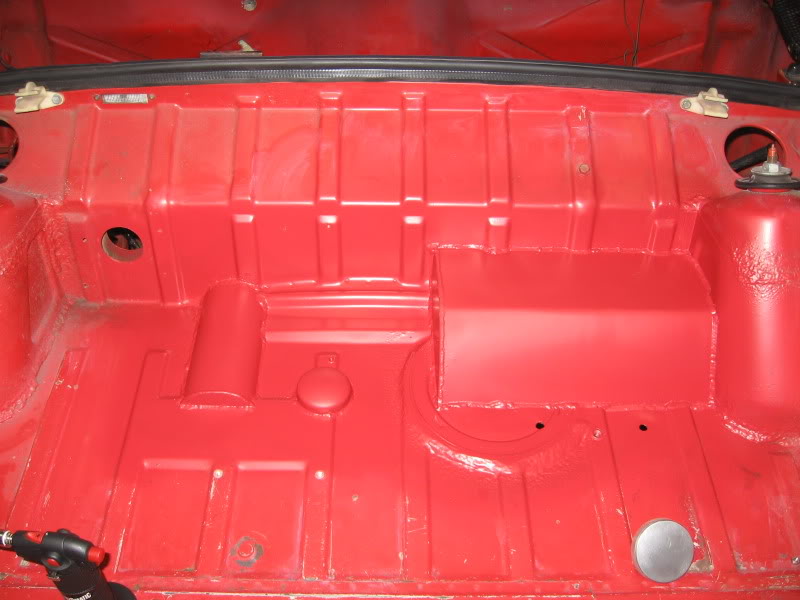

some of ian's parts in action (IMG:style_emoticons/default/smile.gif)
** note - this is a turbo install which requires partial trunk floor modification.
http://www.914world.com/bbs2/index.php?sho...78501&hl=im painting&st=200
(IMG:http://www.914world.com/bbs2/uploads/post-8018-1347125444.jpg)
below is DBCooper's trunk mod.
(IMG:http://www.914world.com/bbs2/uploads/post-12367-1337275297.jpg)

One thing to add, the Subaru transmission does require a bit of extra clearance as well not just the turbo.
Its pretty cool to see it in a another 914!
