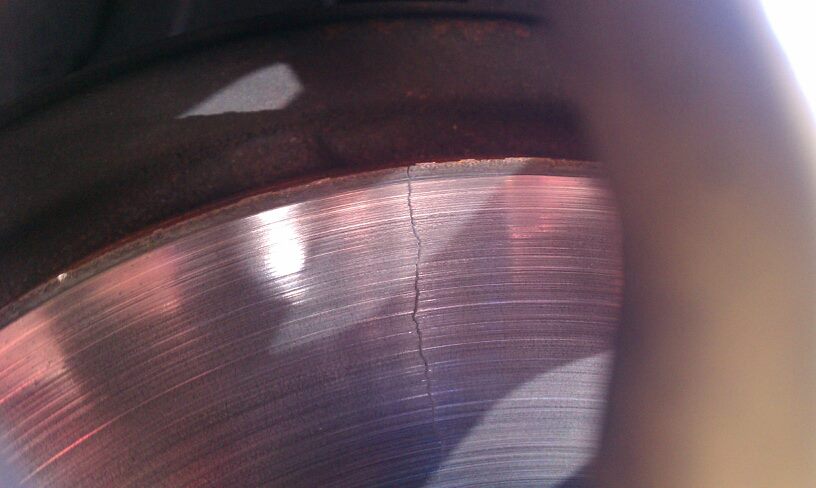

![]() [QUOTE] It's kinda like a normal lathe, but the tool is double sided, so it cuts on both sides of the rotor at the same time. You can do them by pinch turning them on a standard lathe as well. http://www.youtube.com/watch?v=TCWiVIu27h4 [QUOTE/] Yep, I buddy use to have one & a drum one as well.. Came in handy.. [QUOTE] Can't answer that, but sometimes it's just cheaper and easier to buy new rotors. Think 2 rotors, and a set of ceramic pads for the jeep was ~65.00. Would have been the same price to get the rotors turned, and I would have to run back and forth and wait for them.[QUOTE/] Yep, most of the time they are cracked now, so the extra labor.. On the Z06, we bought the rotors from O'Reilly's and since they had a life time warranty so something like that, after about every 4 events they would crack and I would go exchange them for new one (IMG:style_emoticons/default/happy11.gif) Course tthat Z06 only had around 500PH at the lowst settings & 315/35/18s at each corner.. |
