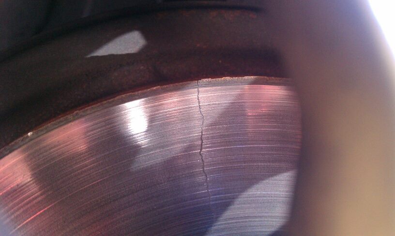

Yep, most of the time they are cracked now, so the extra labor..
On the Z06, we bought the rotors from O'Reilly's and since they had a life time warranty so something like that, after about every 4 events they would crack and I would go exchange them for new one happy11.gif Course tthat Z06 only had around 500PH at the lowst settings & 315/35/18s at each corner..
