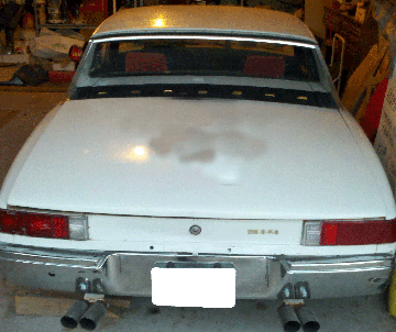

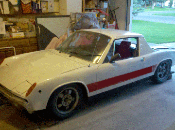

Hi All:
Been looking for a car to drive daily that get some mpgs. Found a nice RX-7 and a 944, then remembered a friend of mine has had a 914 for 20 years, garage kept the whole time. He takes it annually to a mechanic to see if it needs anything. Right now, won't start and they think it needs starter.
It is for sale. He asked me to "make offer". I don't know anything about these cars except for what I read here, so looking for a little help.
1972. Think it's original motor and F.I.. Said to run well, and I believe what they are telling me, but I would be buying it "as is" without hearing it run or driving it. They drove it about a tank of fuel's worth every summer for the last several years.
Obvious Problems:
Surface rust on back truck floor (think I could Por-15 it)
Rust bubbles on body, including under both door handles
The rear trunk hinge mounting tab is broken at the body. (Needs welded?)
Missing rubber pieces over bumpers (are there any decent used ones?)
Missing side marker lights
Repainted. Original color was orange. Repaint is lousy
Top of roof not smooth. (This bad paint or maybe a repro roof?)
Seats re-done in red velour (yuk!)
Needs starter or ?
Car shows 85k miles but ODO has been broken for 20 years.
Basically a 40 year old car that's never been restored.
What do you think it's worth?
These things sure look fun!
Thanks!
Rand

The most important factor is how bad the rust is under the battery tray, down the frame rail toward the firewall, along the rear corner of the floor on passenger side, around the suspension console, etc. You'll hear it called "the hell hole." That one area will determine the car's value more than the other items you listed combined.

The standard roof was not painted. It looks like fiberglass. Rough, pebbly surface and they were flat black. I guess it was the 912 that had a roof that matched the car, but it did not come off.

Rust will be much worse than it looks. $1500

while they do get good mpg's, not many would consider them daily drivers. that said, if you're comfortable depending on a 40 year old car for such duties, we bow down before you!
bumper tops can be found at local wrecking yards from time to time and i'm sure there will be some for sale in the classifieds here too. not really urgent, more cosmetic though. those in great condition can be quite expensive.
tops originally had the textured finish. sounds like the one you're looking at was just painted over.
all in all, not a bad sounding car (check for the rust issues rand mentioned). if you're mechanically inclined or can pay somebody to fix all the little things that need attention on an old car, go for it!
if there's not too much rust, see if they'll take a grand? someone else here recently got a decent one for $750! i recall paying $1000 for my '71 1.7 w/ very little rust (ca car) about 15 years ago. if it were running w/ little to no rust, it might be worth $2000-3000 or more.

That car could definitely be a DD, but you will need to go through every bit of it to do so. I wouldn't buy it without inspecting it with a magnifying glass for rust. These have been known to rust in half from time to time...

I did offer a grand last night, and they were thinking $2k. I have to push the car out to get a better look at rust, but honestly, I am not looking to do a concours resto, but to have a fun driver.
I do work on all my own junk (mostly) and am not afraid of keeping it running. It appears to be pretty simple and easy to work on if I can figure out how to get to the dang engine.
My commute is a no-traffic, ten-minute drive at 75 mph or a back road with even less traffic that takes 15 minutes. The plan was 4 studded tires and lots of drifting. (IMG:style_emoticons/default/driving.gif)
Such a cool car. Still blown away that it is FI, 4-wheel disks, and a five-speed in 1972! Makes my 70 Challenger seem archaic.

If you have some mechanical/welding skills, and aren't afraid to get your hands dirty, buy the 914. Offer $1500 less what it might cost to get it started. The car is a blast to drive and despite what some might say it CAN be made into a reliable daily driver. It just won't be right away. (See first sentence of this post) It might take a bit of work. If you haven't guessed by now RUST is the major issue. When I bought my first 914 I had a welder spend 6 hours cutting out and replacing rusted metal. Try to find someone near you that knows a little about the car and can help you with a pre-purchase inspection. Good luck. If you decide to buy the car there is a huge amount of advice and expertise on this web sight.

I would say, with what you have described, if you put a starter in and it runs, $1,500 would be the price. If the starter is not the problem, $1,000. Good luck.
